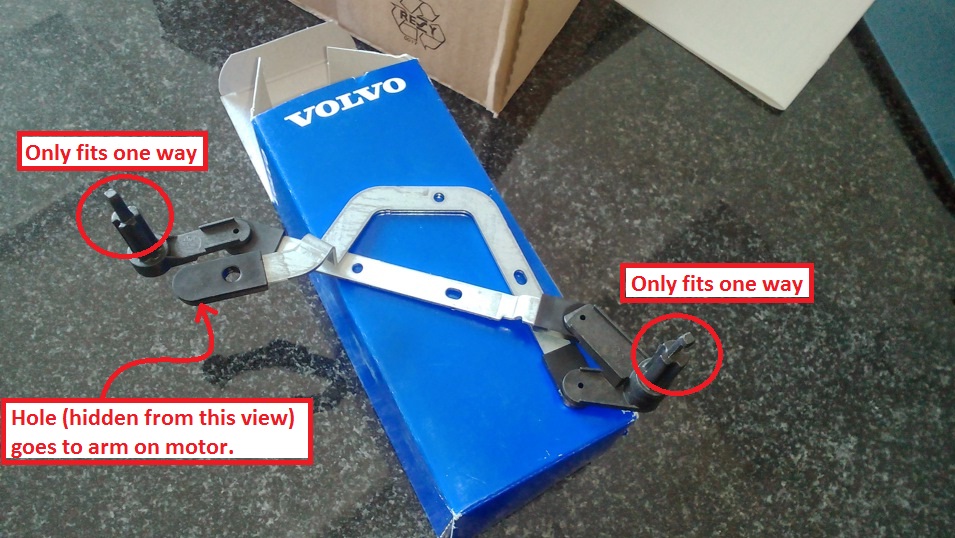

Received the Linkage for Temp Control today.
Spent 1h fooling around, only to find out you can do this in 10 minutes!
Here are the tricks:
1. Move the seat all the way rearward.

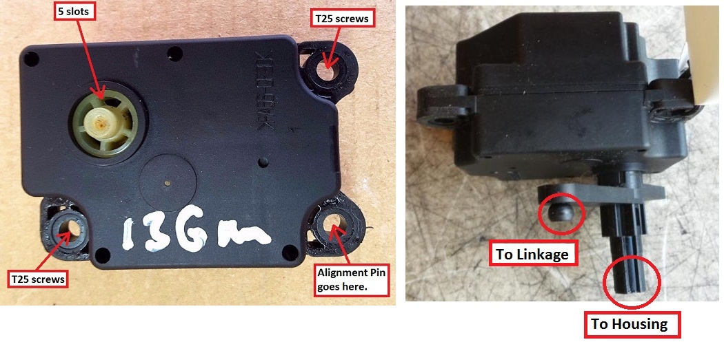

Remove the two (2) T25 screws holding the small electrical motor.
- Gently pry the plastic arm of the motor.
2. Look carefully at the new part. The two (2) plastic pins can only fit one way into the flap door recess holes.
- Study the plastic pins carefully and the slots the flap door recess holes.
- When in doubt, look at factory setup (photos in my DIY above).
- Now slide the linkage behind the 2 aluminum pipes (that feed the heater core).
- Align the plastic pins so they slide easily into the housing.
3. Now insert the plastic arm of the motor into the housing (only fits one way, check the housing slots to be sure).
- Connect the electric motor arm to the linkage. This is easier said than done!
The TRICK: use a small screwdriver and place it behind the link arm, EXACTLY where it goes into the little
beveled head on the electric motor, then gently pry the screwdriver to snap the linkage arm into the beveled head on the
electric motor. NOTE the shape of the beveled head on the electric motor.
4. Install the electrical motor slowly, there are 5 slots. Rotate the linkage a bit here and there to align the motor.
Once the motor is fully seated, install the two (2) T25 screws gently.
