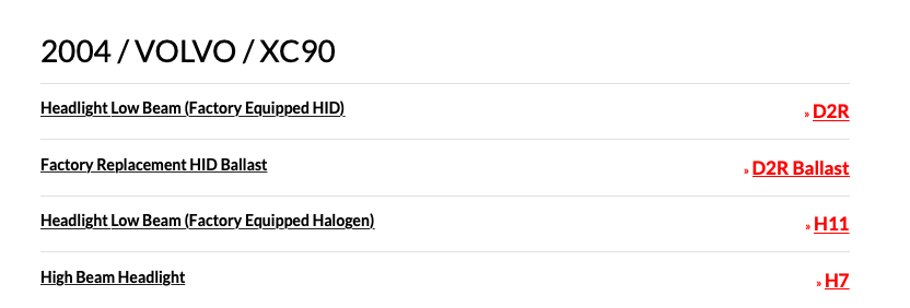

I would like some help, please on my HID lights. I have determined that both high and low beams are in one bulb. However, when I go to HID Nation it seems to have individual high and low beam bulbs. Yes, I do know some headlights do have two bulbs but not my XC90.
In addition, I have also come to realize that not all bulbs are created equal. I put brand new Philips bulbs in last year. I was not terribly impressed, especially as the wife's 07 Honda with halogens were far better with high beams. After whacking a mailbox in the last snowstorm I had to replace one headlamp. To my chagrin, the cheap, knockoff bulb with absolutely NO numbers/letters imprinted left the Philips in the dust.
Do any of you have a strong recommendation without having to pay Volvo's ridiculous price for those bulbs? Oh, here is the HID Nation attachment. For that matter, does anyone have any experience with HID NATION bulbs?

No suggestions, but you are looking for the DR2 bulb. Here is a link to ipd. There are a number of cross references listed in the link. You can search each of these to see how you can come out on price. I would recommend going with a known good brand from a known good internet parts supplier like IPD, FCP Euro, Pelican Parts, Autohausaz; have no idea about HID nation. Volvo's are sensitive in terms of lighting- always have been and still are. You are quite likely to get an error message if you use a no name bulb in a Volvo. That's a fact.

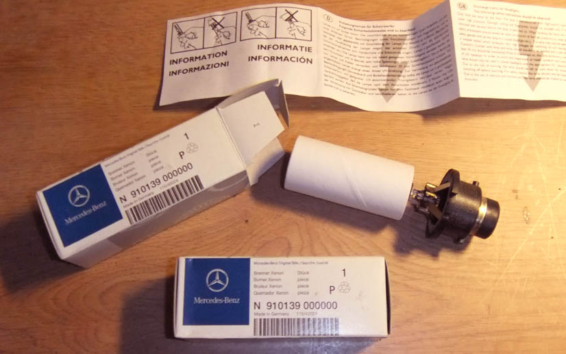

The OE bulbs are Phillips/Osram D2R 85126 4300k. For my sis' XC90 i found a pair of these boxed for Mercedes Benz OE at around $75/pair on Amazon marketplace. Which was cheaper than the Phillips 85126 bulbs (in a Phillips branded box) by about $40, and cheaper than Phillips bulbs in a Volvo box by some ridiculous amount.

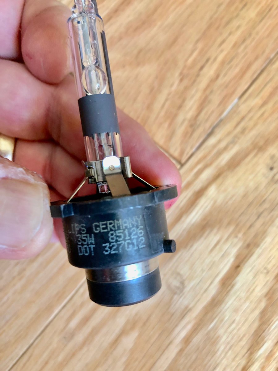

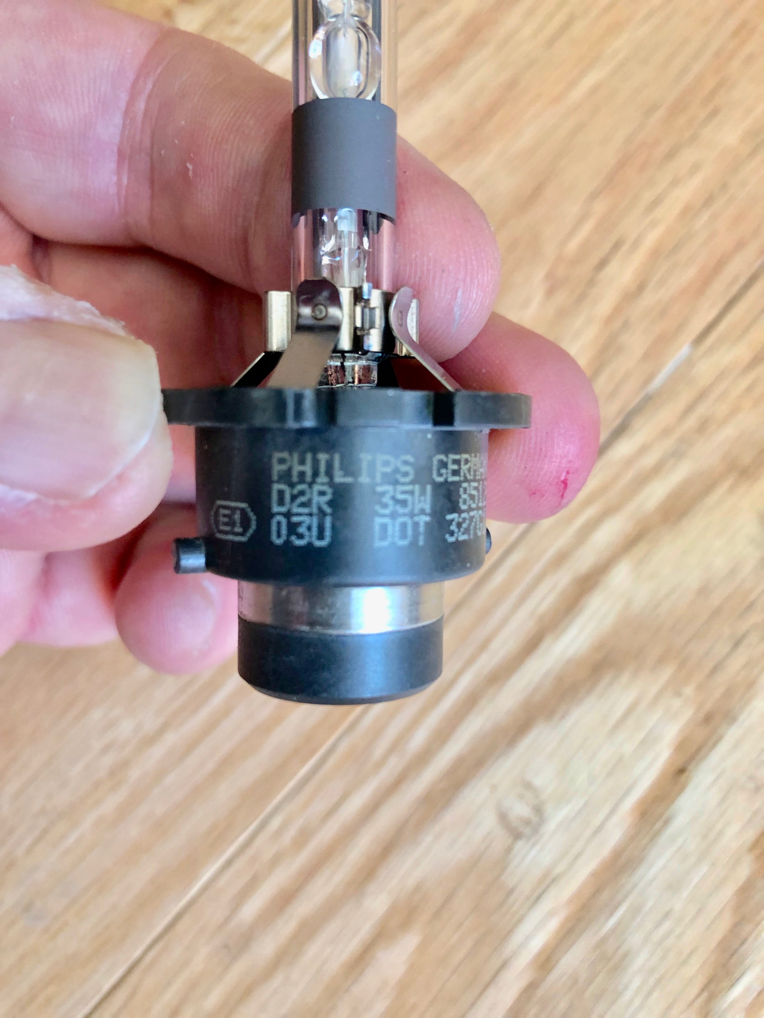

ImageImageSir, Phillips/Osram (and I will attach a picture) were the ones I bought from Autozone that turned out to be a disappointment. Yes, it could be a different bulb I suppose. Let Mr. Techno Impaired see if I can't attach a picture.

Post by mrbrian200 »
What was the problem with them?
These are the bulbs I put in sis' car about six months ago. They've been fine - no ballast errors or other problems. Note: there's the MB part number on the boxes (910139 - 000000). There are other MB bulb numbers with 1 or 2 at the end of the string of zeros which appear to be different bulbs - stick with '000000'.
Edit--I read your first post again- they lasted a few hundred hours (1 year) instead of a couple thousand hours (8-10 years for most people). I might have that problem with the MB boxed bulbs too - it hasn't been long enough to know. If the replacement bulbs don't last as long and are the same exact thing (Phillips 85126) regardless where you buy them - then under no circumstances it make sense to pay neidless markum prices just to get them delivered in a Volvo box.
