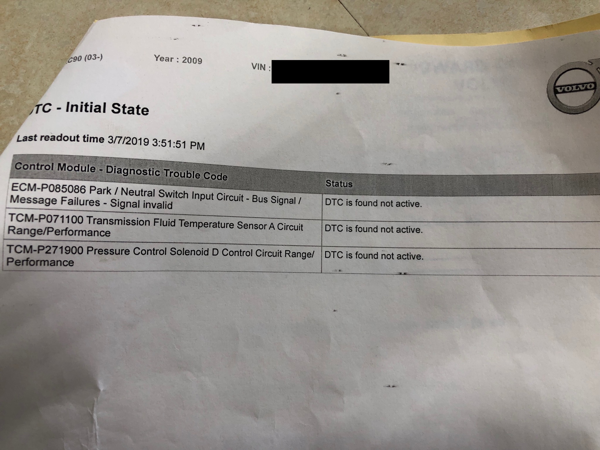

This is not adding up. First off the DTC format is what you would expect with the Volvo-Yamaha 4.4L V8 not the I6. You sure you got an inline 6 and not a V8? Does the VIN number on the printout match your VIN?
Second: All three of the DTCs are signal, sensor or solenoid codes. I'm not see anything that warrants a new transmission.
Volvo DTC ECM-P085086

Volvo DTC TCM-P071100

Volvo DTC TCM-P271900

Agreed those codes don’t warrant a new transmission. Also, they state non active so they could have been stored from a previous event. How can you tell this is for a v8 and not an I6?
- RickHaleParker
- Posts: 7205
- Joined: 25 May 2015, 14:30
- Location: Kansas
- Been thanked: 980 times
Good point on the non active. Clear the codes and see what comes back.Masscomguru wrote: 13 Mar 2019, 15:34 Also, they state non active so they could have been stored from a previous event. How can you tell this is for a v8 and not an I6?
I cannot pull any of the three DCTs up on a I6 but I can on a V8.

That's odd because both models share the same TF-80SC transmission. Sounds more like a Vida reference glitch.
