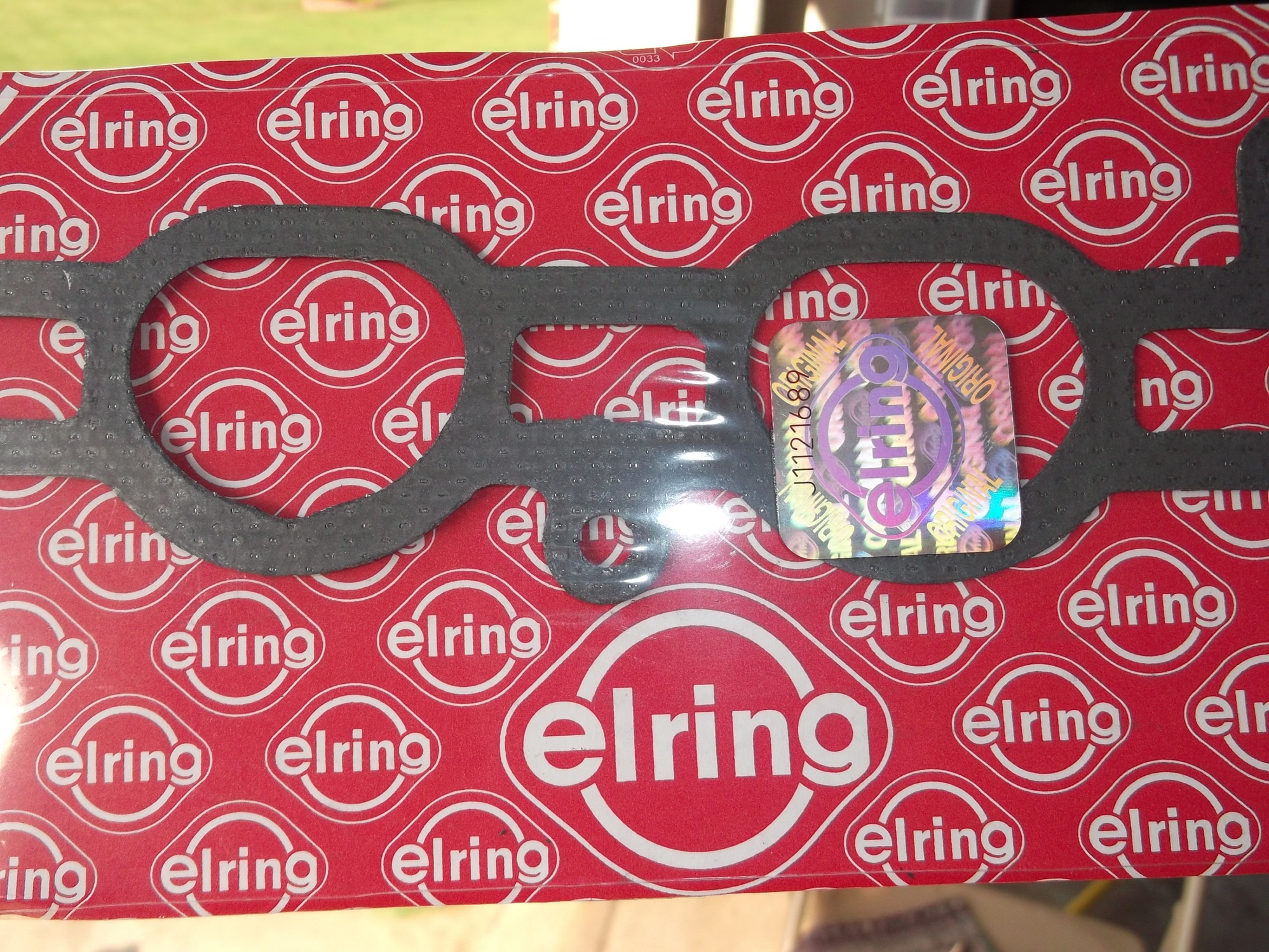

I now have a Service engine light and a No oil pressure, stop Engine message. I could have a vacuume line wrong, but I was pretty sure I got them right. I did get the gasket today and I am going after the PCV tank for a good cleaning...1st question is,.. Think my Actron OBD Scanner can read the codes? 2nd is Is the Computer on life support?. 3rd Question is, Since I can now see the intake gasket outer edges and it looks as new and clean as the rest of the engine, is it possible that a previous owner probably already had it serviced (PCV)...which I am doubting. The gasket looks brown in color like a brown paper bag and the new one is grey semimetalic. ( I know that doesnt mean anything significant)

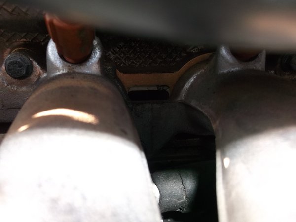

Hey boosted, Good morning. I would really like to talk to you. I decided to get the PCV canister off today and I havi it done this morning already. Not bad for the first time I ever worked on a volvo. 2 1/2 hours and I have pics of the valve stems in the intake ports. The PCV tank looks like its original and no oil in it other than dried residu, However, I found a clog in the connetion from the tank into the intake, and oil is seeping out of the fitting after i removed it, definitely oil in the intake where it connects. I pushed a hard gunky ball out of the stem and cleaned it out. ( out of focus pic, but you know what I mean. you can see the rounded clump in the picture. [email protected], if you can do a phone conversation and it you rather not, thats fine no harm. check the pic and say, yep, there's your smoke. I am just prolonging the turbo possibility for today.
Oil clog in fitting
Oil clog in fitting
oil clog.jpg (620.05 KiB) Viewed 2583 times
and It needs an oil change for sure. I am not running it over 3 mins at any point just yet.
No lights other than oil. I cleared the service light. Message center...Coolant and No oil pressure.....and the service SRS airbag. yada yada... not my biggest concern right now
