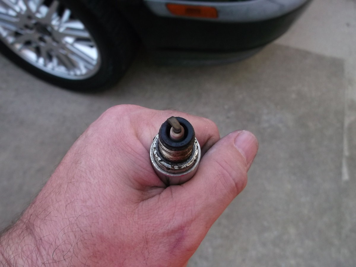

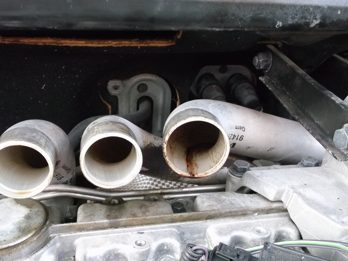

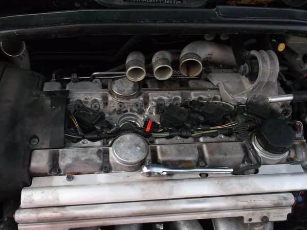

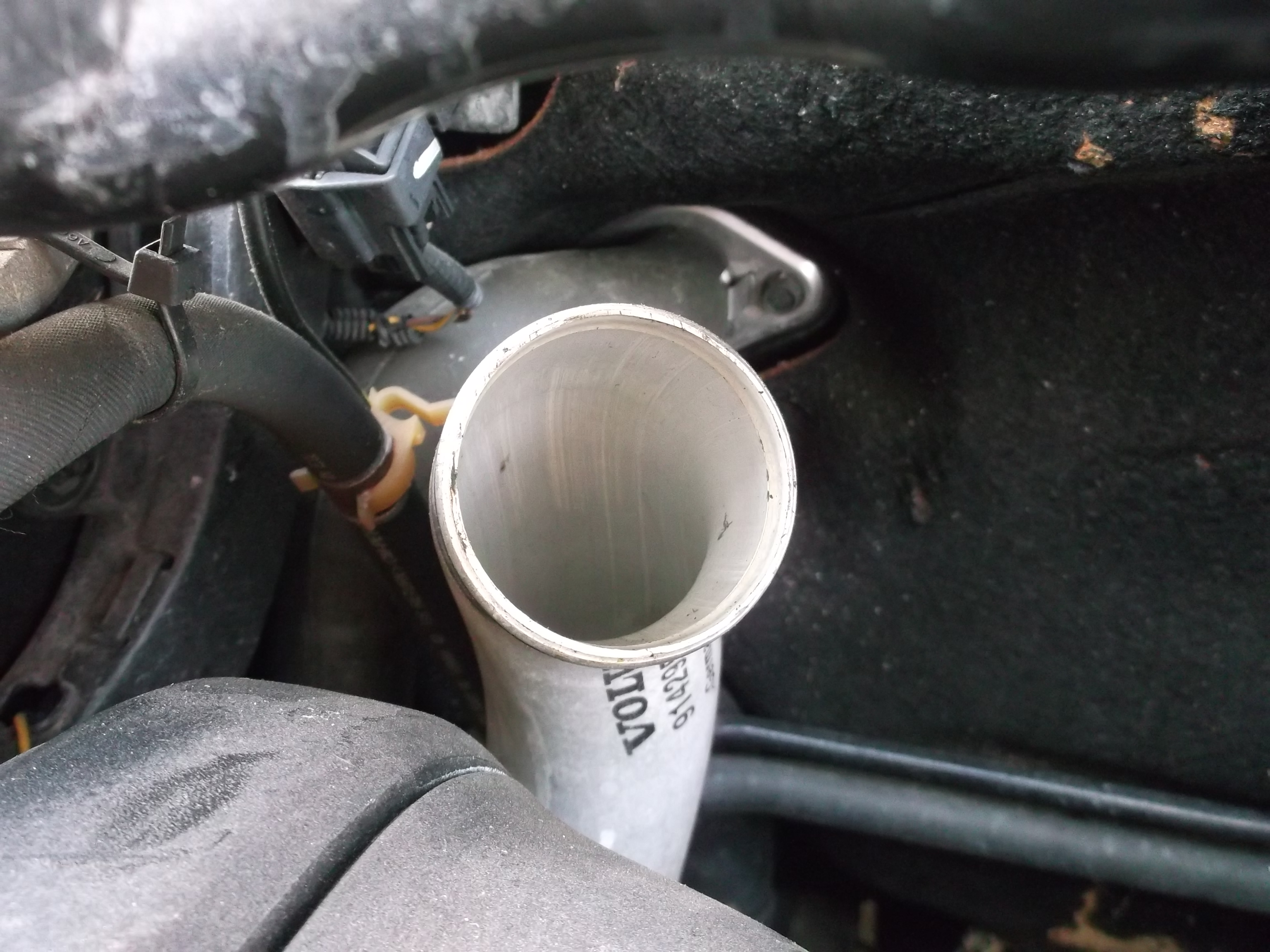

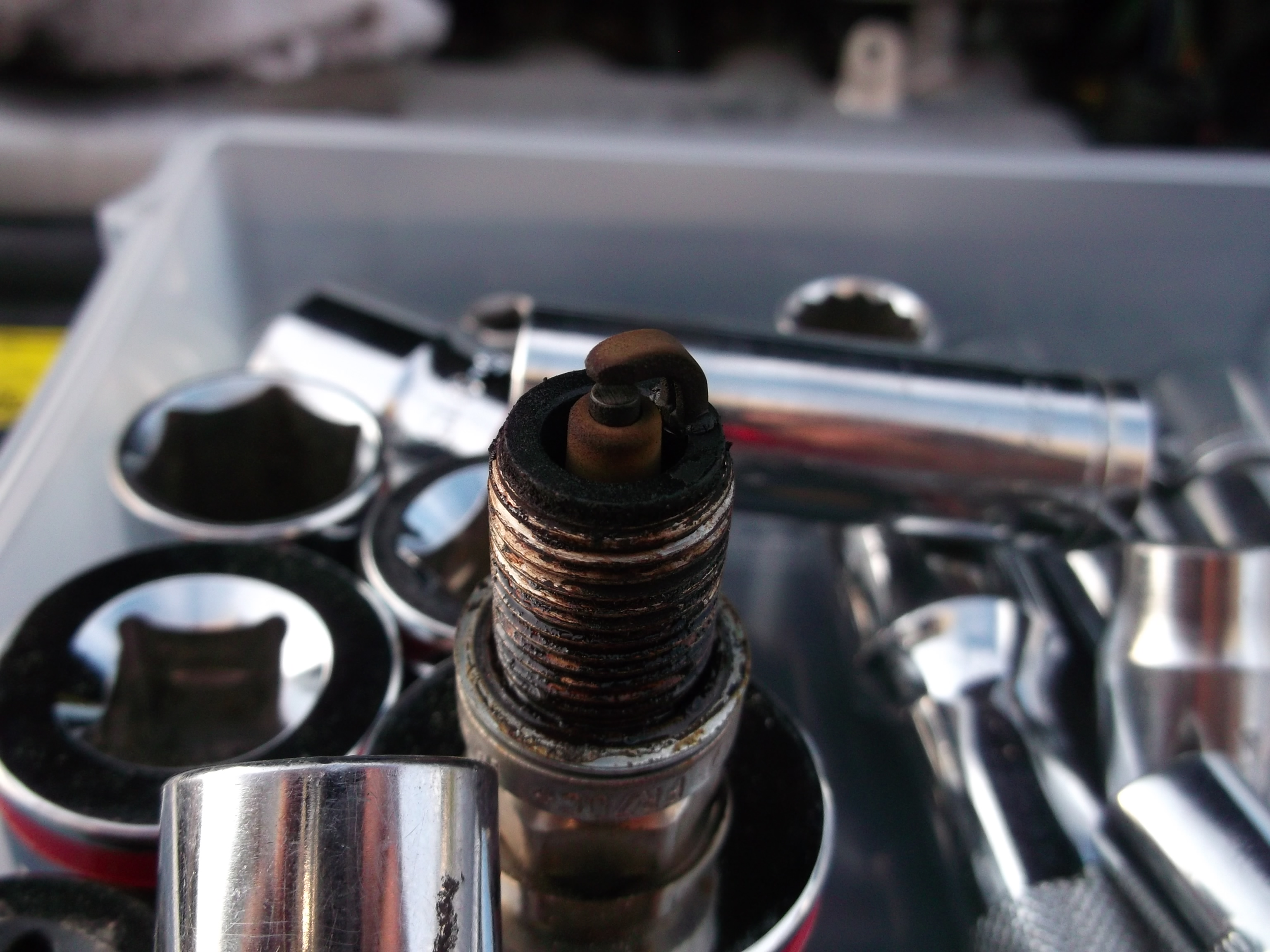

I had some time to get into the engine compartment tonight and look at some things I considered important. First off, I wanted to see the Spark plugs in her. I was very pleased with what i saw. If it lets me post the pics, I will. need replacing, yes, oil soaked, No. Normal for any car. Now for the turbo experts, Drivers side turbo has an oil line running out of the turbo. Pic also if allowed...Comments and suggestions please if you have time and opinion

Well the good news is that the oil you are seeing in that turbo pipe is on the "vacuum" or intake side of the second turbo. The oil is most likely from the PCV system, not the turbo. If you look at where the PCV pipe enters the plastic piping on top of the engine it will all make sense. So your turbos look good from that perspective. To be honest, the turbos rarely give trouble in these cars, but its always good to have confirmation that everything is OK right?
For spark plugs either go basic cheap copper, gapped to .028" or go Volvo OEM. No palladium, platiunum, splifir, vgap, surface dischare or any other malarky. Keep it simple and the car will like you for it.
Until you have the peformance issues figured out, I would advise throw a set of coppers in there for now. NGK have been very good to me on the road and track, but really put in whatever you are personally comfortable with. NGK, Champion, Bosch, Denso, Whatever! The gap is of .026" - .028" (.66 - .71mm) is CRUCIAL with these turbocharged cars. Make sure you gap them!
Did you manage to pull any OBD codes yet? How are the fuel trims looking? Also, if you group the old plugs together by OBD "bank", ie 1-3 (Bank1) and 4-6 (Bank2) do you notice any trends in their appearance? Ie does one bank seem to be running richer than the other? Even though its in inline 6, the T6 has two banks fuel banks, with 4 O2 sensors and two cat converters. It only has one turbo control solenoid (and subequently one wastegate actuator line split into two) for both turbos however. Go figure.
