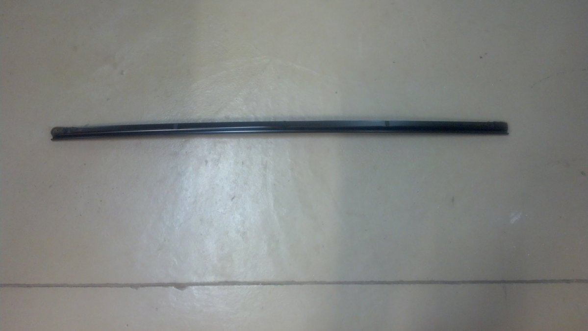

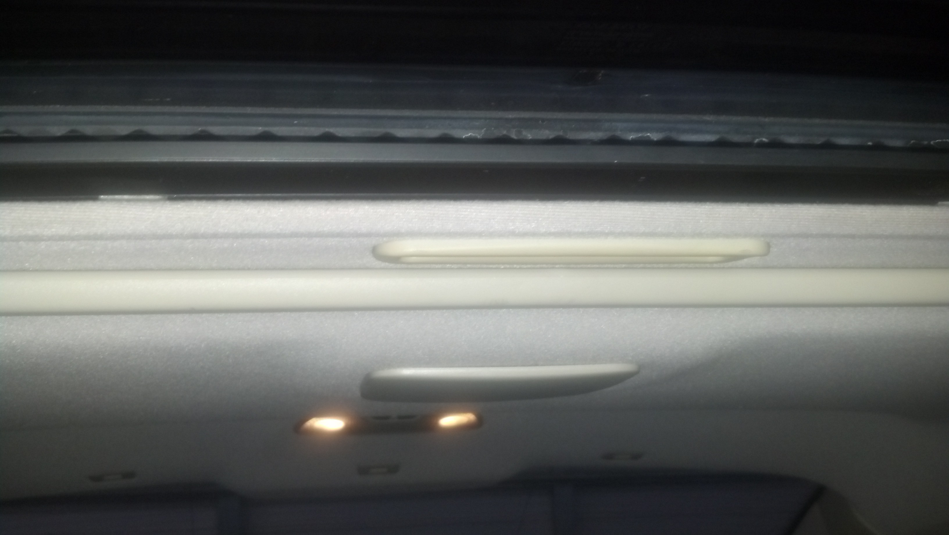

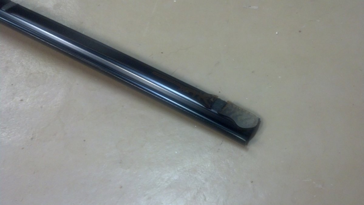

jkdjim wrote:how did you fix the clunky sunroof?
I am attaching photos of a metal "rod" that had been factory glued some place on the interior edge of the sunroof. The adhesive volvo used is inferior and did not last as long as the car has. When it delaminated it
caused a clunk when you would go over even the smallest bump. I do not know its structural purpose, but having it out has not resulted in any none working components....so far.
