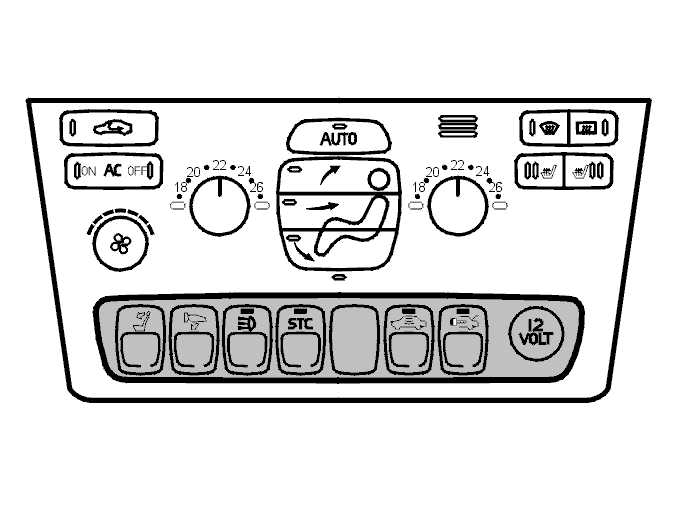

CCM-001B & CCM-001C refers to one of the switches on the bottom of the climate control panel.
1. Switch replaced with a switch with incorrect identity
2. Defective switch
3. Missing switch.
3. Two or more switches with the same ID.
5. Fault in the Car Configuration File

SuperHerman wrote: 14 Feb 2019, 11:27 For 2 - I think you should be able to test the switches with a VOM and take them apart to clean them.
Switch with IDs indicates they are network switches which send out commands rather then a physical electrical switch. Still they might be a hybrid, physical electrical switches where the CCM interprets them according to their ID.

In the diagram you posted, most of the switches are physical switches except the three potentiometer dial knobs (or related type) and then the zone buttons for the HVAC controls. These should also be physical switches at some point. Zone on or zone off.
Problem per OP appears to be his blend doors are mixed up - hence he is getting hot/cold out of the HVAC. So - let's ignore all the switches but the temperature controls and HVAC zone buttons because they don't really come into play.
