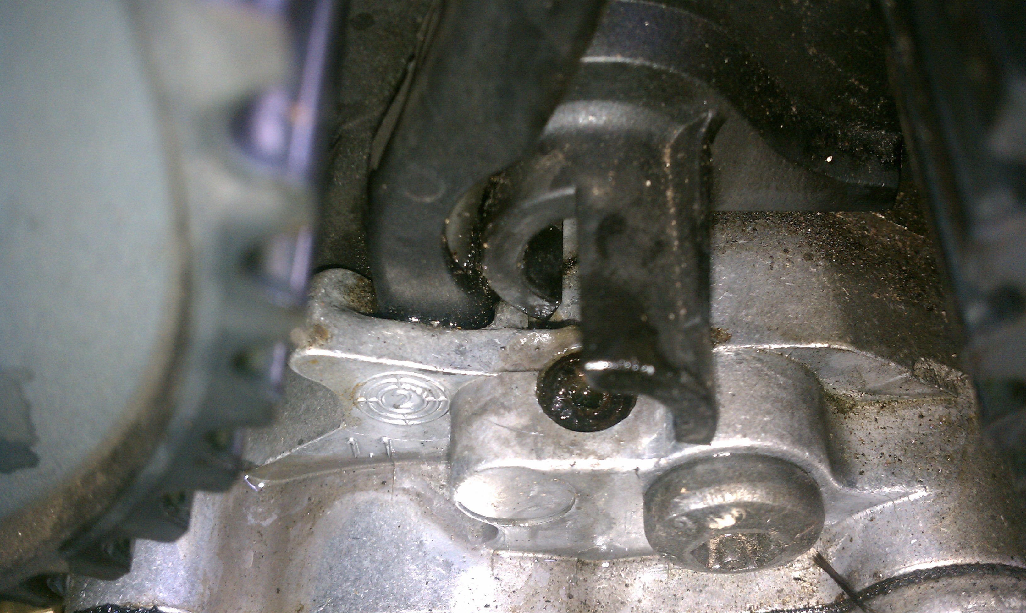

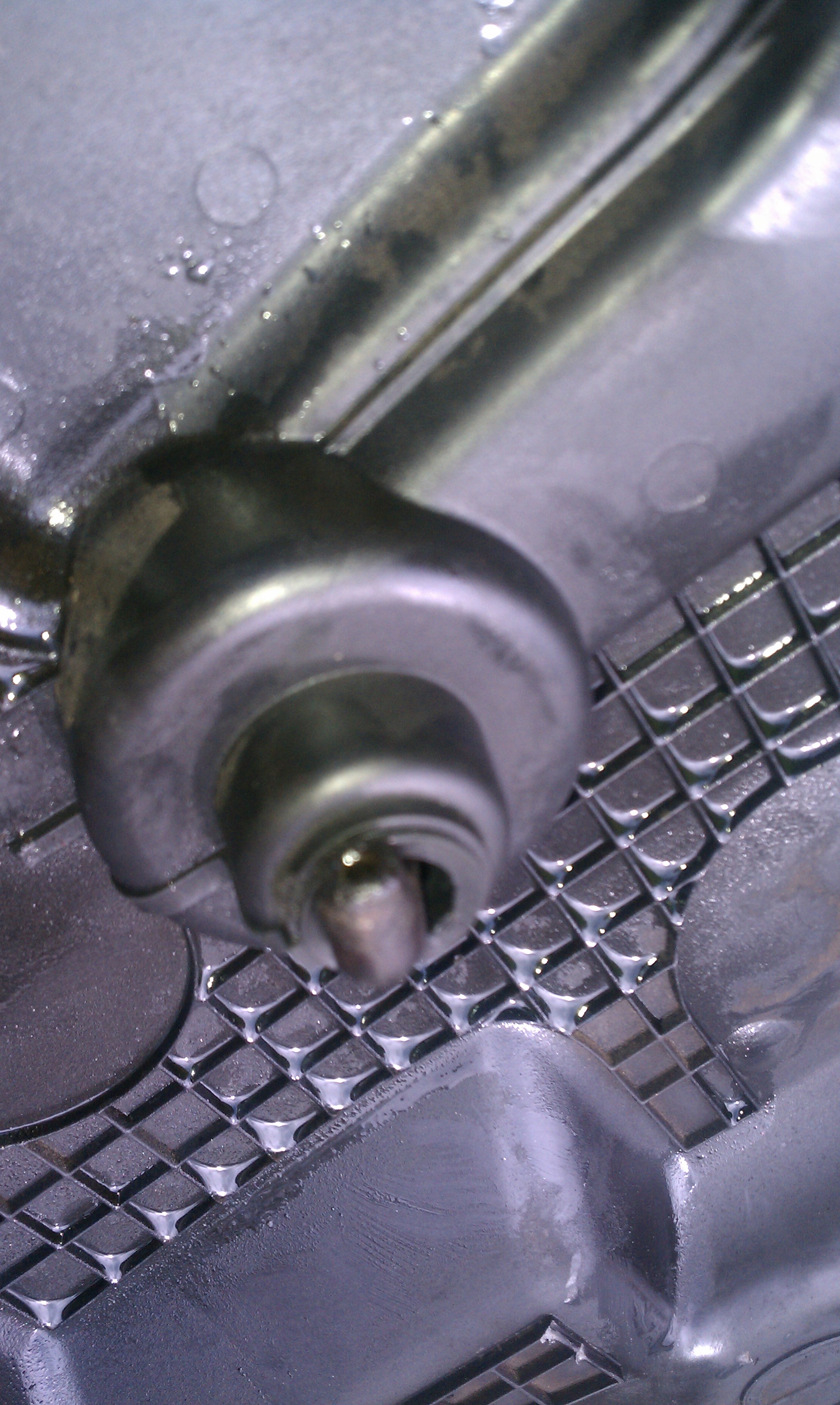

Here's two pictures of what I'm looking at. I was just tightening a piece down and heard a sizzling sound and saw the coolant leaking. Coolant literally flushed completely out from the small hole in the second picture. Oh and that piece is stuck in there of course.. Do I have to take the whole pump/thermostat apart or is this a piece that simply fits in?

That nipple is part of the thermostat housing. You should also replace the hose between the reservoir and thermostat housing.
A bit tough to do but not too bad. You need to move the PS and Coolant reservoirs out of the way for access. Good luck! Tim.

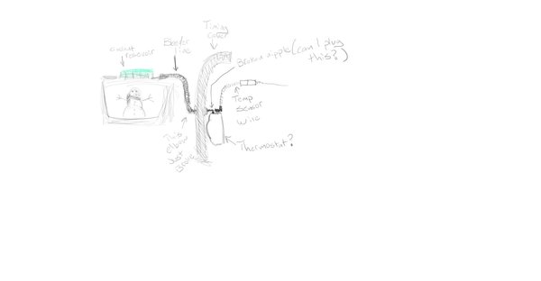

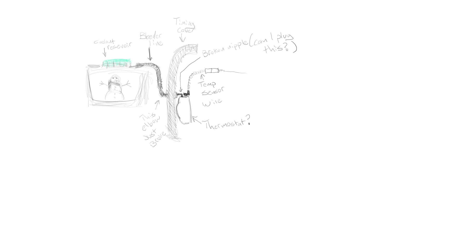

Here is a drawing I did of the basics. I can't get a clear picture. The "shield" behind the nipple (broken part) is actually just a dust shield it leads back to a smallllllllll .07 or so hole that then runs into the sensor whose wiring runs up from there. It's still fine.
This component is the thermostat then? If so, can I just plug this bleeder line? Or does it continuously flow? Its also really gunked up inside (the broken nipple).

Tshor - Can he just plug the orifice at the thermostat housing for a short term fix so he can drive the car? He won't be able to pick up parts until Monday. This is the soldier's Dad trying to help from about 1400 miles away.

plug it, cap the fitting on tank. Drive it and check coolant level a few times until all air has settled out.
The earlier 6's were a bear to get bled and ended up going to customers after repairs involving coolant drain n fill and the low coolant light would come on the next day.
