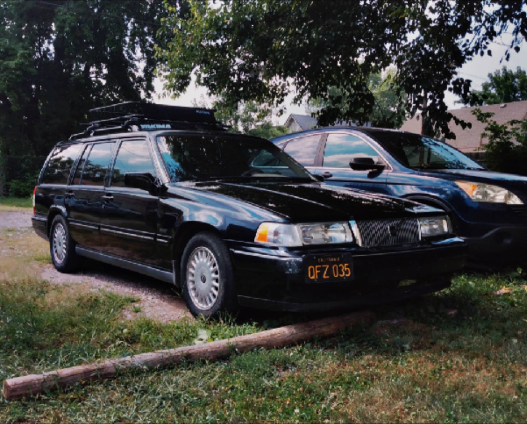

hi, i just got my beautiful wagon last week and i noticed that my rear left turn signal do not work when i apply brakes and none of them work when i have the head lights and ambers on, the right turn signal indicator on dash says on when headlights are on. light bulb fault light turns on when i use the turn signals, i feel in love with the car and any help would be greatly appreciated~ Jake
