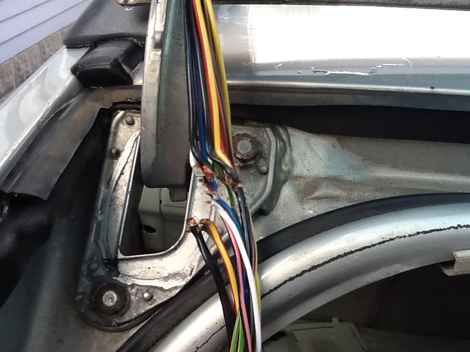

The wiring through the rear hatch can definitely mess up your rear lights. Make sure you are using the correct bulbs, nicely laid out in the manuals.

I'm back after this tail light demon. here's the pertinent info. fuses good. I've replaced the flasher module. I've looked at the tailgate harness and it looks pristine. I chased it for about ten inches back into the headliner. The brake lights seem to be immune to whatever is wrong; they work, as does the license plate.
