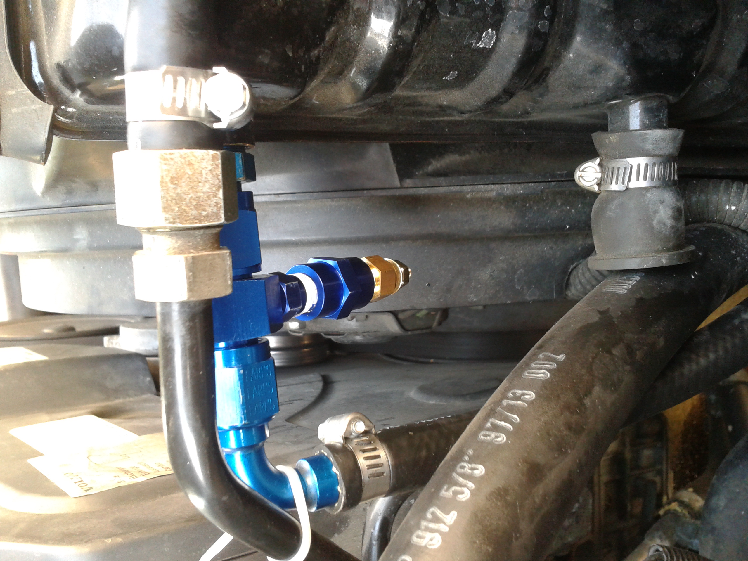

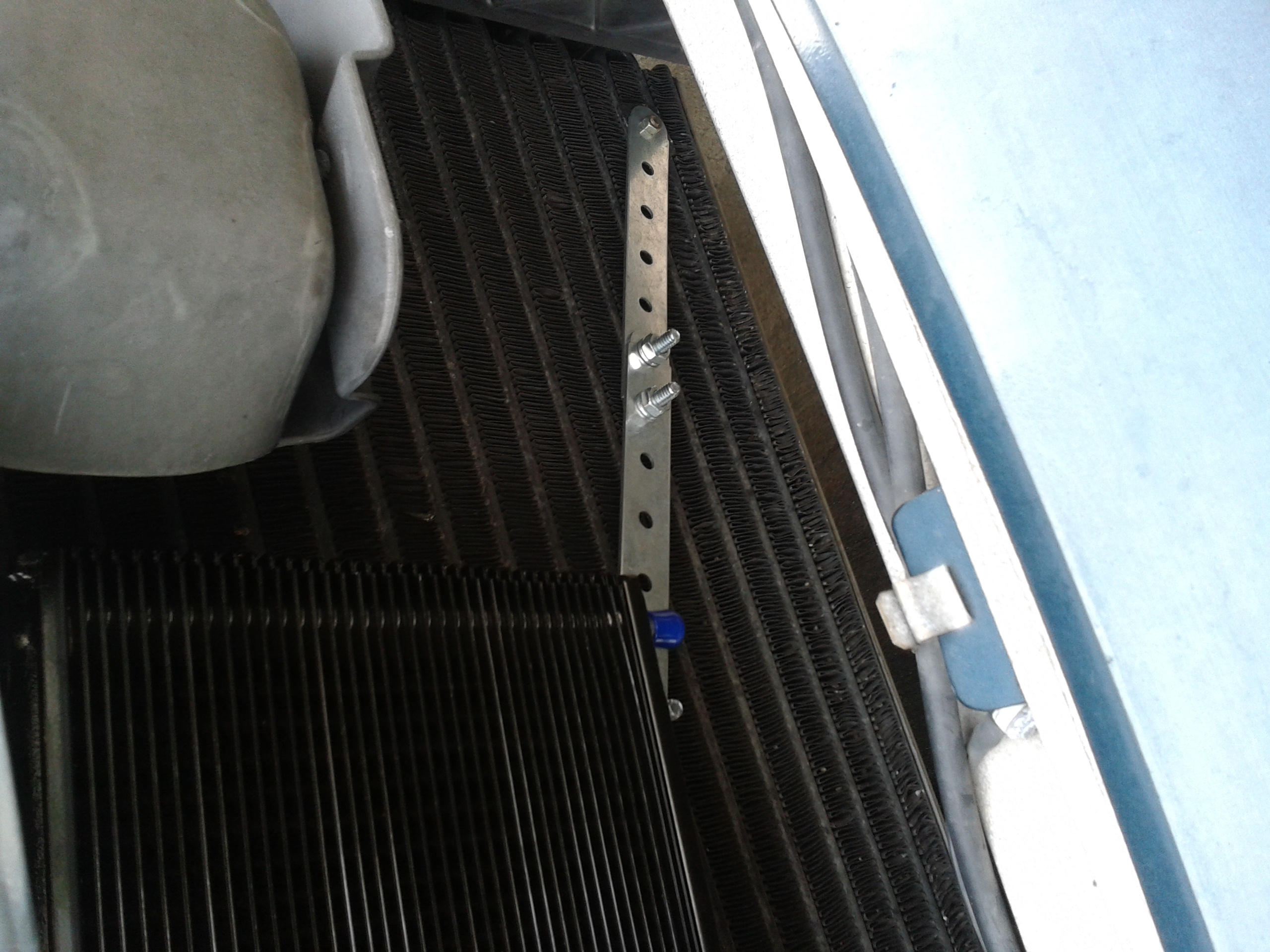

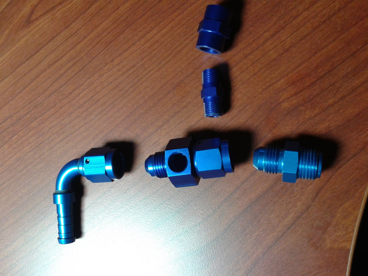

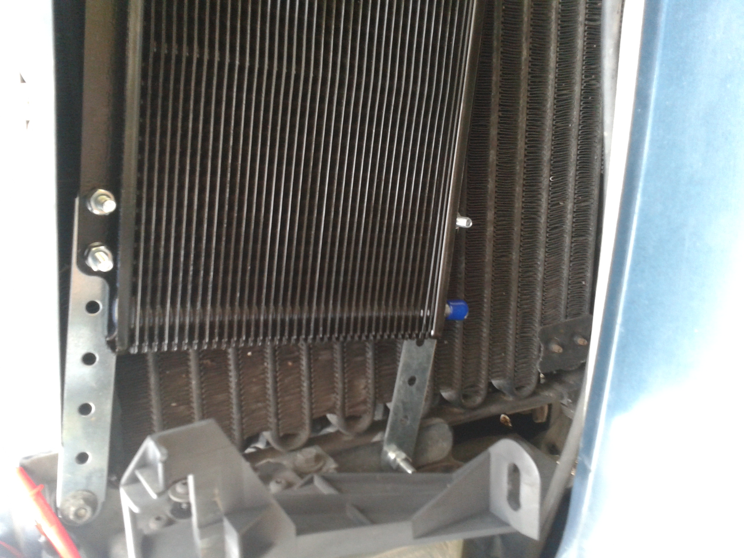

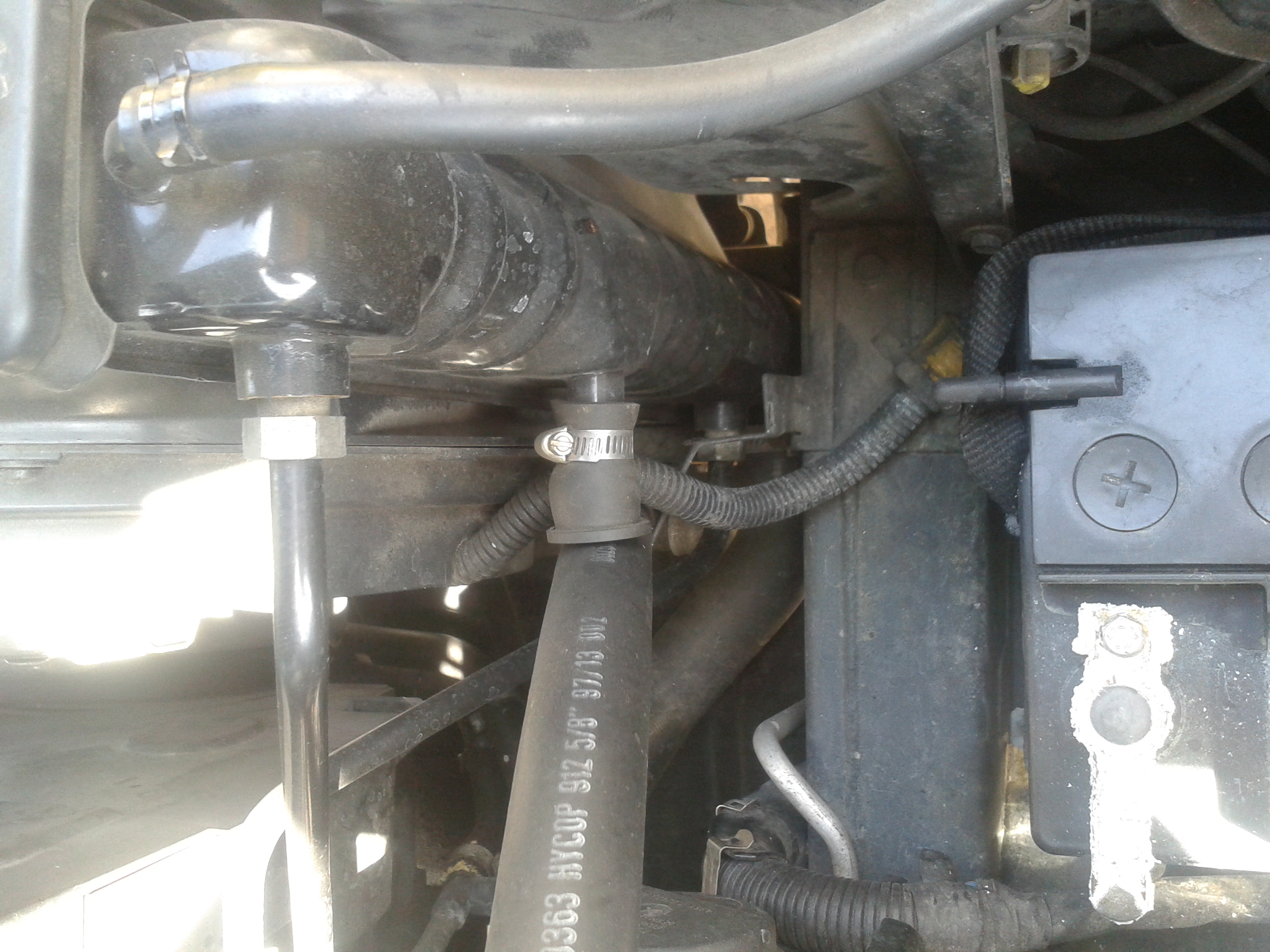

Here is the starting point: So as I got started, I decided I needed to double check the direction of flow. Good thing I did! I had planed for the flow to work opposite of what is actually happening. On my car, the hot oil from the transmission flows to the bottom of the radiator. and is pushed up to the top! This is acutally better due to the ease of access to the upper tubes. I did have to purchase a 17 mm flanged pipe wrench. The brass fittings are very soft! I also decided against the zip tie mounts. I didn't like how close the super cooler was to the condenser. I also was concerned about too much bending on the aluminum fins. So I used the erector set mounting brackets that came with the set. I was able to bracket the coolet to a nut on the corner of the head light, a nicely placed hole in the metal structure and stretched across to the right to catch the end of a condenser mounting screw. All together I had to purchase an additional 3 bolt sets and locking washers. two washers to fit the pre cut hole in the structure, and I robbed a 3/8 nut from the guage kit that I can replace later. The cooler is in a little crooked, but there is no worry for asthetics here. the grill will hide what is going on in that space. On the left, I have about 3 inches between the cooler and condenser. The other side matches up nicely.

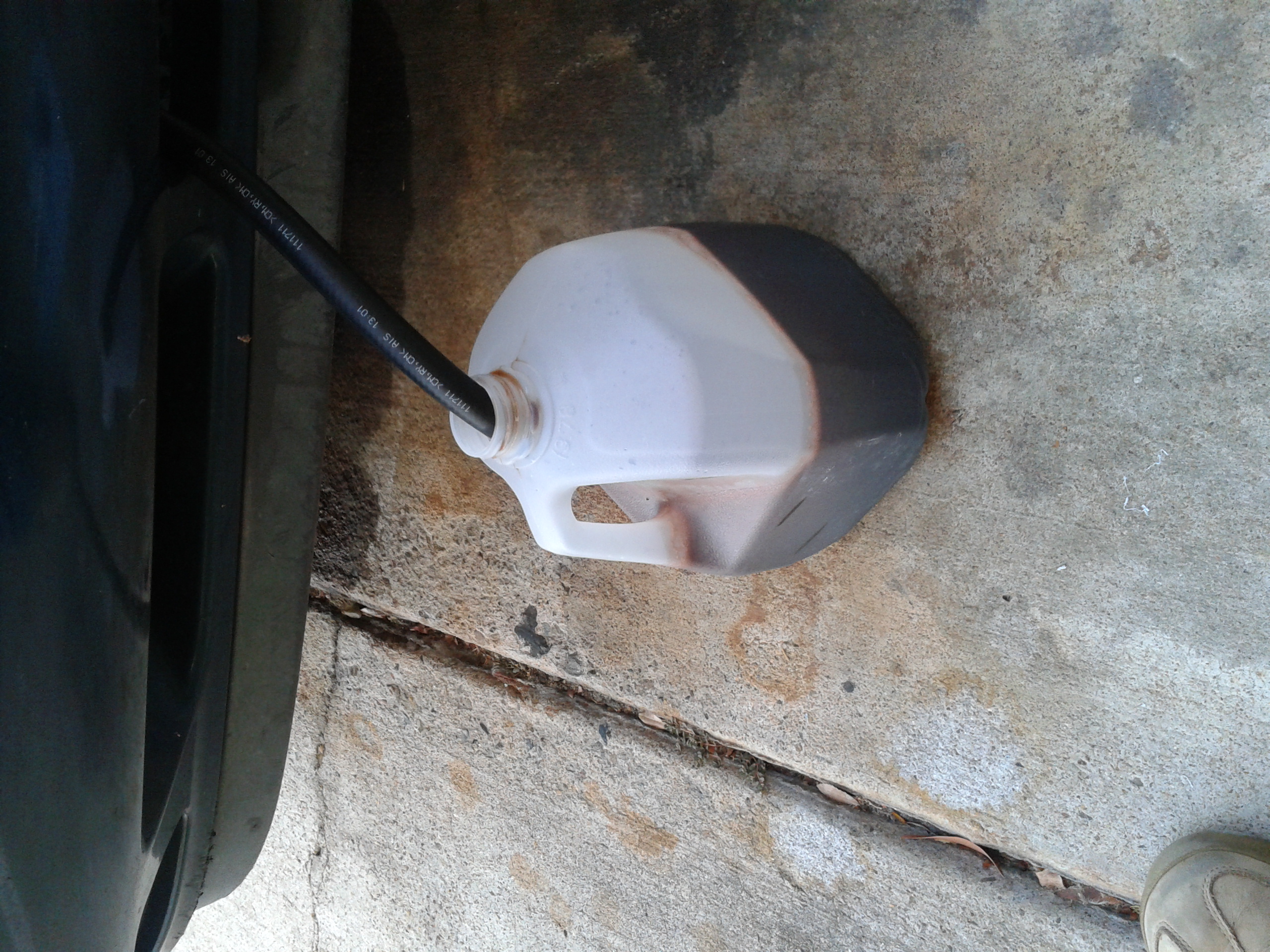

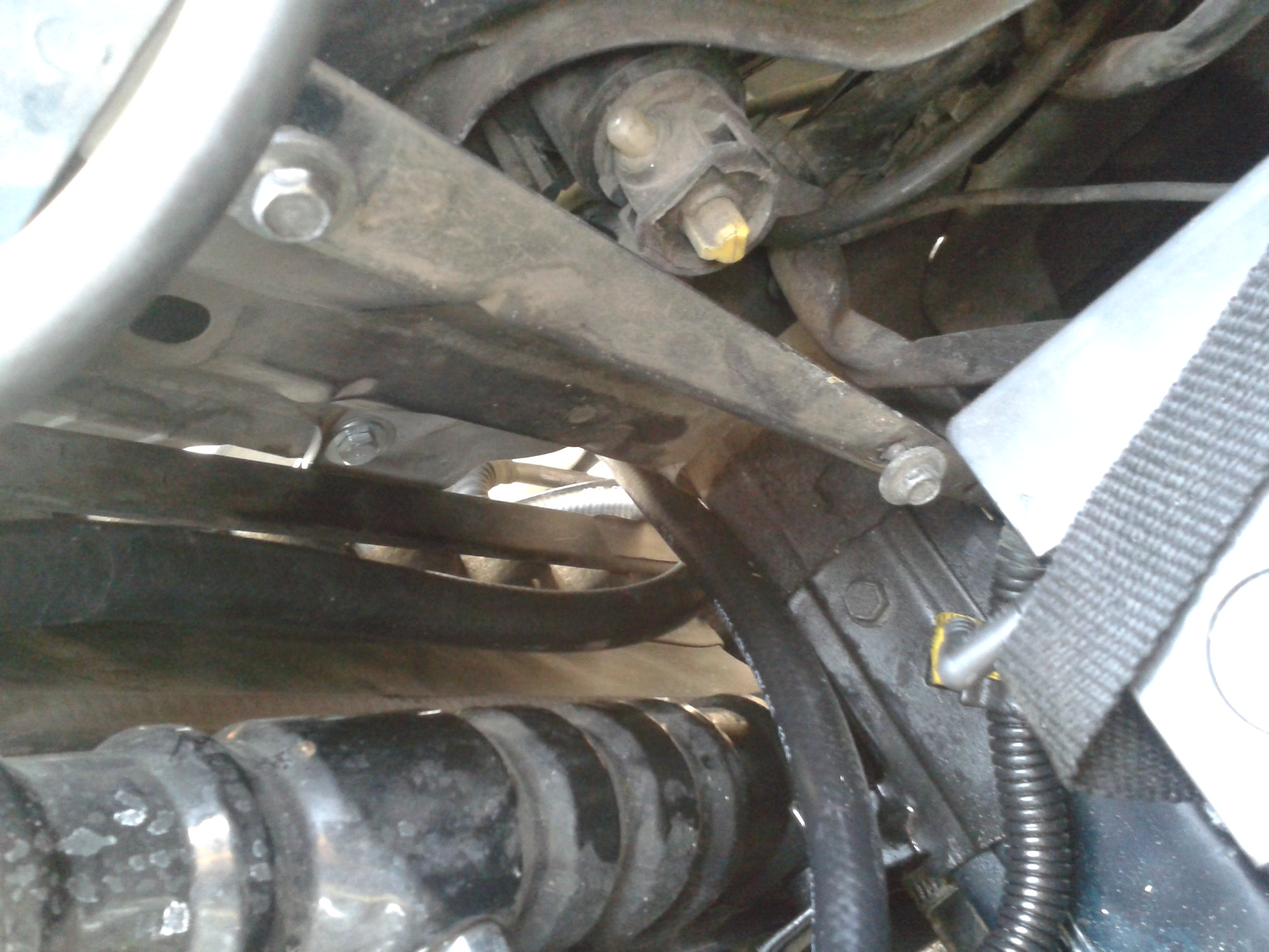

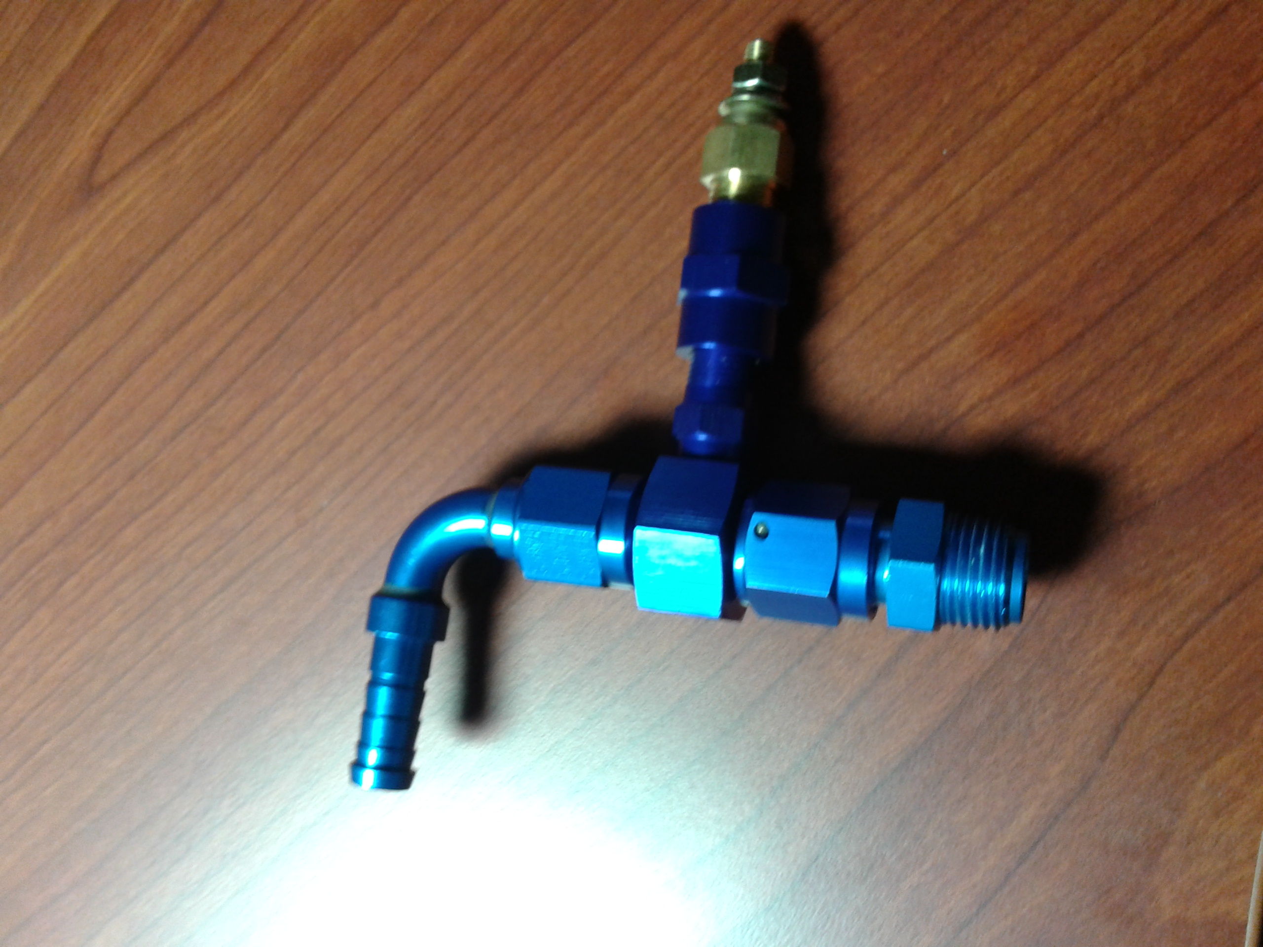

The hose was run through a passage that was covered by two cowels that I removed. I will work to get those back in soon, however there are quite a few spots where the hose could rub more than I am comfortable. So I will be seeking some teflon mesh to protect the hose from wear. Flushed and checked for leaks. I used all 12 quarts I did put more in than I got out. that was to be expected since I added more capacity in hose and the cooler. The major connections are solid. The linkage for the temp sensor is leaking not too bad. it was recommended that I use teflon tape. I did not use it on all the connections, as I was trying to maintain a ground. But I later found I had a lot working against me. the fittings have an anodized coating that do not conduct. also in the largest fitting, where the nuts can swivel, I suspect there is an o-ring that is preventing the sensor from connecting to the radiator... which is grounded. So I will take that sensor assembly apart tomorrow and apply teflon tape a little better to each of the connections as recommended. I will have to come up with a different solution to ground the sensor. Out of light for the day. The biggest part is that the car is drivable now!

Yikes!
So stopping the leaks took some time... Teflon tape on the sensor connections (three spots). No flow of fluid, so teflon works here.
The connecter going into the rediator on the other hand was another story. The threads were too deep on the radiator to get the flange to meet up. The aluminum fitting began to break down as I torqued it down. So I went back and picked up a steel connector and used a washer with an o-ring built in. leaking stopped! Only lost about a half pint running around for the week!
Next to install and connect the guage.
