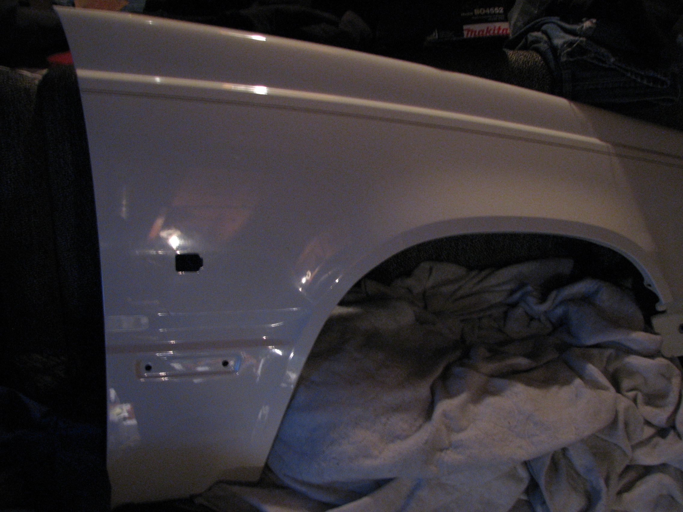

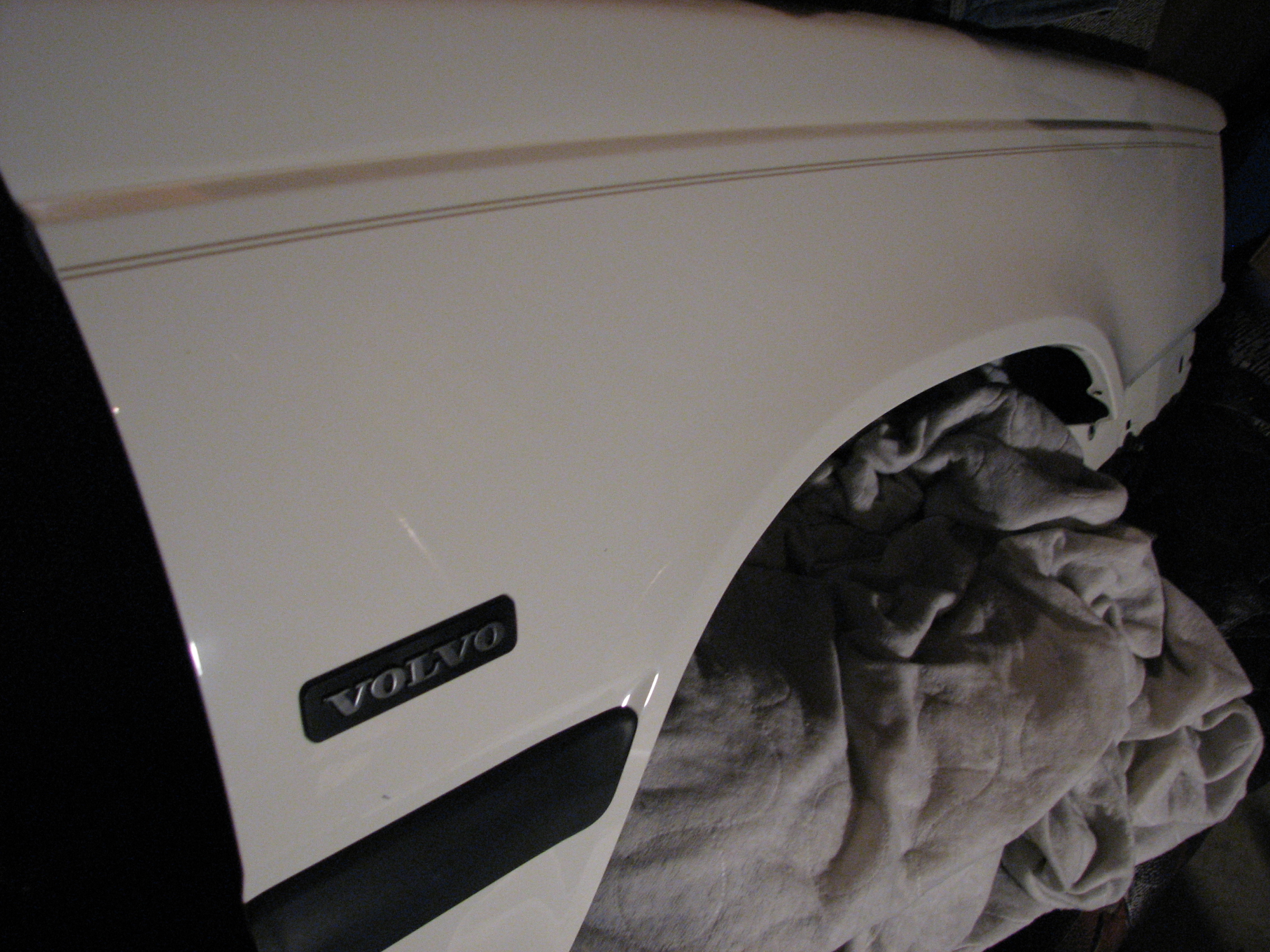

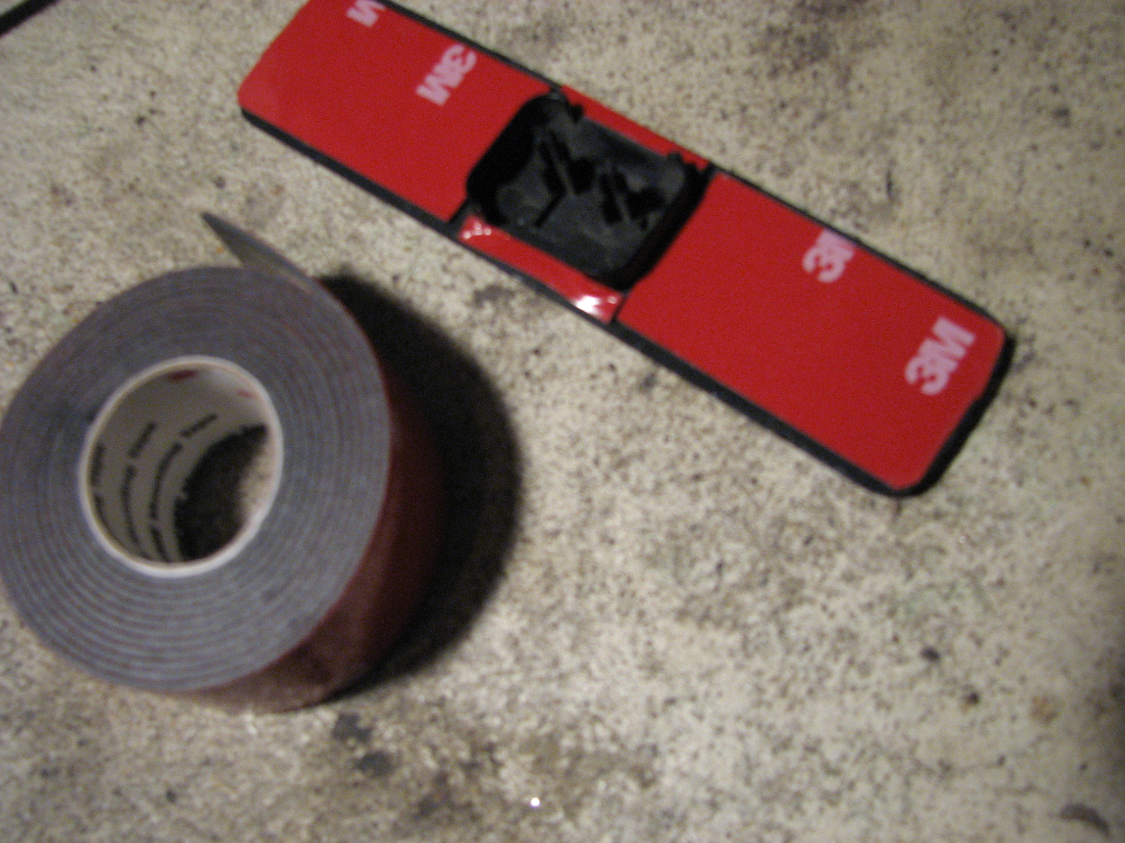

I had used the (yellow) plastic molding tools from Harbor... to pry the tags off
From there, a careful dose of acetone on a paper towel to remove the residual adhesive foam.
3m tape to reinstall.
