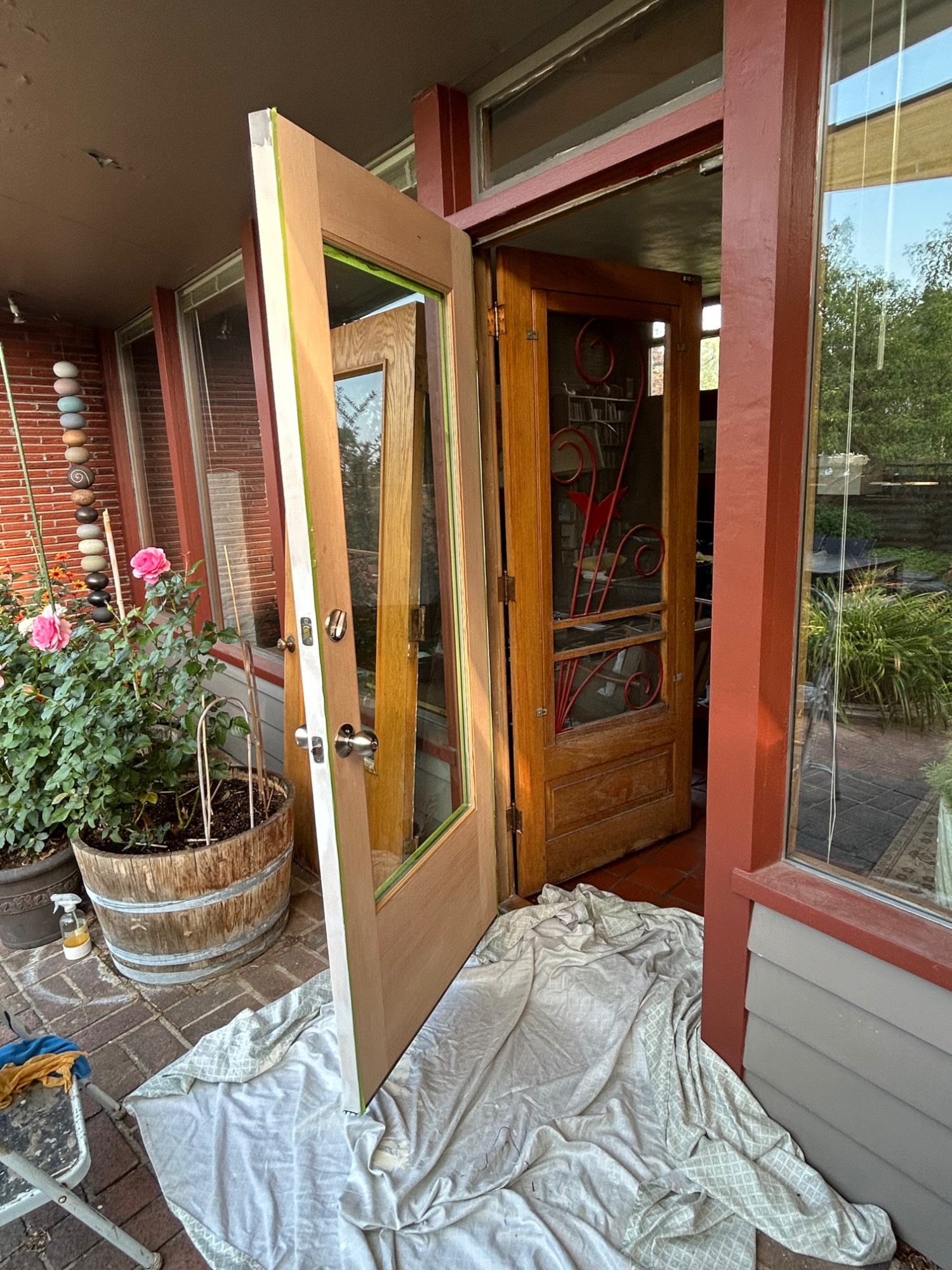

The new store door is solid lumber with fir veneer, like Simpson has made forever - I’ve used them many times. But when I picked it up and unwrapped it, it says Made in China on the bottom….wat? So, Simpson cut the trees down in the NW, but somehow the wood got to China and a door factory. Wow, how do you like that?
I noticed the woodwork and ogee window stop wasn’t all that accurate or cut very well - splits and splinters.

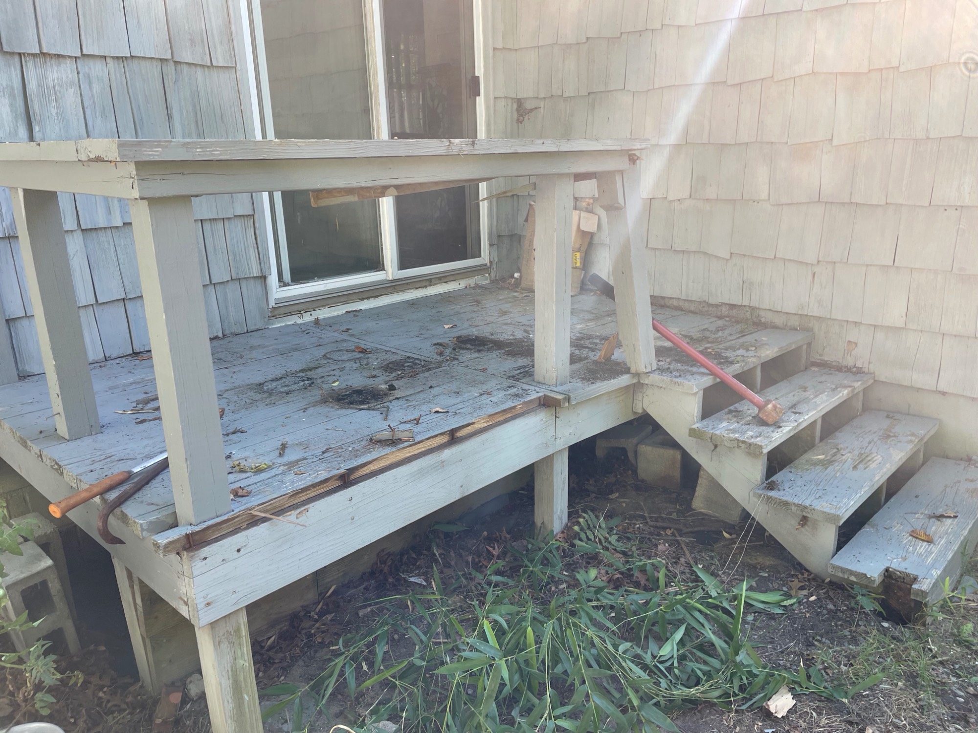

Going to try rebuild a deck before winter. Cool weather now perfect for demo and carpentry
Pictures to come

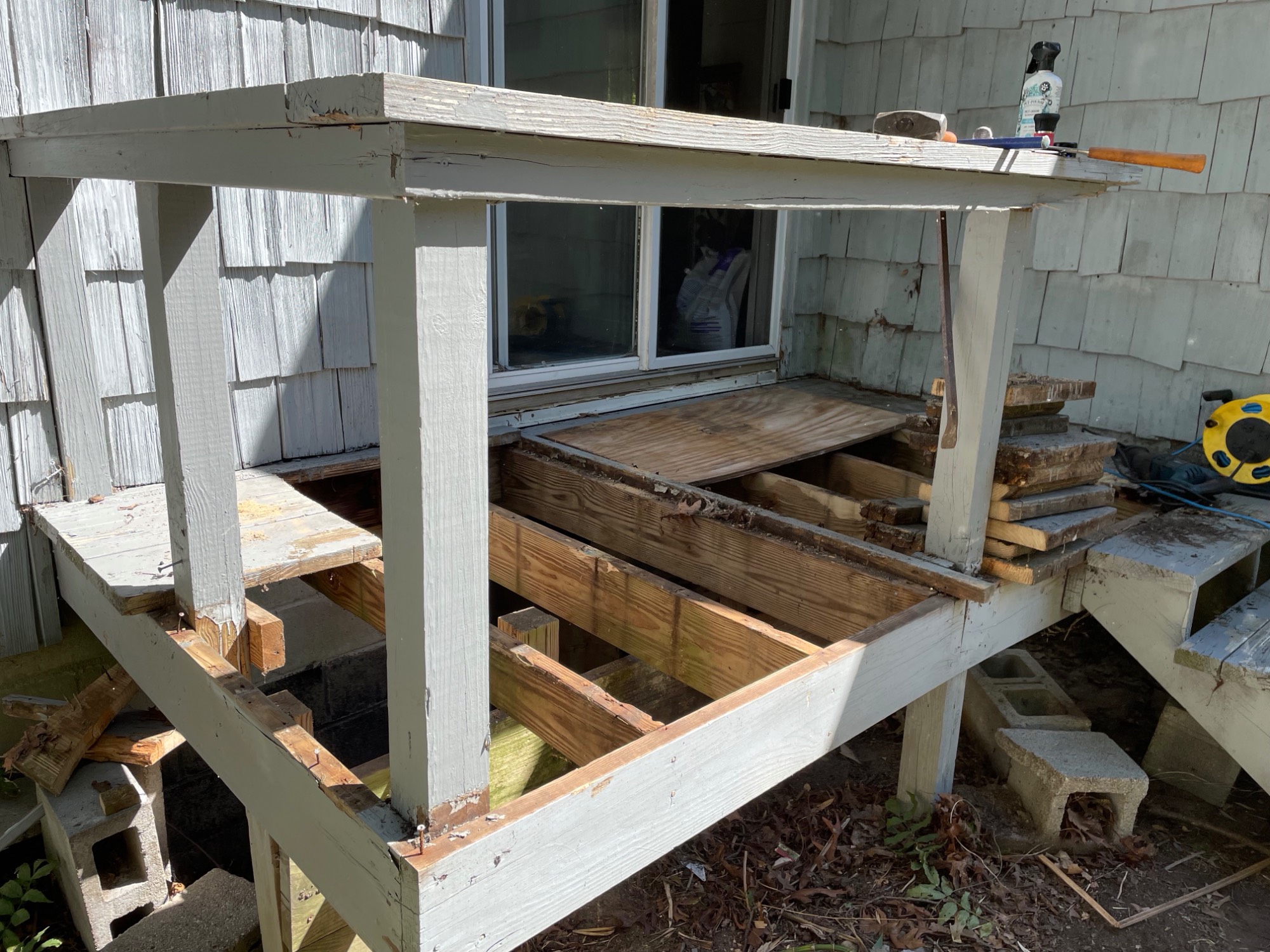

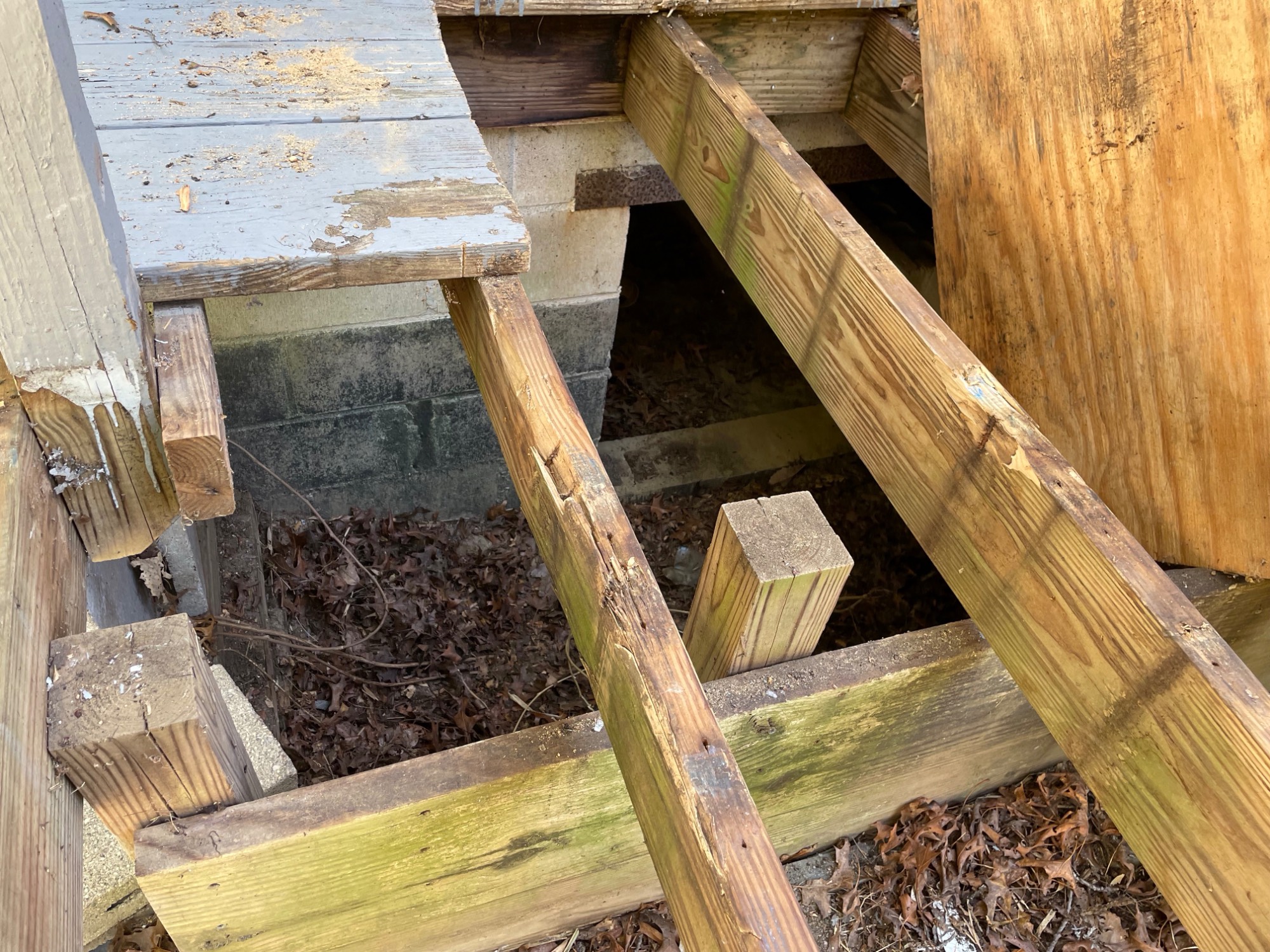

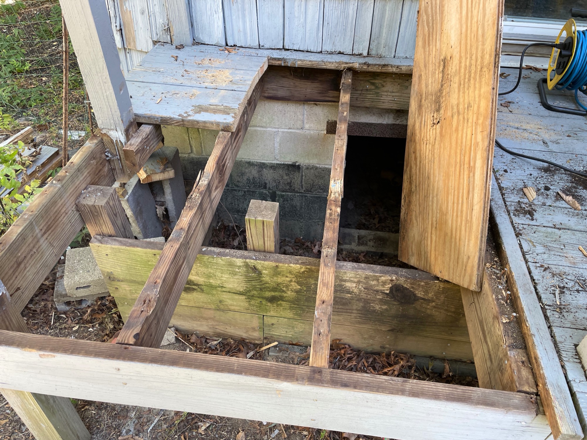

2 hours this morning …
I started out trying to pop the decking lengthwise but the builder was a contractor amd had no shortage of twisty nails in this deck; well done! I broke out the reciprocating saw and cut each board at the joist which then made stomping on them the easy removal method. No labor lost as I needed to cut them up for disposal,so a job well done.
We still have to decide if we will push another ten feet of deck,I’m leaning that way
