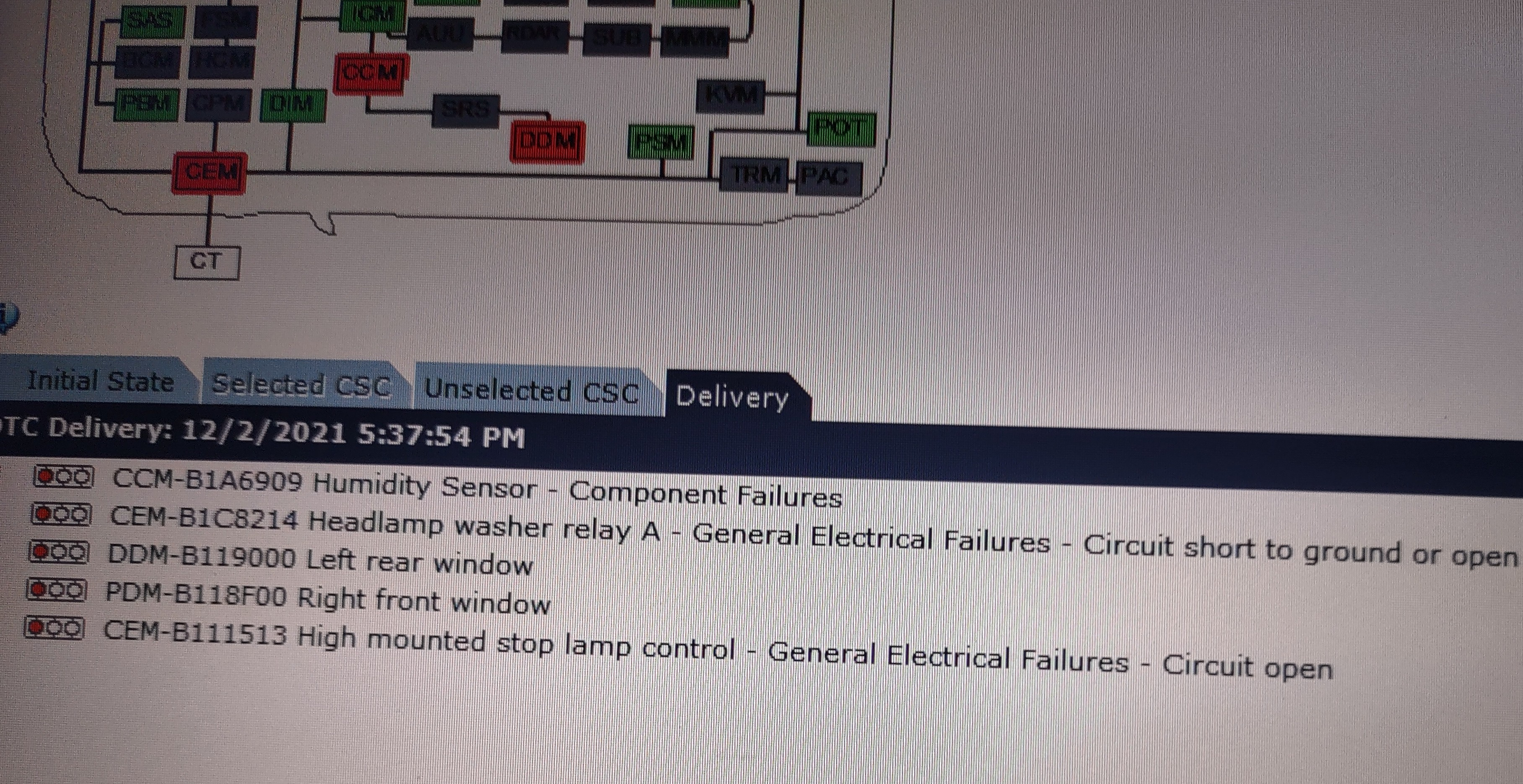

Hey all.. I've been chasing my tail on this one. So, I just bought a 2008 XC70 and the CEL popped up. At the top of the list it stated .. humidity sensor.. does anyone know what that is and it's location?

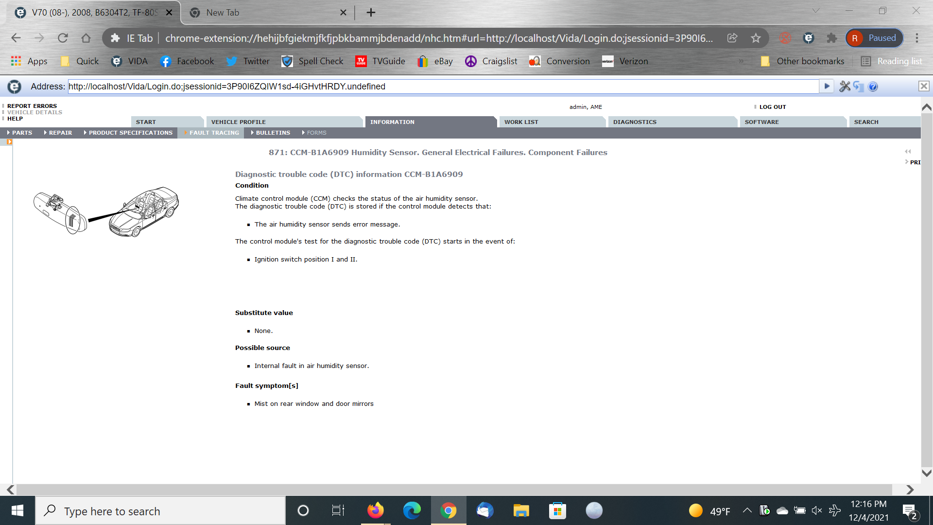

It is in the rear view mirror.
