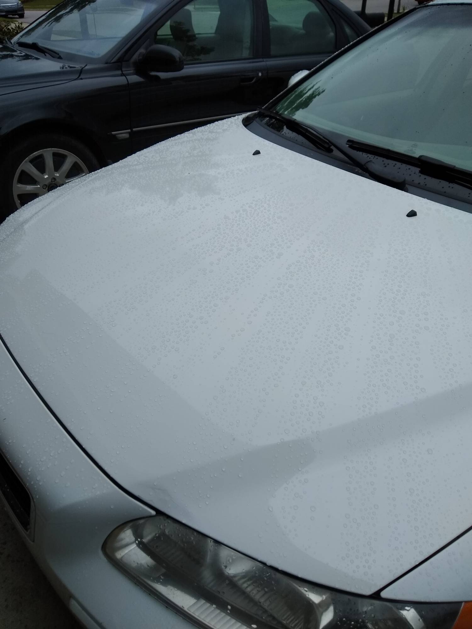

The wax I used is from Meguiar's..........note the picture can't be used to judge its effectiveness because the time from application to deluge was only about 30 minutes.....LOL
I do like the look of the White Paint covered in water droplets.
A good white color like yours looks really clean (when it dries off)

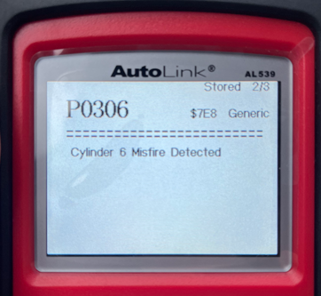

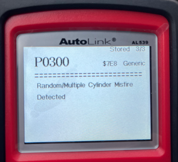

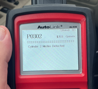

P0302 Misfire Cylinder #2
P0306 Misfire Cylinder #6
P0300 Misfire Multiple Cylinders
So what did I do?

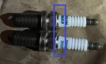

Because I have brand new Iridium TT sparkplugs and brand new Volvo coils on the shelf I changed #2 and #6
Note: my Niece needed the car so I didn't have the luxury of completing a careful diagnosis.
However I was able to collect more data after she had driven the car a few times (about 50 miles).

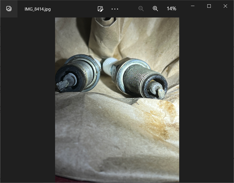

I installed these Sparkplugs about 3.5 years ago (~25,000 miles). Here are the Plugs that I removed. Looking at the Highlighted area there is no evidence of Corona discharge. Note: I apply Dielectric Grease to the ceramic where it touches the boot from the Ignition Coil. So my Paranoia seems to have been effective.

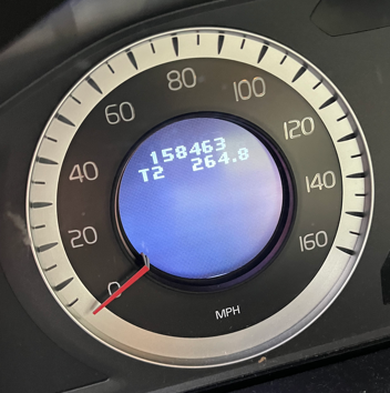

Almost 160K miles (250,000 Kilometers if your prefer those units)
Here is the Misfire Code for Cylinder #2 (I checked this before replacing parts)
Here is the Multiple Misfire Code (I checked this before replacing parts)
Here is the Misfire Code for Cylinder #6 (I checked this before replacing parts)

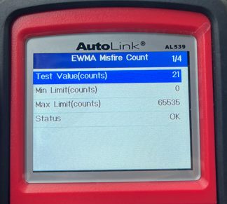

The Pictures below I got this information after replacing the coil pack and sparkplug for cylinder #2 and #6 and after the S80 had been driven about 50 miles
Cylinder #2 Exponential Weighted Moving Average (Last 10 trips)
Over 2000 Misfires is a lot.
Here is the most recent trip for Cylinder #2 (after replacing the sparkplug and coil)
Zero Misfires is significantly better.
Cylinder #6 Exponential Weighted Moving Average (Last 10 trips)
21 Misfires isn't that bad and it is possible that the ECU was incorrect about these.
Here is the most recent trip for Cylinder #6 (after replacing the sparkplug and coil)
Here is the final picture of the Sparkplugs (I didn't keep track of which is #2 and which is #6) but looking at the insulator one of the plugs clearly has a WHITE area and the other doesn't. The reason that is is important is because the Voltage applied by the coil is trying to find the ground and it will jump across the gap to get there unless it can fine an easier way. Possible alternate leakage paths are the Corona region I identified in the first picture and the ceramic insulator inside the combustion chamber in this last picture. Looking at this last picture it seems clear why I had a lot of Misfires. Unfortunately the Root Cause is likely due to oil entering the combustion chamber due to a blocked oil control ring. This is a know problem for certain years on the 3.2 where Volvo switched to a THIN oil control ring to get a slight improvement in fuel economy.
What I can tell you is that I have purchased a Hotter Sparkplug to fight the oil fouling.
IKH16TT instead of IKH20TT.
Happy Holidays
Paul
PS I may try a chemical solution to free up the #2 piston rings. If I do I'll post it here.
