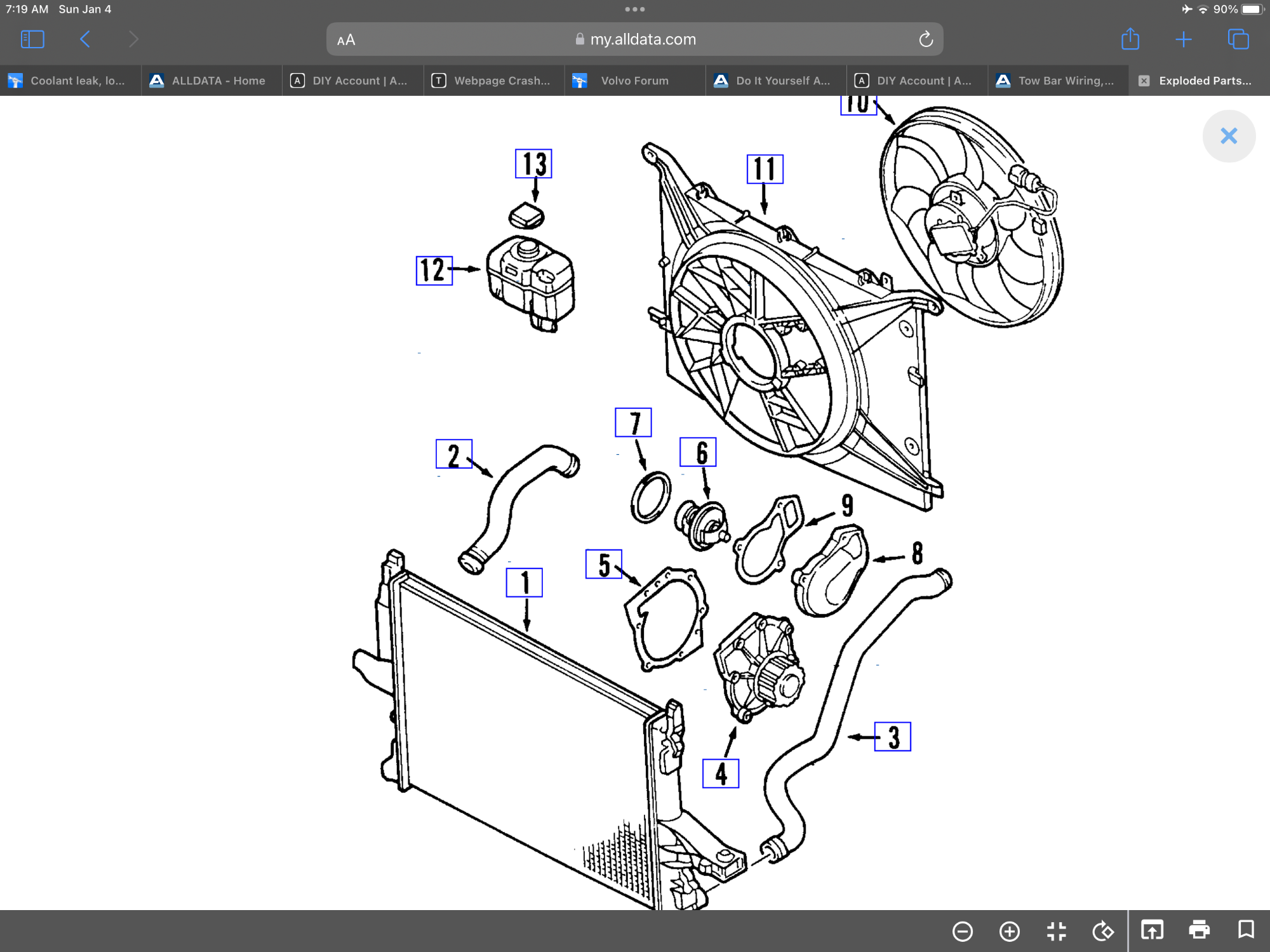

Have you looked for a diagram of the Read system and cooling group? I’ll see if Alldata has one and post
I believe your3.2 is like my xc90 3.2 with the water pump being driven by pins on the power steering pump. Repair and replace is about 3 hours book time.
From your description it looks like the water pump has let go and is spewing onto the PS pump. At 200k miles, I would do the pump, thermostat and all hoses as PM

The Thermostat is a known failure point for the 3.2
And because it has a mechanism that recirculates the coolant when the engine is cold it can fail and not flow coolant to the radiator.
But the Thermostat is not the leak. If the Thermostat leaks the coolant will be on the Alternator and intake manifold not the serpentine belt
The most common failure is a large coolant hose under the AC compressor
It can be seen in the picture on the left side the belt is almost touching it
Good luck
Paul
