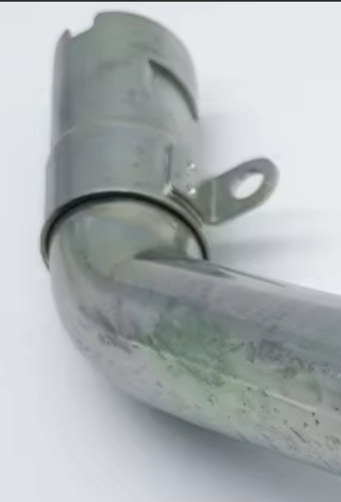

Here is a picture of the divit in the metal pipe that the gray latch engaged with
By rotating the gray part with respect to the metal pipe the latch will be released and then you can remove the hose
But remember that there is a O ring so it will likely still take some effort
Good luck
Paul
Good luck
Paul
