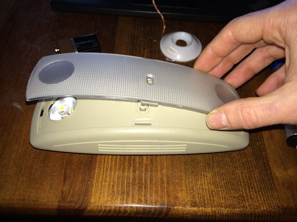

Next remove the plastic translucent bulb cover to get direct access to the underside of the lamp. Simply wedge a flat blade screwdriver in each end first to lift the ends out and then pry out the centre.
The next step involves prepping the surface for soldering the LED’s on. Take the two existing bulbs out by twisting and then pulling out the blue light bases. The base as well as the bulb should come out together.
Next, prep the soldering gun and heat up each brass plate one at a time while adding solder to the surface of the brass. It may take a few tries as the brass seems to have a protective film on it. Be cautious not to melt any nearby plastic. The result of the soldering is shown below. Note that the LED’s are already installed in the pic – do not solder them to the brass until you have successfully applied solder to the brass only first!
Take two 5W5 LED’s and bend back the connector wires so that you can pull the plastic base right off the LED. This step is necessary because the bases are not compatible with each other. Once the LED has been released from its base, insert the LED into each hole from below. Once through, bend back the two connector wires sideways so that each makes contact with the brass plate while supporting the LED in place. Take a look underneath to make sure that the LED is well positioned. Be sure to connect the + side of the LED to the correct side of the board (see pic above for details). Each LED should also show the + and - terminals if you look very closely at it. If not, just use a 9V battery to figure out which side is which.
Solder the LED’s on as per pic above and cut off the extra wiring with the wire-cutters after the soldering is done. Test the lights by plugging the blue connector back in and turning each switch on.

Insert each LED in from below and solder taking careful note of the orientation of each LED. Both rear lights should have the + side of the LED placed outwards. While I have yet to do the front two, I’m going to go with the assumption that they require the same orientation. The rear lights can be tested by placing a 9V battery across the terminals of one of the two lights. When the battery is connected BOTH rear LED’s should light up. Obviously, be sure to connect the + of the battery with the + of the LED.
