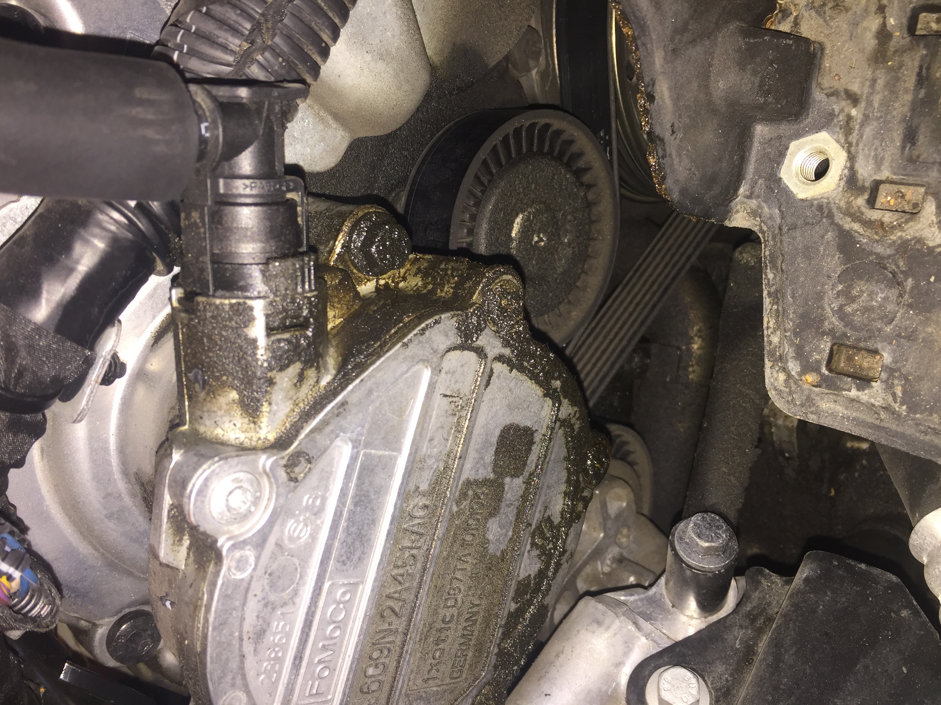

Repaired the Vacuum brake booster O-rings
Volvo Brake Vacuum Pump Repair Kit - Genuine Volvo 31401556 1 $62.53
More information can be found here http://www.freel2.com/forum/topic32282.html

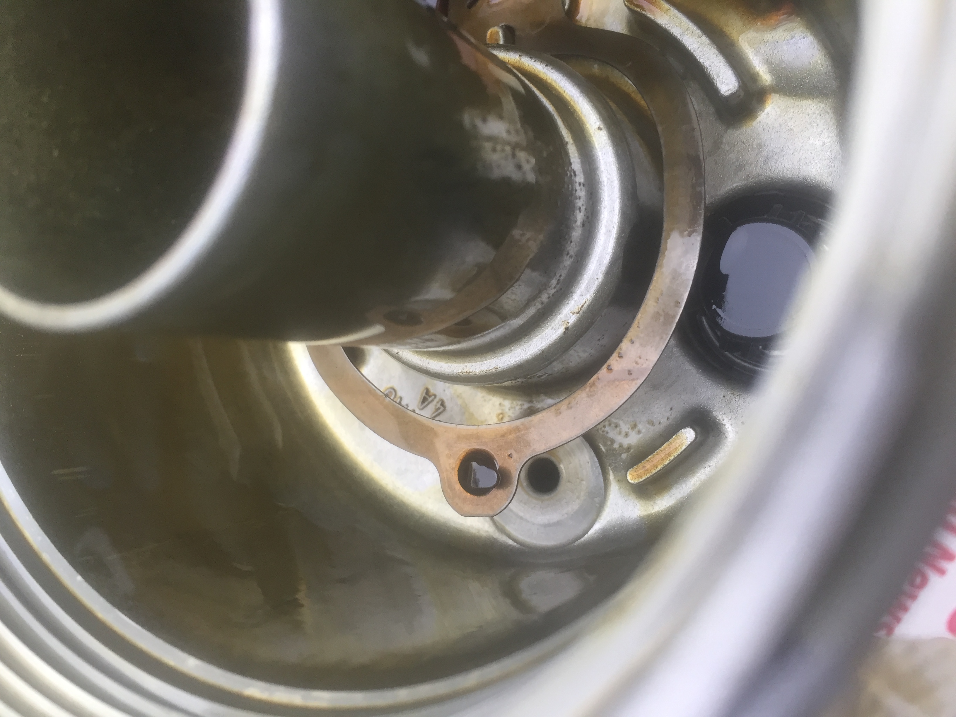

Replaced the oil filter housing plastic cap
The previous owner decide to remove the bypass valve, which means that the oil was by passing the filter.
I restored the function to what Volvo originally intended.
I think I know why the previous owner did this and I will document my fix here
Cost $0.00 (I already had this due to a part that failed on my LR2)

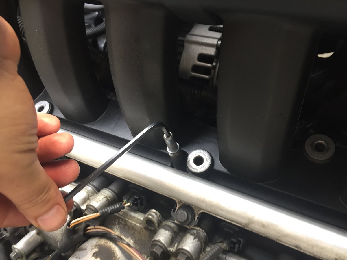

All,

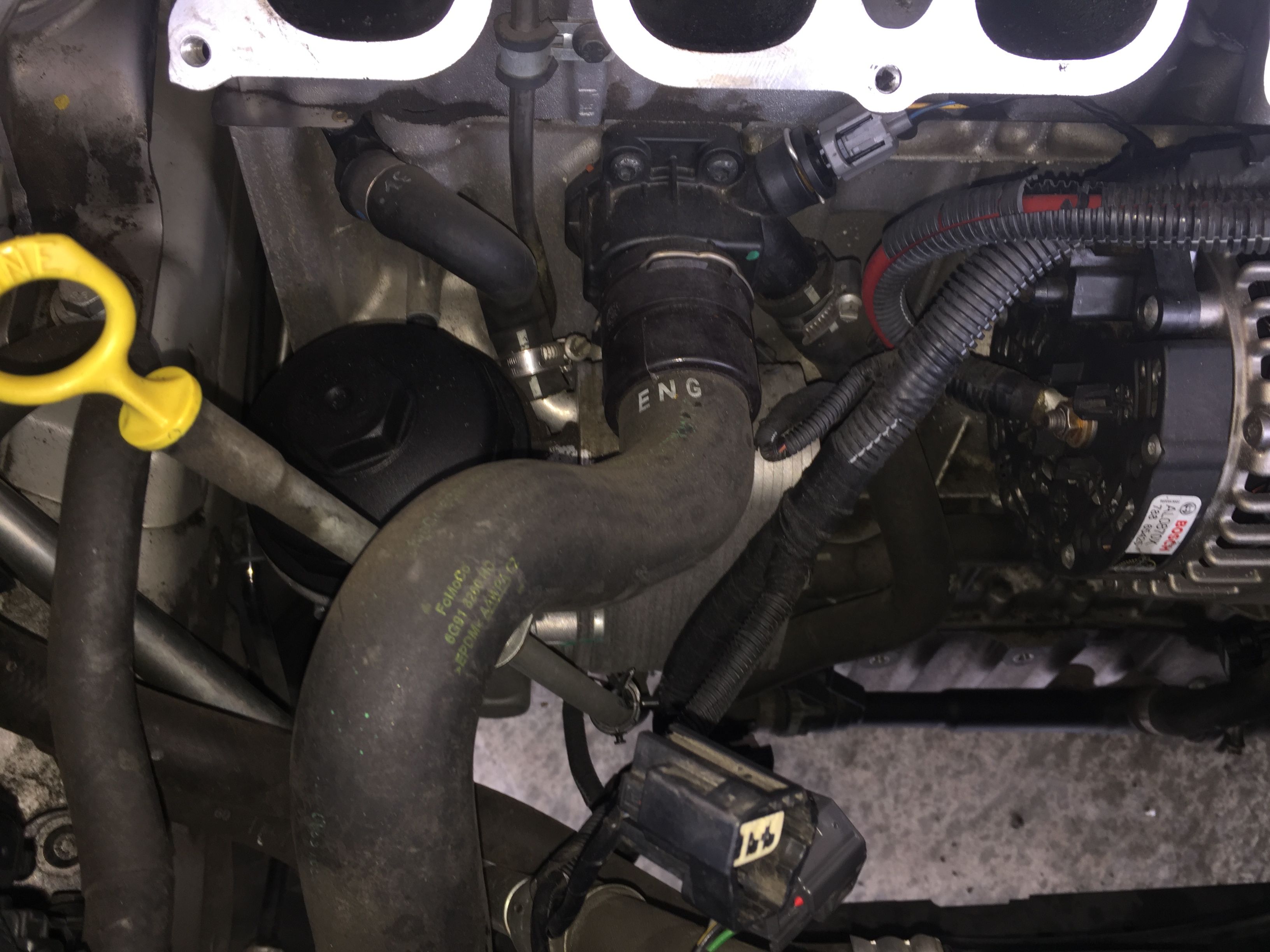

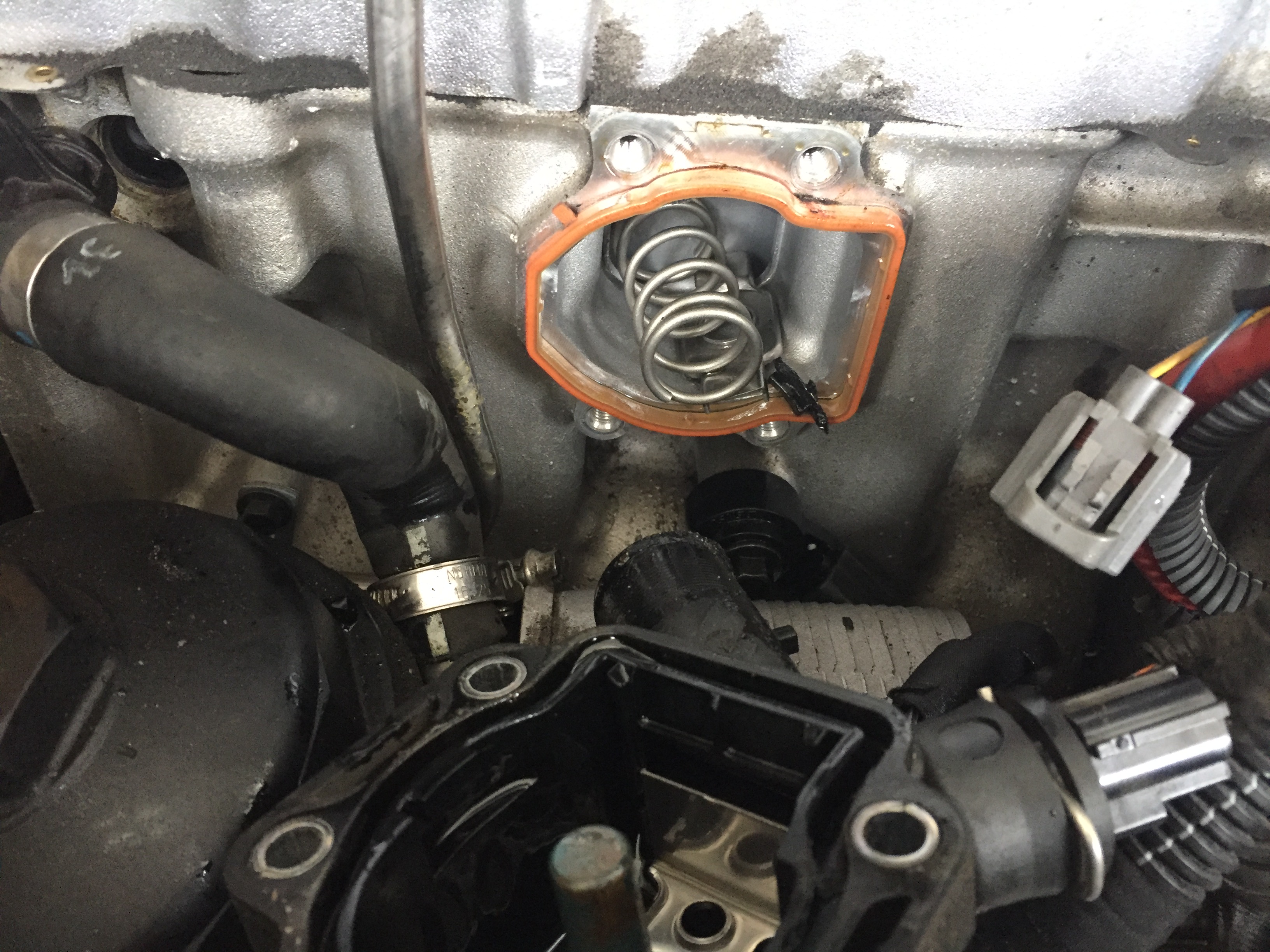

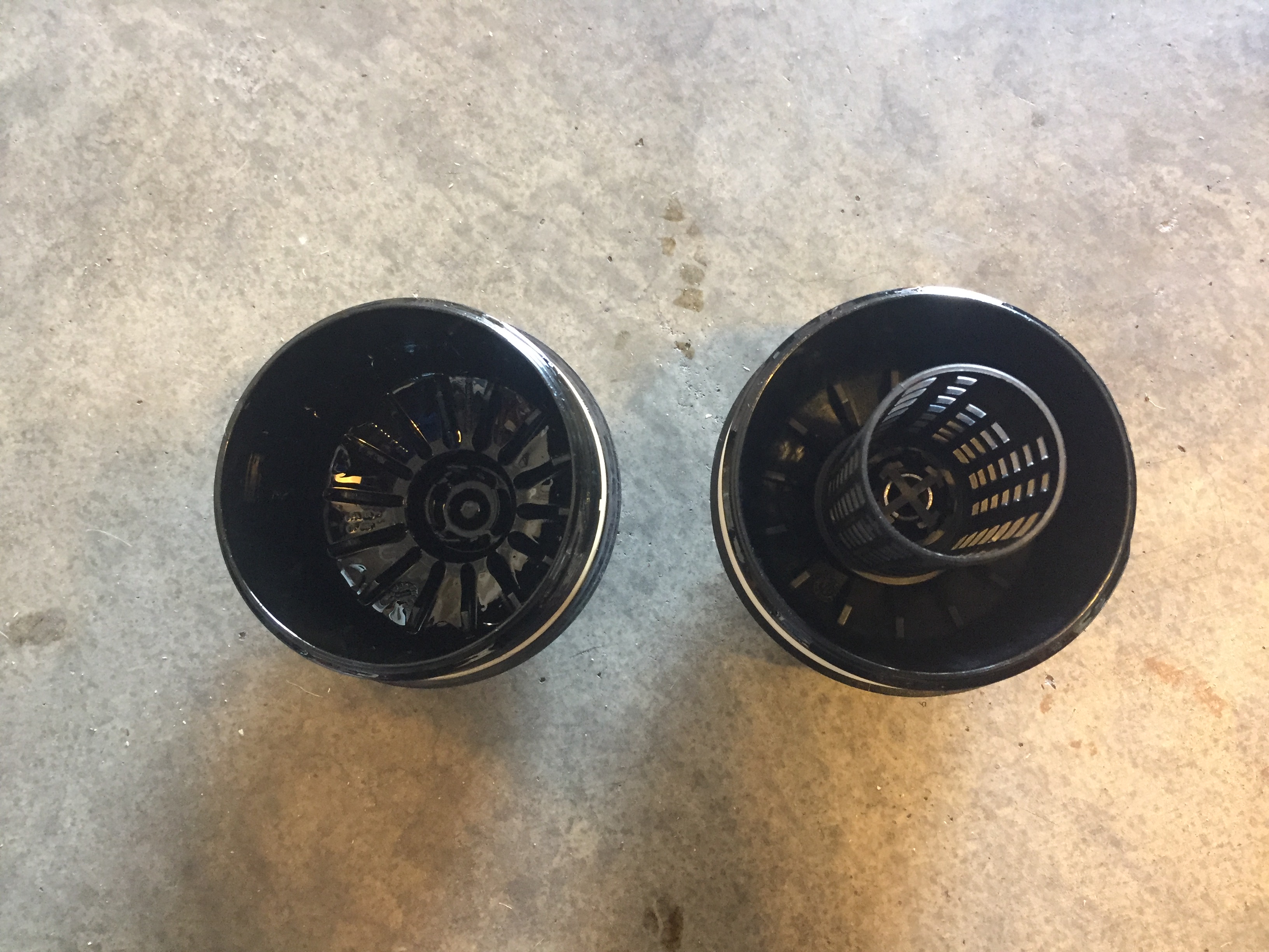

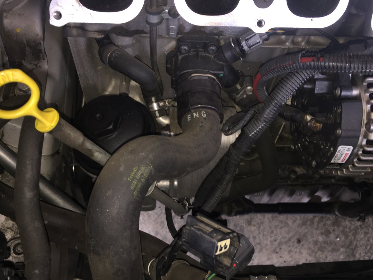

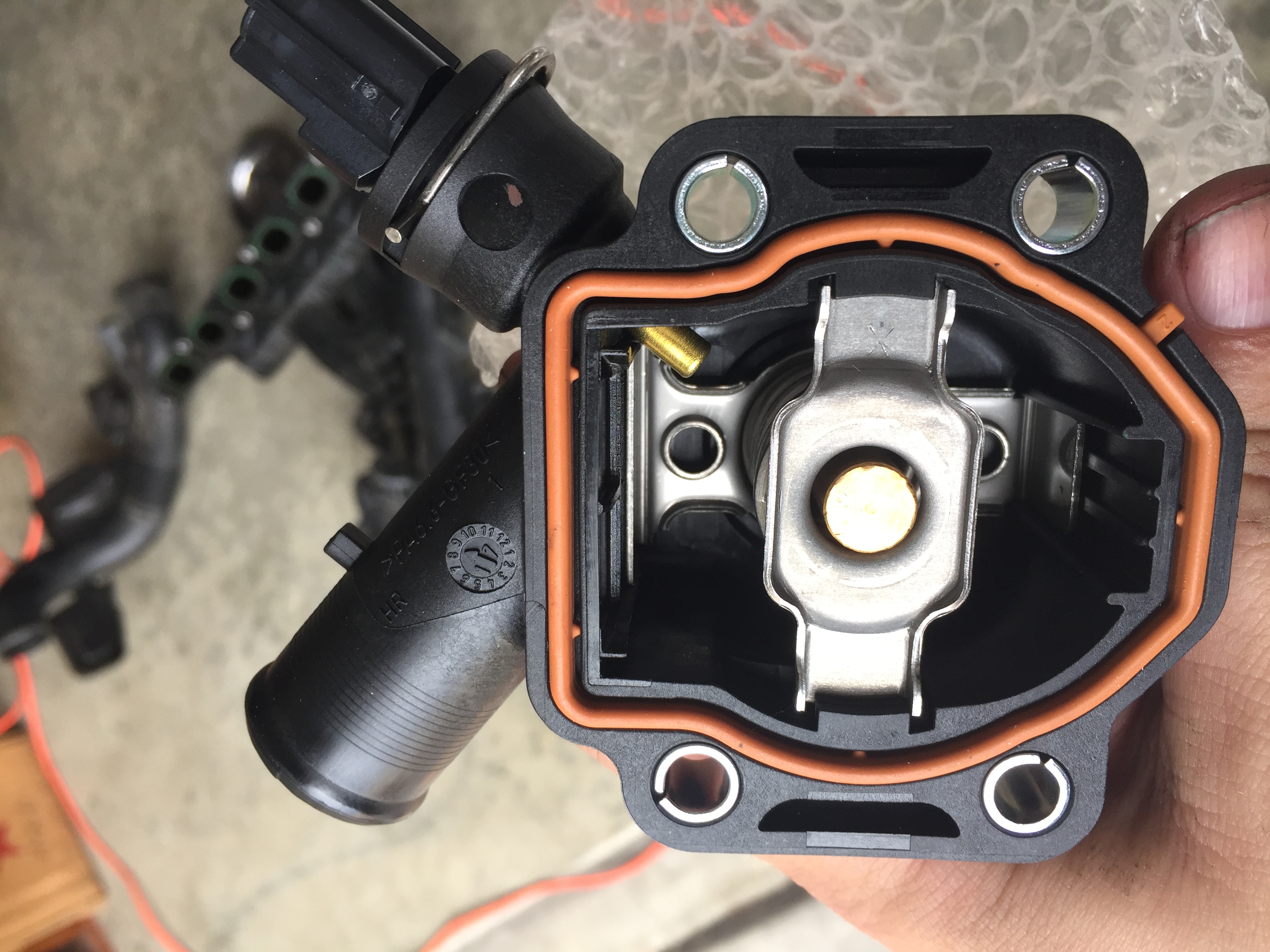

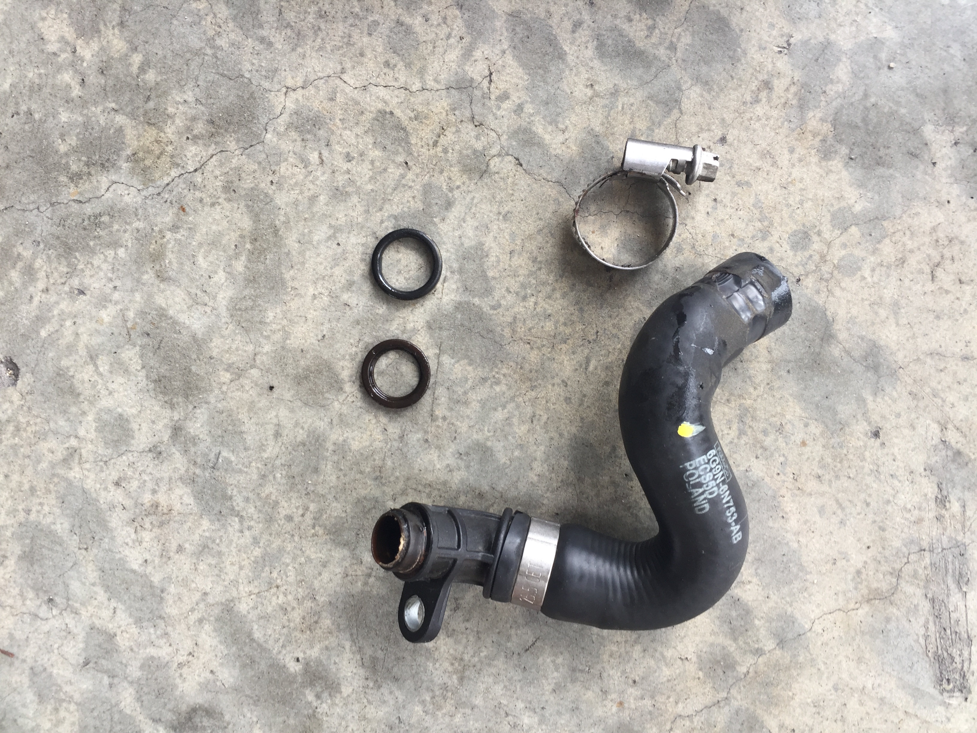

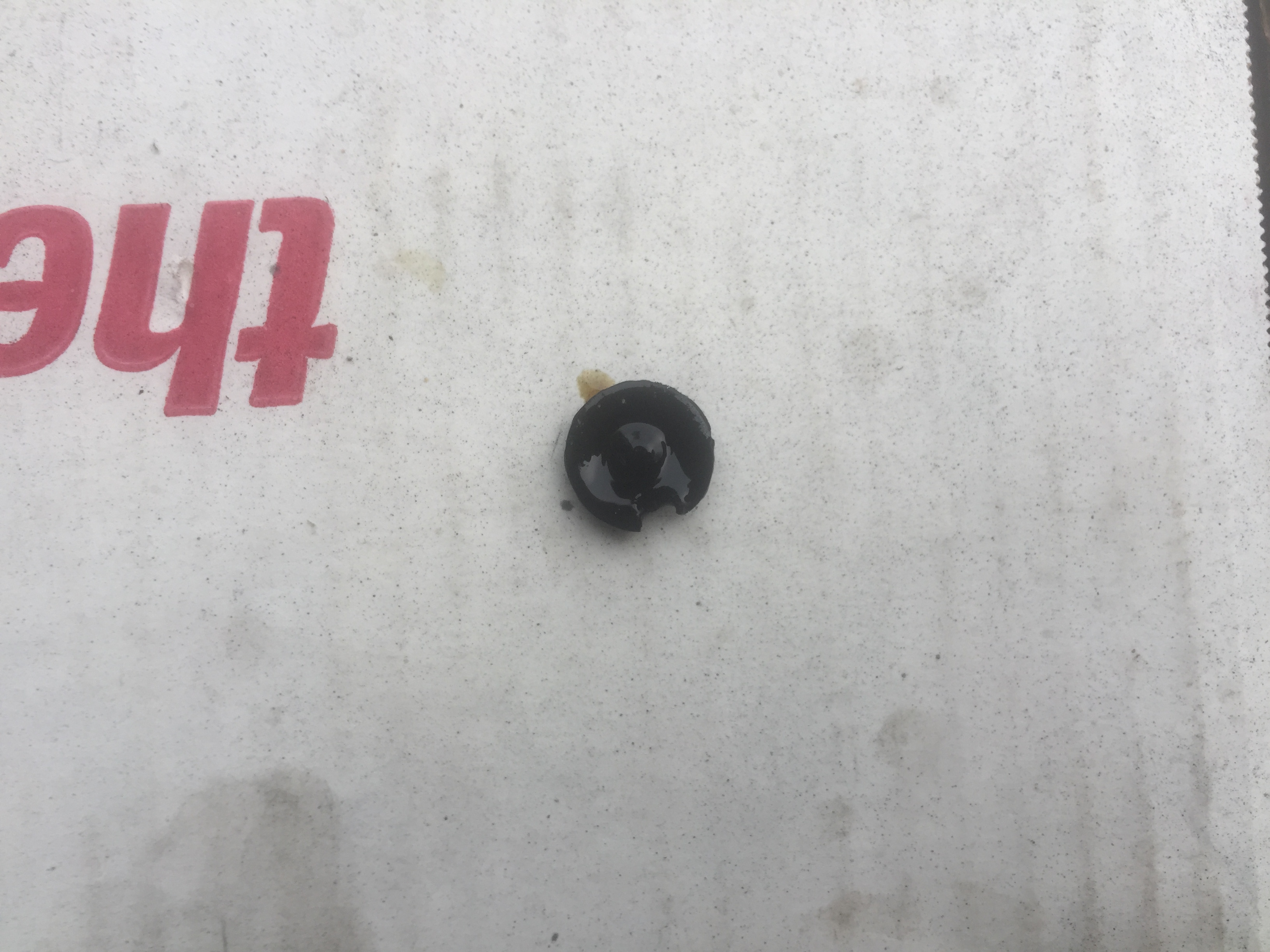

I did some more maintenance this weekend

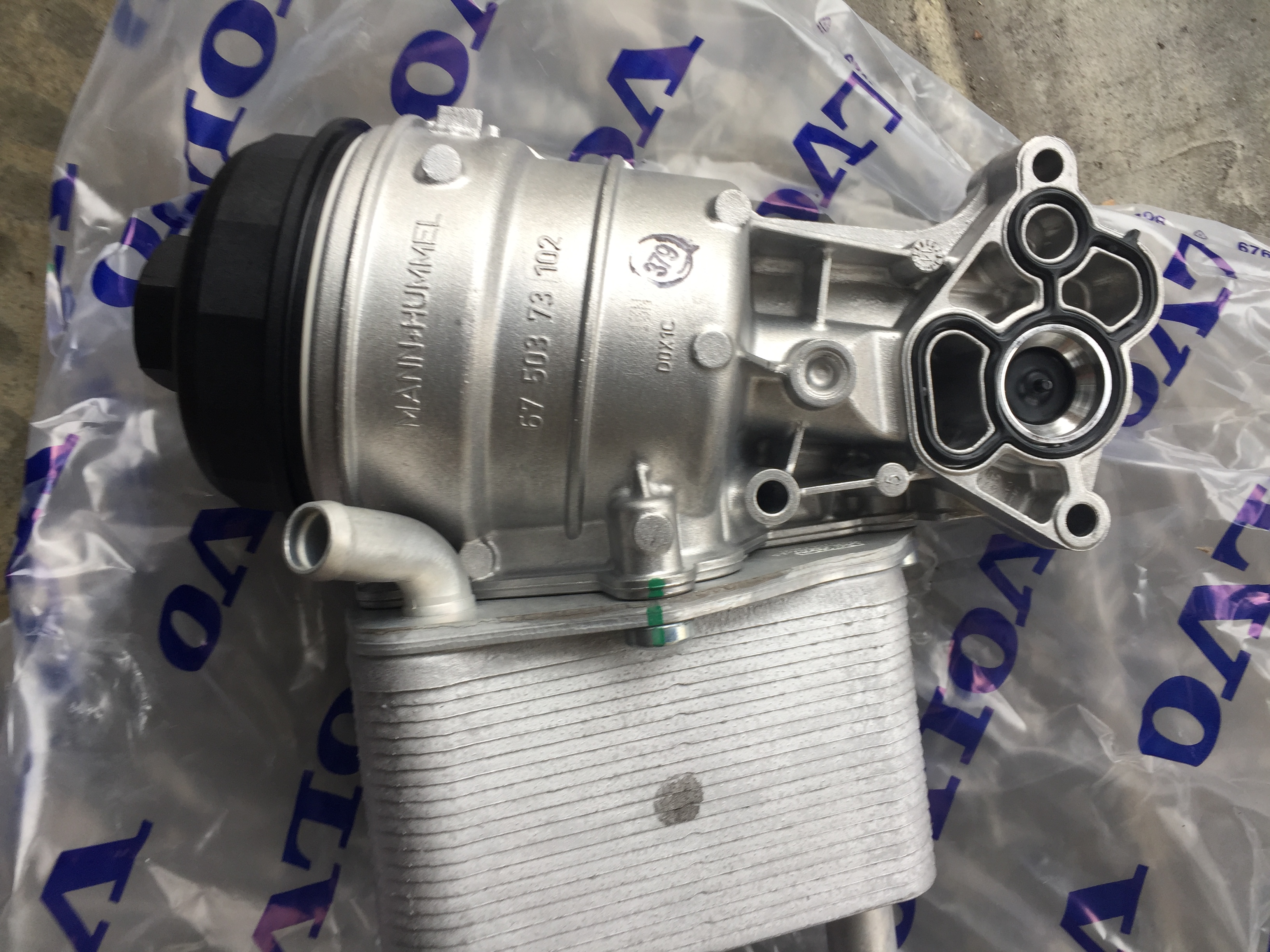

Replaced the Thermostat (it was broken, I recommend that everyone replace theirs every 10 years)
Replaced the oil filter housing (due to a broken anti drain back valve)
Replaced a coolant hose
I did nearly the same work on my LR2 http://www.freel2.com/forum/topic32245.html
The parts are the same for the Volvo or Land Rover (The Engine used for both was built at the same factory)
Pictures of the fun
The last two picture show the Rubber disc and the hole that it covers to keeps the oil in the filter housing.
The entire housing is not expensive so I bought the entire housing.
The alternative was to fabricate a new disc to block the drain hole.
I'll update the cost number later this week
Thanks
Paul
