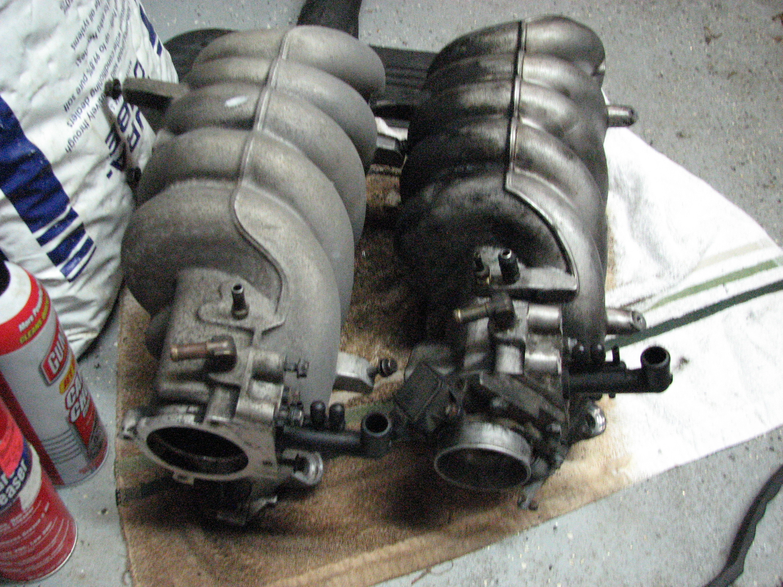

I have the use of a garage for a few days.
My goal this week is to do the 3'' n/a intake and throttle body.
Silicone turbo and coolant hoses.
Now a new radiator, since seeing its deterioration. A few drips of antifreeze on the tanks, and the bottom steel strap is fairly rusty.
Timing belt, Gates Blue, Aisin tensioner, INA pulleys, Aisin water pump, Nissens Turbo radiator.

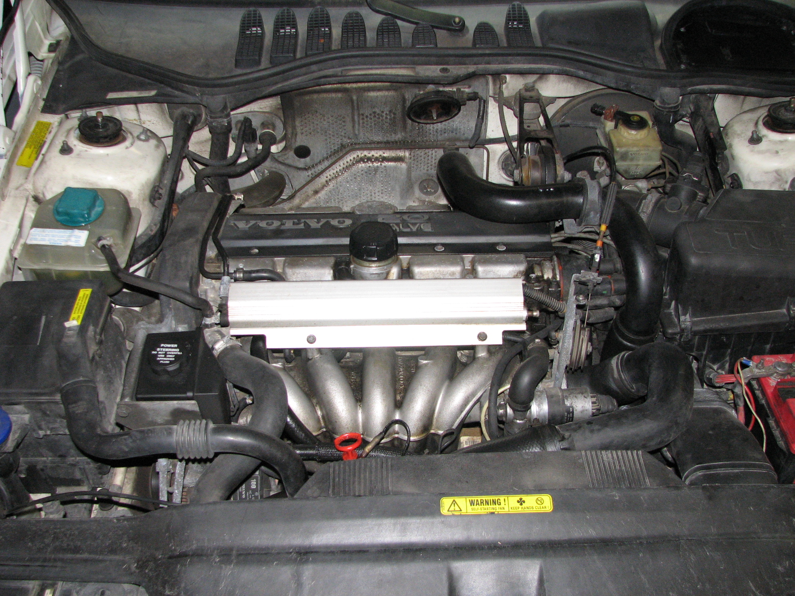

This will serve as the before Photo.
I set up an emergency control center to order a new radiator, and whatever else may come up.

3" air tube, silicone turbo hoses,3" valve body and N/A intake, silicone coolant hoses, thermostat, coolant temperature sensor, installed so far.
Unexpected new radiator as well. There were antifreeze drips on the old radiator and it looked tired.
While I was buying silicone line and hoses, I did the PCV 5/8" to PTC in blue silicone heater hose as well.
