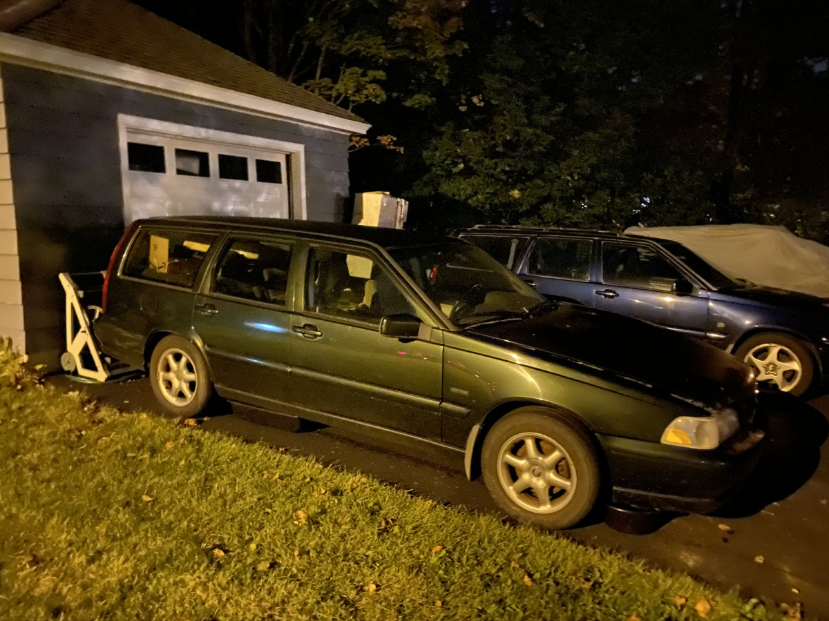

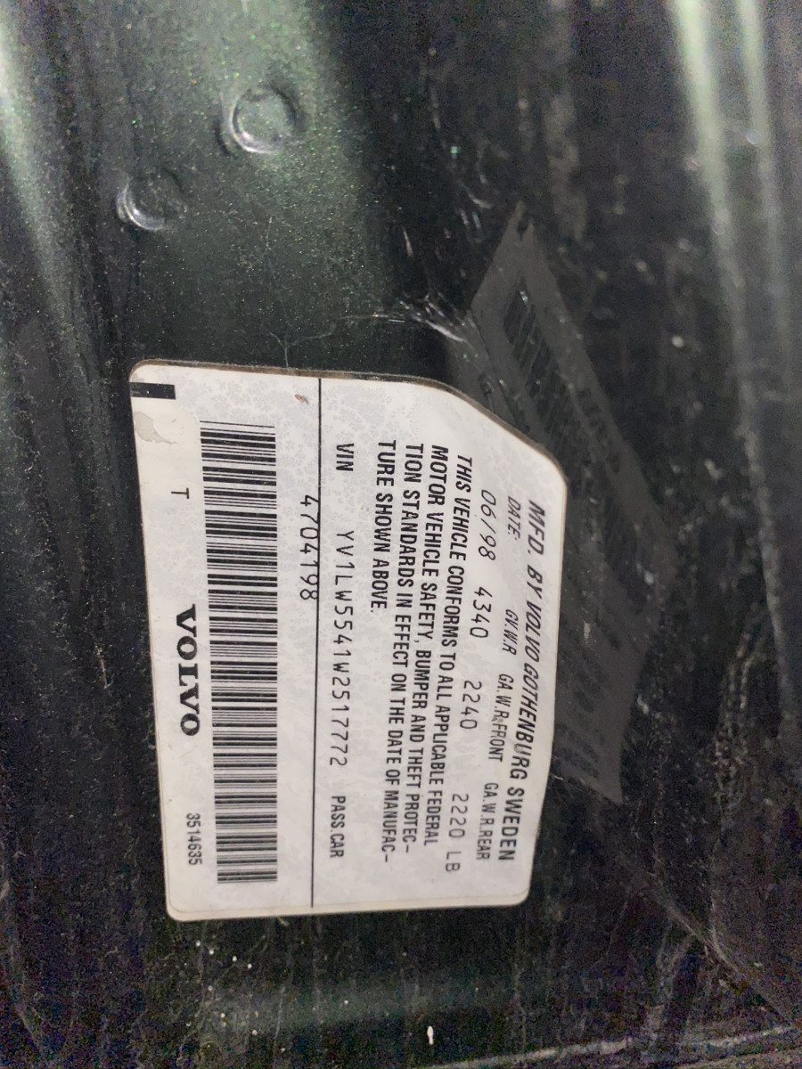

Build date 6/1998. Very late 1998 model...woo hoo..that probably means mechanical tensioner
Engine B5254S serial 1412483

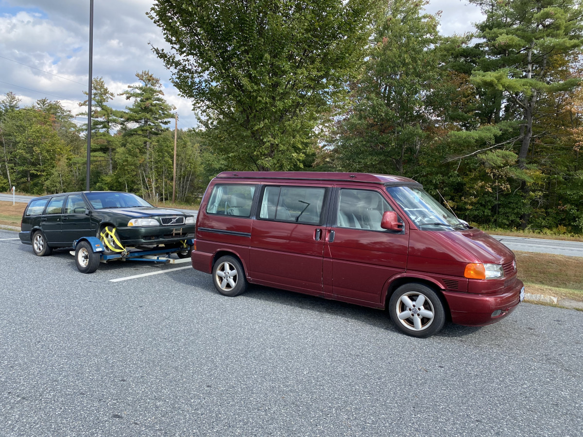

Car recovered from field in VT. Not run in 2 years
180,000 miles SEP 2020
To be evaluated for recovery or parts.
Body damage to left rear fender and wheel arch from rust.
Towed home, installed battery.
Engine starts and runs. No codes.
Idled for 30 minutes, changed oil to Penzoil Dino to remove water
No crank condition, battery drain?
Alternator light came on
Dumped PS fluid
Fuel filter area bad gas leak
Oil seep at cams.
Brakes crusty
Steering extremely heavy, not just lack of PS. Frozen rack?

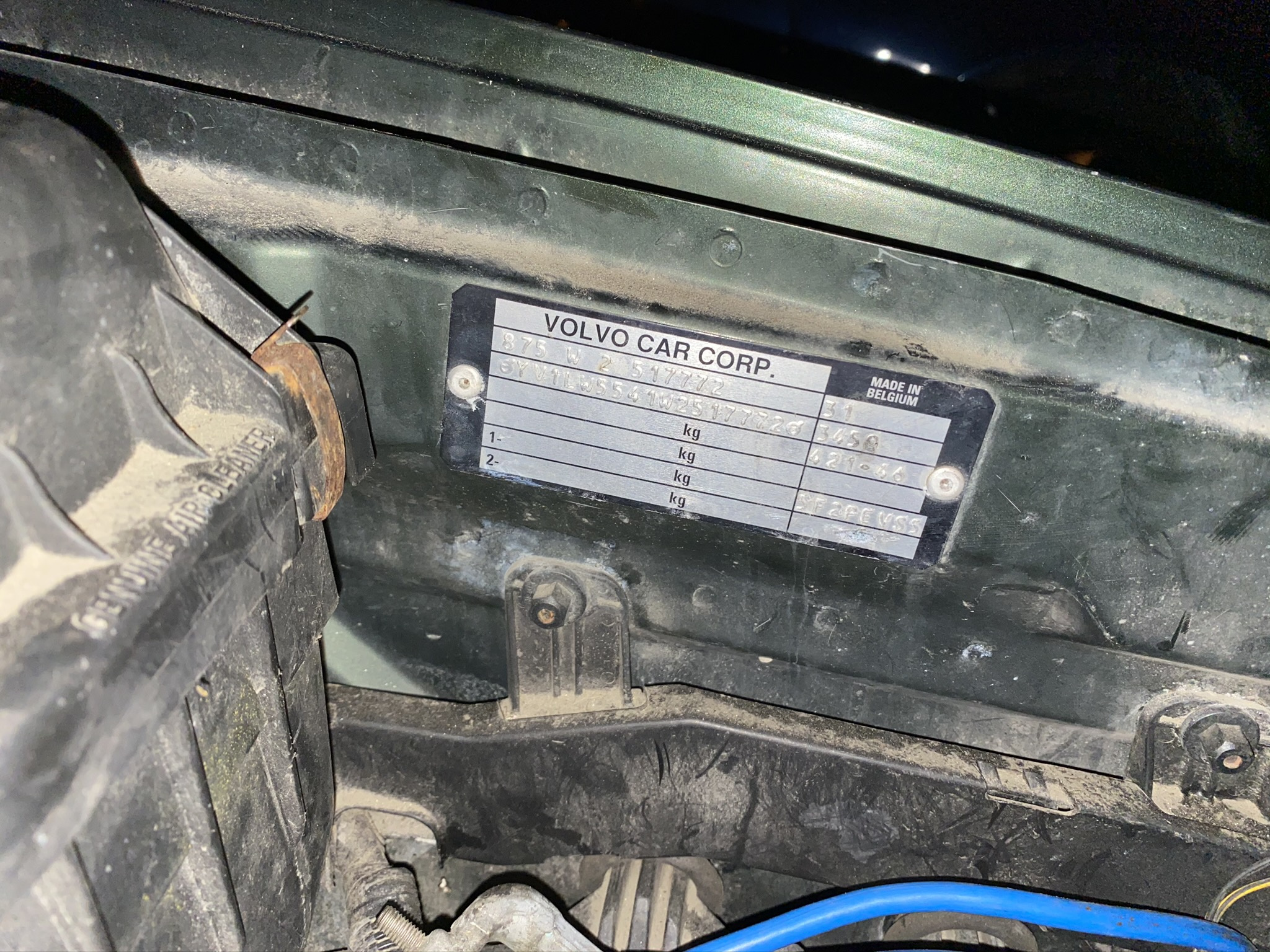

Black Betty 592497 VIN
1998 v70 NA Grunhilde M56 517772 421 green
