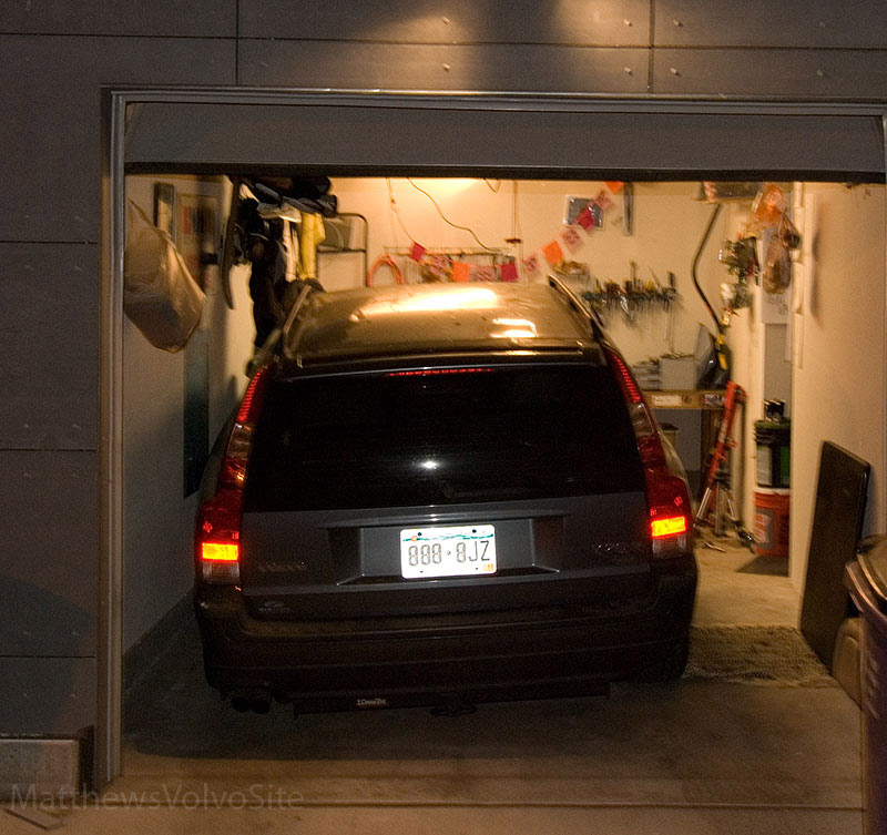

Pfft, small garage.
Air tools were a MASSIVE help when I changed my front axles - getting the axle nut off with just a breaker bar was a huge pain (yes, you'll need impact sockets). I was lucky to have a friend with tools in town then that was willing to help with my then-"new" car.

Don't make me laugh. Your garage door goes WAY higher than mine. And clear the junk along the walls and we're al least on equal footing. With that nice flower bush on the right brightening your day every time you pull in or out, I think you're going to lose this argument

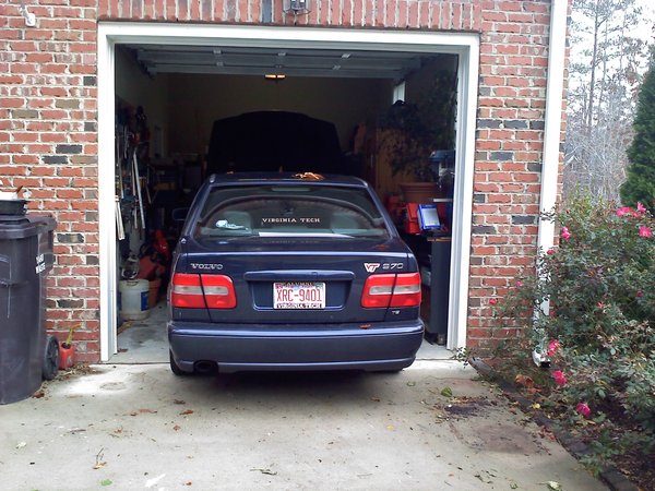

Looking at your garage you might want to consider a horizontal air compressor under the workbench at the far end of the garage.
