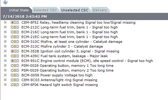

Looks like I got another one. Not my car, a friend of a friend's 2006 V70 (T2 LPT), I was called because they were having trouble figuring it out.
AF codes and high idle (among other unrelated DTCs). It was idling at 900-1000 RPM. It would initially 'try' to idle lower (roughly) but then RPM raised as it richened the mix to attain proper AF based on closed loop.
AT KPII/engine off the throttle plate position was sitting at 14.5%. Mine liked to stick at multiples of ~7% when the internal gears are worn/binding/sticking. This is probably evidence that leans toward a conclusion it's probably how they all act. I left this afternoon thinking he had an intake leak that I couldn't find and recommended arranging for a smoke test, that the 14% might be the ECU opening the throttle plate in preparation for start. Then this evening reexamined my head and checked how the throttle plate acts on mine. No, the ECU does not open the throttle plate at KPII. It sat at 2% on mine unless I pressed down on the pedal.
The interesting bit is that he replaced the TB for a bad position sensor about 6 months ago. Which is why I was wanting to discount the TB as a culprit. He bought the car within the last year. He paid ~$270 for the replacement TB, didn't remember where he ordered it off hand: likely not a Bosch TB, certainly not blue box.
So the 'cheaper' aftermarket TBs don't even last a full year! ..probably my whole point to this post. You just had to wait for it.
Footnote- large evap leak was the hose from the canister didn't get seated/locked into the purge valve fully and came out. And I switched out CP#3 with one of my spares. I made him aware that he needs an alternator rebuild. And lectured him regarding an unknown timing belt at 180k miles. And it's due for a WP soon.

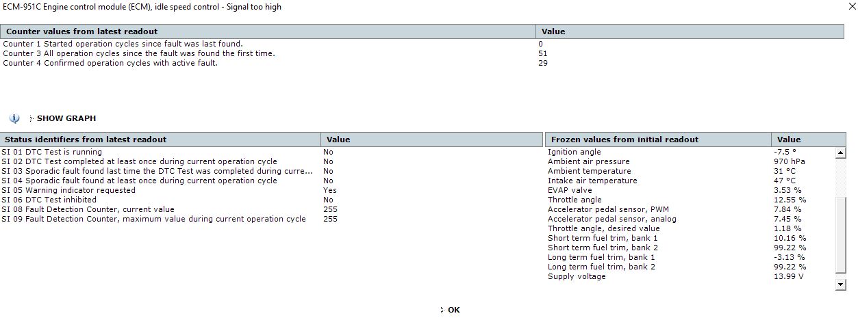

Edit: how bad does this have to get before it triggers ECM-925/926/9270/9280 (throttle angle desired value does not correspond to the throttle angle actual value)? See frame data below to the right. On my car with a good TB, watching live try as I might (pressing the pedal at different positions/velocities) I can't get these two numbers to differ more than ~1%.
