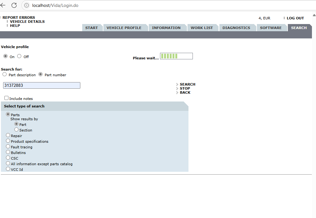

Hello, thanks a lot for the guide. I can get the program running but can not use the search function.. it just sticks to "Please wait..." when i enter a part number. I wonder if there is something that can be done different?
Also under software menu I get this error "Software Download Manager failed to load..."
I attached the screenshot for the first error could you please help?
- Skärmbild 2025-06-19 005403.png (39.82 KiB) Viewed 3956 times

this was the fix "Hello, thanks a lot for the guide. I can get the program running but can not use the search function.. it just sticks to "Please wait..." when i enter a part number. I wonder if there is something that can be done different?jda wrote: ↑08 May 2025, 15:21 Dear sir,
