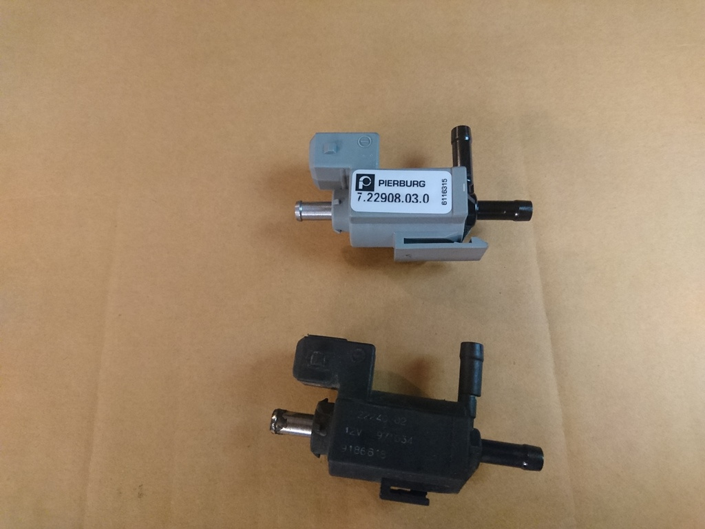

I would recommended the Pierburg "HD" unit which is used on Porsches/Rovers. I build the IPD unit, but I wasn't impressed to be honest.
Pierburg TCV 7.22908.03.0

ndphotonl wrote: 18 Aug 2019, 11:12 I would recommended the Pierburg "HD" unit which is used on Porsches/Rovers. I build the IPD unit, but I wasn't impressed to be honest.
Is there really some internal difference?
I can see its half the price of original black Pierburg unit found on these cars ~15€ gray vs ~35€ black (7.22240.13.0)
Nevertheless i ordered one, and will let you know if it works better. Nice to have Porsche 911GT2 piece on your Volvo :P

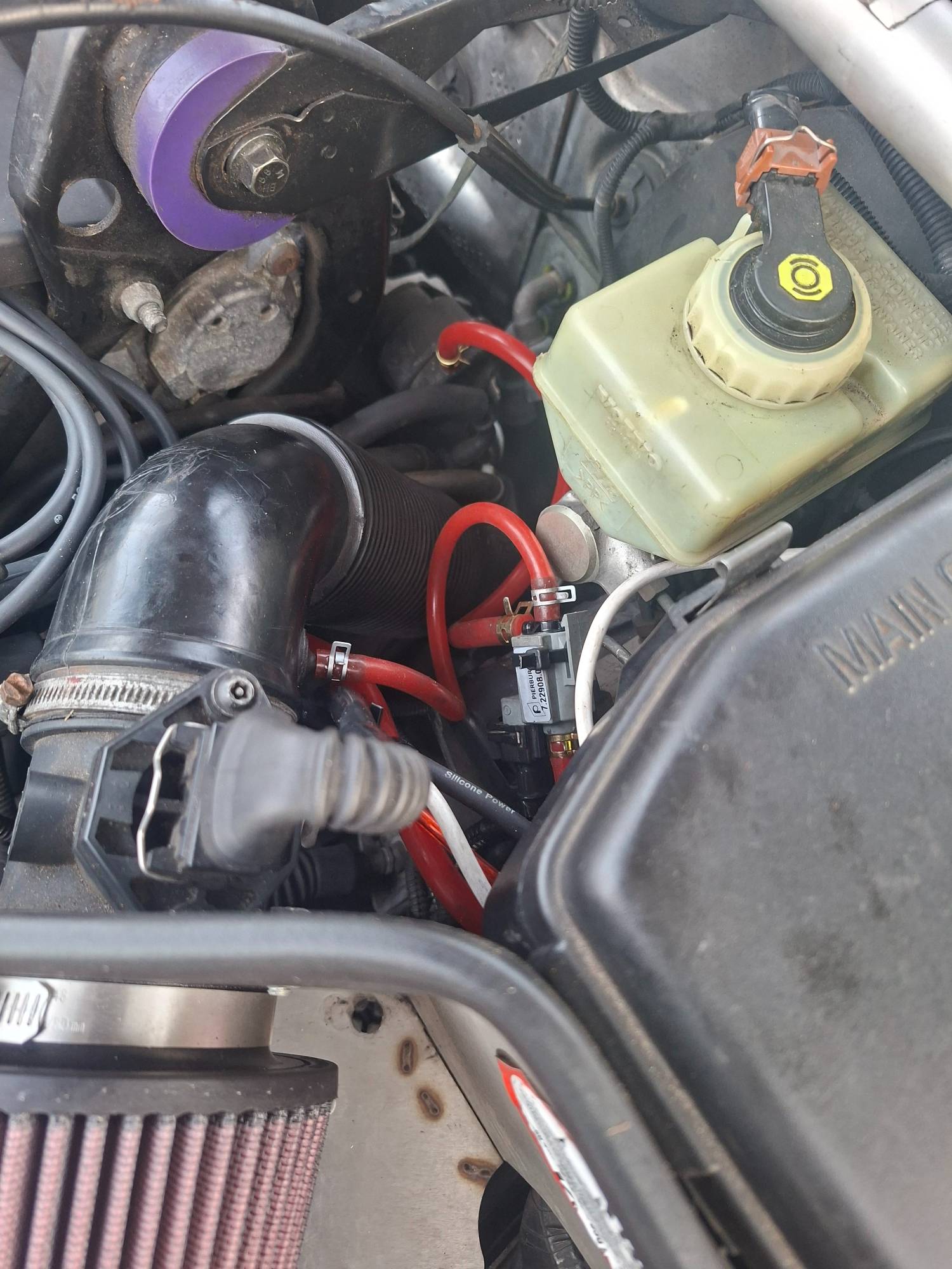

Hey guys! My first post actually! I have been using the forms as a way to get new information and tips and recently my car was having issues with gaining speed, as in, the car would like build pressure and release it suddenly, so driving was not fun and felt very weird. The internet said the TCV seems to be the culprit so I used your tip to use the porsche type, it was 30 euros cheaper (25 vs 55)! I also used new silicone hoses and man it goes again, also the lines where so old and broken, the turbo noice also seems alot peppier! You can see in the photos the new lines and TCV. Cheers!
All new! (The red lines are the new ones)
