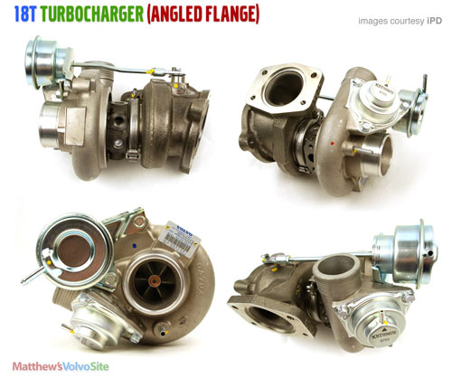

Upgrading a HPT High-Pressure Turbo
R, T5-R, Turbo, T-5 Models
  • 15G turbocharger stock on 850, R, T5-R
  • 16G turbocharger stock on Euro-spec 850 R and 70-series Volvos, except...
  • 18G turbocharger stock on V70 R on model year 1998 and 1999
  • 19G turbocharger stock on V70 R model year 2000
With a slightly lower initial compression ratio the HPT block is well suited to higher boost pressures and more aggressive timing curves as the detonation ceiling is naturally higher than the LPT blocks and therefore power development is much different. The typical upgrade path for this engine is an 18T or 19T although the more mild 16T can be a good upgrade for 850 models that have the 15G installed stock. Since both HPT and LPT models use the same intercooler you can surmise that the lower the boost pressure the better job the intercooler does as the boost charge temps don’t rise so high and the flow so much that the intercooler can’t keep up. That’s why as you look for more and more power from these engines you start to have a number of supporting components that need upgrading.
images courtesy iPD
At the end of the day each has its value and it’s place in the Volvo world. I for one would not trade my 99XC with 16T and Green tune for an HPT in the same car even if the peak power was higher. I need the additional off the line torque to keep the car feeling nimble and ready to ‘pounce’. At the same time I love going for a drive in the 18T 850 with M4.4 Blue tune I have as well... but for an entirely different reason. Get to know the folks in your local Volvo community so you can get to know the different engines, supporting mods, and driving characteristics that each configuration can provide. That will help you make the performance and upgrade choices that best suit you better than any article can!
