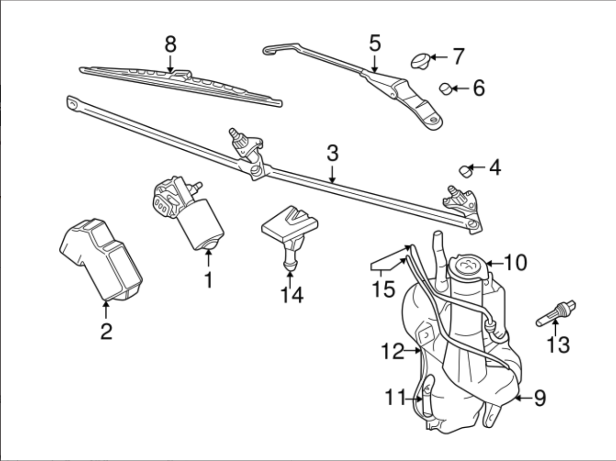

Follow up 4/8/2024:
I narrowed it down to the wiper linkage and replaced it. Due to the age of the vehicle OEM was not an option. I decided to order PROFESSIONAL PARTS SWEDEN from RockAuto. Surprisingly everything fit pretty well. The only thing I noticed was where the wiper motor bolts to the linkage their were no groves just flat metal, picture below for reference of what was missing. The OEM part had the groves on the end of the linkage where it bolted to the wiper motor.
