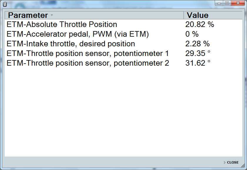

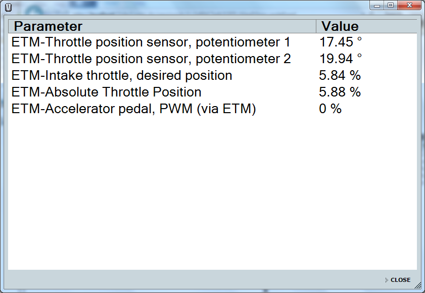

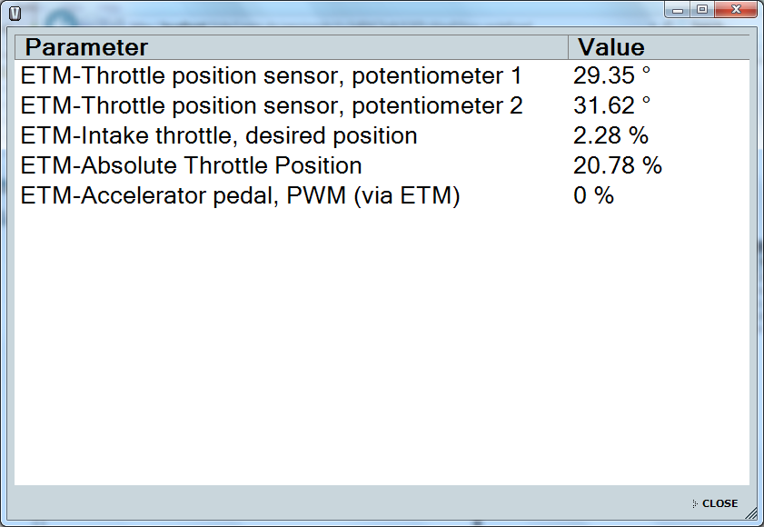

Working my way through solving the two Accelerator Pedal related DTCs. Four readouts of all ETM parameter before removing accelerator pedal this weekend.
Engine OFF, Key POS II:
Engine idling close to 1000 RPM:
Engine idling and settles near 700 RPM:
Few minutes later engine cuts off by itself:

When the ETM on my '01 V70 was dying, it threw a few accelerator pedal-related codes. After having the ETM rebuilt, the accelerator pedal codes went away, so I'm fairly certain nothing was wrong with the pedal or pedal sensor in my case. I think it was just one way the ETM tried to interpret the data it was seeing.
I also frequently saw the absolute throttle position at 20% when the car was in limp mode.

IF Limp Home is a "SAFETY" feature THEN something is triggering ECM-9180: Accelerator Pedal Fault -- limiting power to gas pedal.
VIDA's ETM test procedure says something like "a 13º (%) angle difference requires replacing throttle module". I'll try ETM test tonight.
