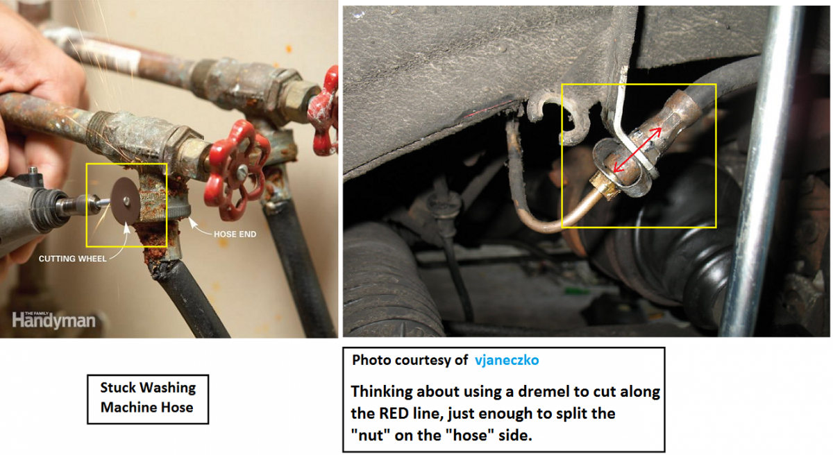

xHeart,
I admire you for doing the flare in situ.
It is hard with the Neiko tool on the bench, let alone in situ.
Anyway, although I have not tried the following trick yet, I have posted in forum in the past.
Hopefully someone will try and report back.
Let's say you heat the junction with propane torch (open the bleeder screw a bit to allow expanding brake fluid to escape) with NO success.
Now you had to cut the line and did the flare (which is a pain).
In order to avoid doing the flare, what if you use a fine dremel wheel and SURGICALLY cut along the RED line very very slowly, just enough to use a screwdriver to crack the nut a tiny bit to widen it and release the bolt (the bolt is on the metal line side).
You don't want to damage the bolt threads.
Once the nut side is split a bit, the bolt simply unscrews easily.
Here is a diagram to illustrate my idea, on the LEFT is stuck washer hose removed by dremel.
On the RIGHT is my idea of using dremel.
BTW, the small slit you cut into the mounting bracket has no consequence, the new brake hose simply slides through the bracket's round hole.

Thanks! Someone at MVS once quoted Vince Lombardi "Winners never quit and quitters never win".
Cutting along the metal nut on flex hose should work fine even if the flare gets little brushes. In my several attempts to use flare wrench the junction bracket moved, copper line twisted etc. But found there was ample copper material to refurb and flare.

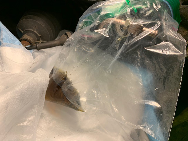

Once removed, the old passenger side caliper drained close to 10ml from the bleeder hole while on the bench, in prep for core return, where the driver's side caliper did not have any fluid come out of bleeder hole or the flex hose connection. Is this unusual, what failed? At times applying brake will turn the driver's wheel with less than firm grip on steering wheel.

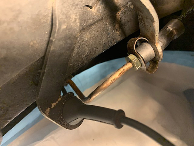

Thank you. Mityvac method was a success. No visible fluid leak. Here is the junction after the surgery, and now in recovery -- test drive next.
