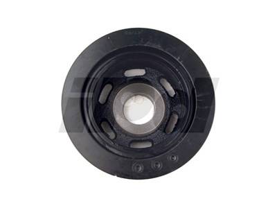

Notice the thin black stripe in the middle the silver balancer, that is the rubber bushing I am referring to. Notice the black balancer is volvo and the rubber bushing is located between the belt pulley and the crankshaft pulley portion of the balancer assembly. So worn rubber will allow the outer belt pulley to move out of intended position hence wobble. June
