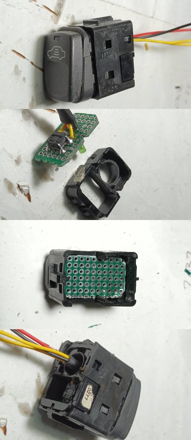

I think i used a dremel like tool. however this is my current mod project, getting OEM switches to work as on/off. I got the feel of the button as close to OEM using the original silicon boot they use on all switches apart from the audible click from the reverse mounted tactile switch. This particular switch will be used to open /close the garage door (we right hand drivers didnt get homelink) . I have another switch for my TPMS and im working on a third that will control a latching micro relay (ie turn on and stay on) for my front mounted camera.
OEM switches modification

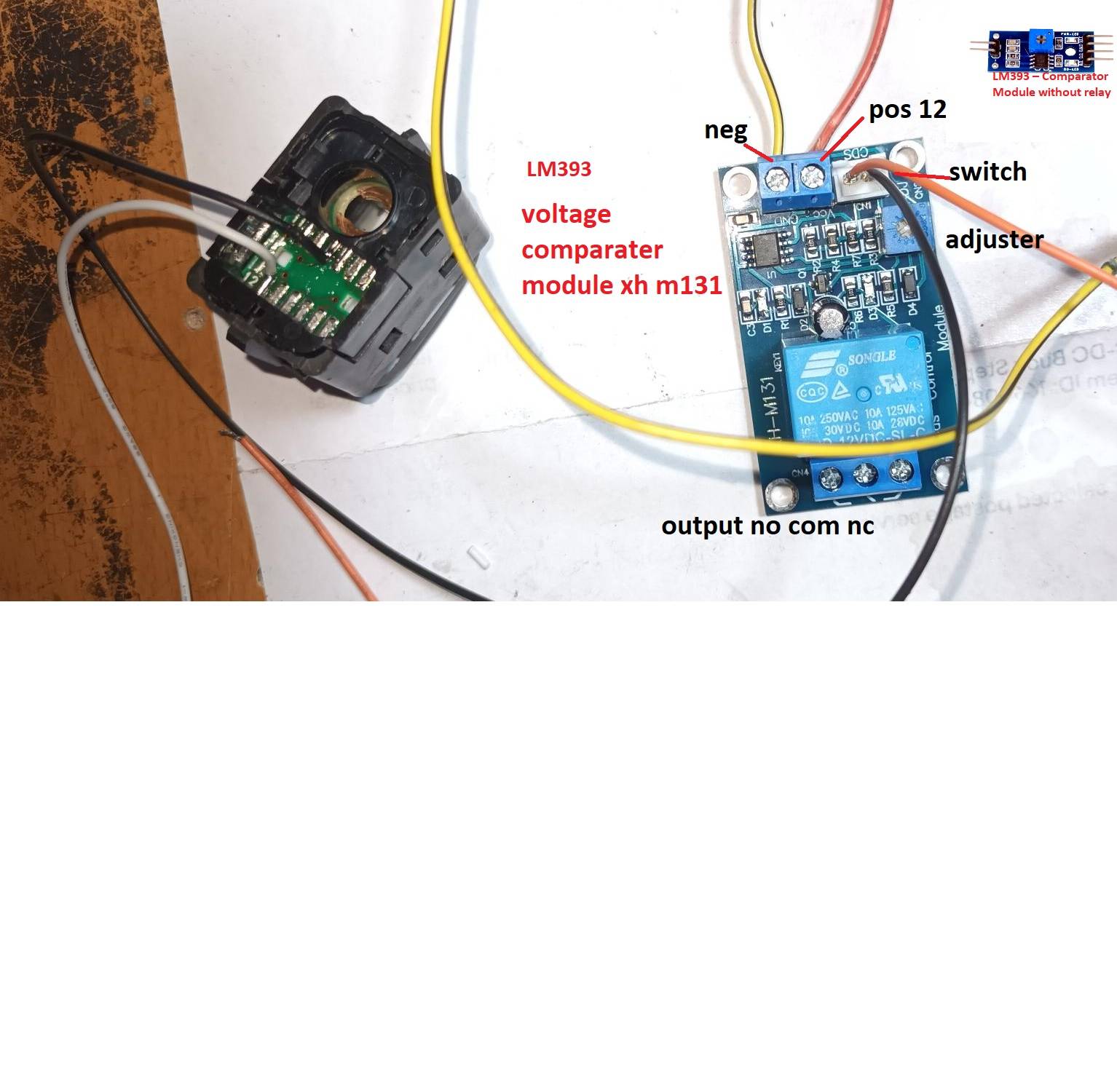

How to get a factory ECC switch to operate aftermarket accessories, using a modified switch connected to a LM 393 voltage comparator module. Basically the module detects a change in voltage as set by the user.
LM 393 to detect volvo switch
VOLVO P2 switch mod
VOLVO P2 switch mod
volvo p2 switch mod.jpg (61.94 KiB) Viewed 527 times

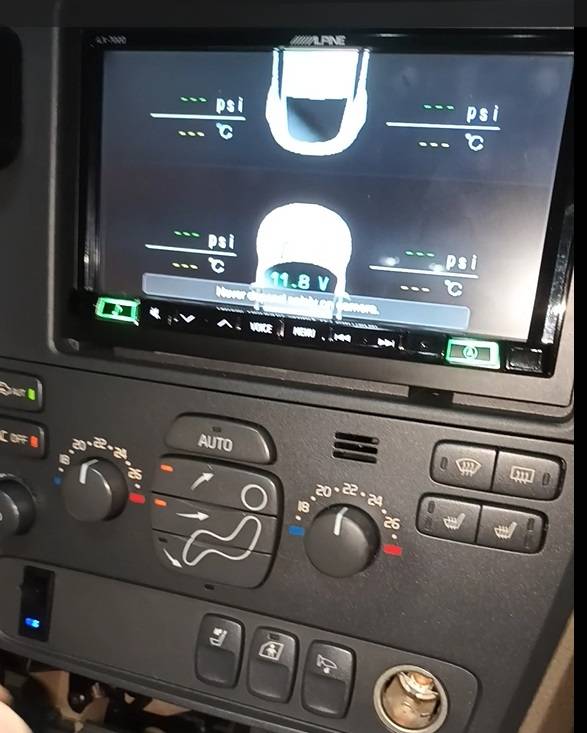

TPMS on/off switch
TPMS on/off switch
ive added a TPMS on/off switch for my aftermarket setup. I had contacted some businesses that laser etch (same method used on OEM switches) and most said no but one said they could try, was too expensive so i had some vinyl stickers printed. looks better than that generic switch.
