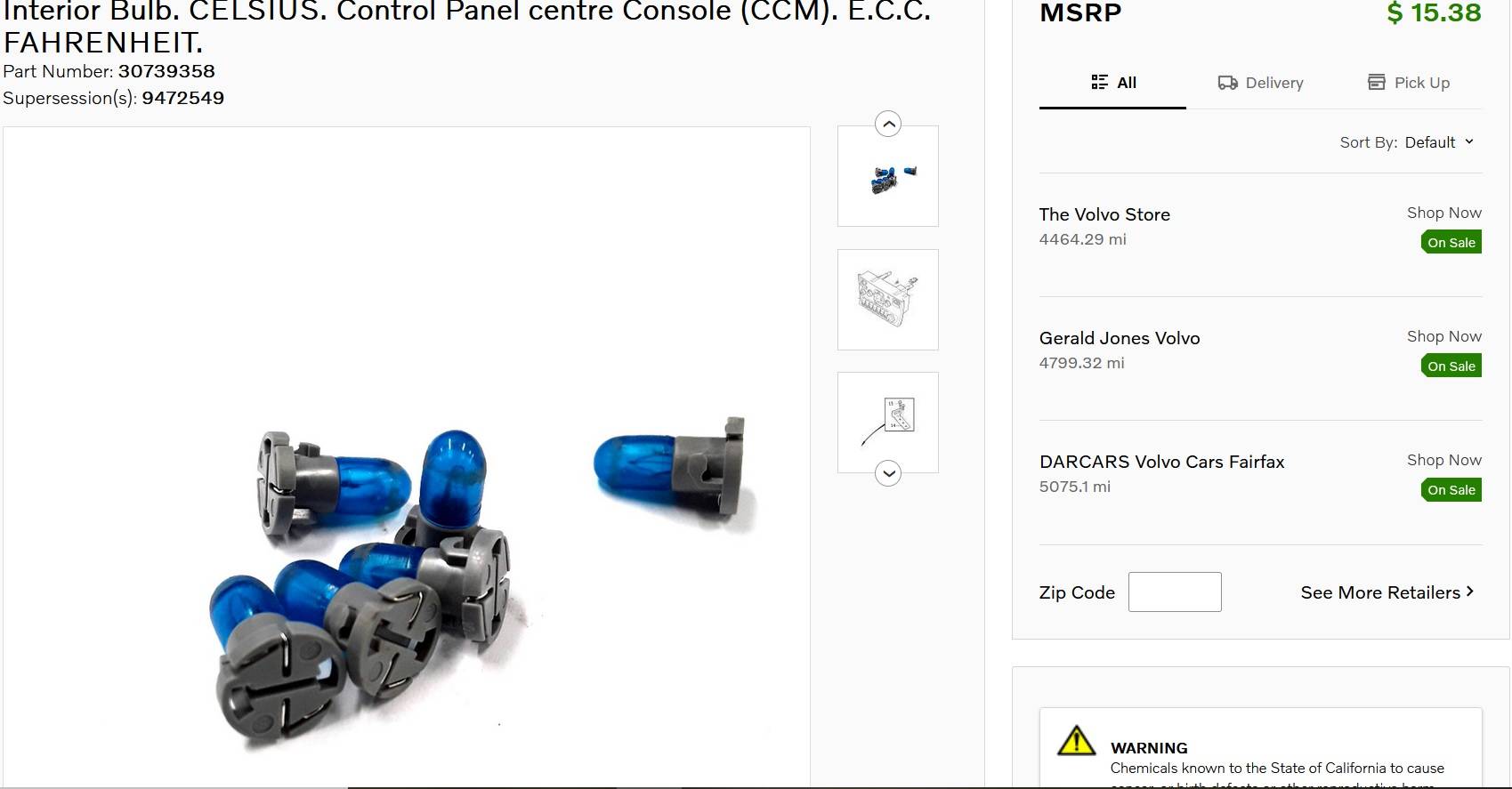

i found this on the Volvo US website, is the image mis-leading? is it $15 for 6 bulbs+sockets or 1?
CCM bulbs
CCM bulbs
Vova585
Posts: 558
Joined: 18 March 2023
Year and Model: 01v70xc,2016xc70...
Location: Rochester,NY
Has thanked: 155 times
Been thanked: 141 times
Post by Vova585 »
I think it is misleading. It says "interior bulb" and not kit, set, or in description says includes 6...it is price for 1 bulb as i see it.
erikv11
Posts: 11800
Joined: 25 July 2009
Location: Iowa
Has thanked: 292 times
Been thanked: 765 times
Post by erikv11 »
Yeah I interpret the text "interior bulb" is correct not the image. Given that FCP sells one bulb for $12 USD that fits pretty well. But that is for sure the right part, FWIW.

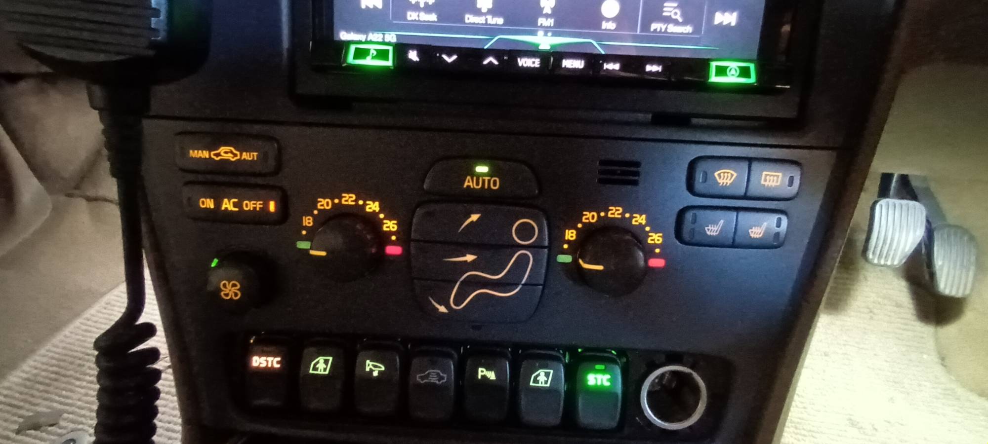

Thanks for the replies, i have a few ECC's a spare so i will check them.
I'm not going to preach the benefits of LEDs over incandescent, but if you spend time in the car waiting like i do, running the battery flat can happen as all dash lights stay on with accessories ignition. Plus the heat issue that incandescent have.
The instrument switch is set to lowest brightness.
DSTC is a Optosupply 3mm 12V warm white diffuse flat-top resistor LED Rated at 750mcd at a 140° viewing angle. OSM5DK3HE2B-12V
the child lock mirror and parking are same LED but with blue covers.
STC is a Optosupply 3mm 12V green diffuse flat-top resistor LED Rated at 1120mcd at a 140° viewing angle. OSG5DA3HE4B-12V
Note: the two child lock (hostage) switches both work but only in that position.
Ive found it difficult to find Warm white LEDs from the major parts suppliers, they can be found online but always super bright.
