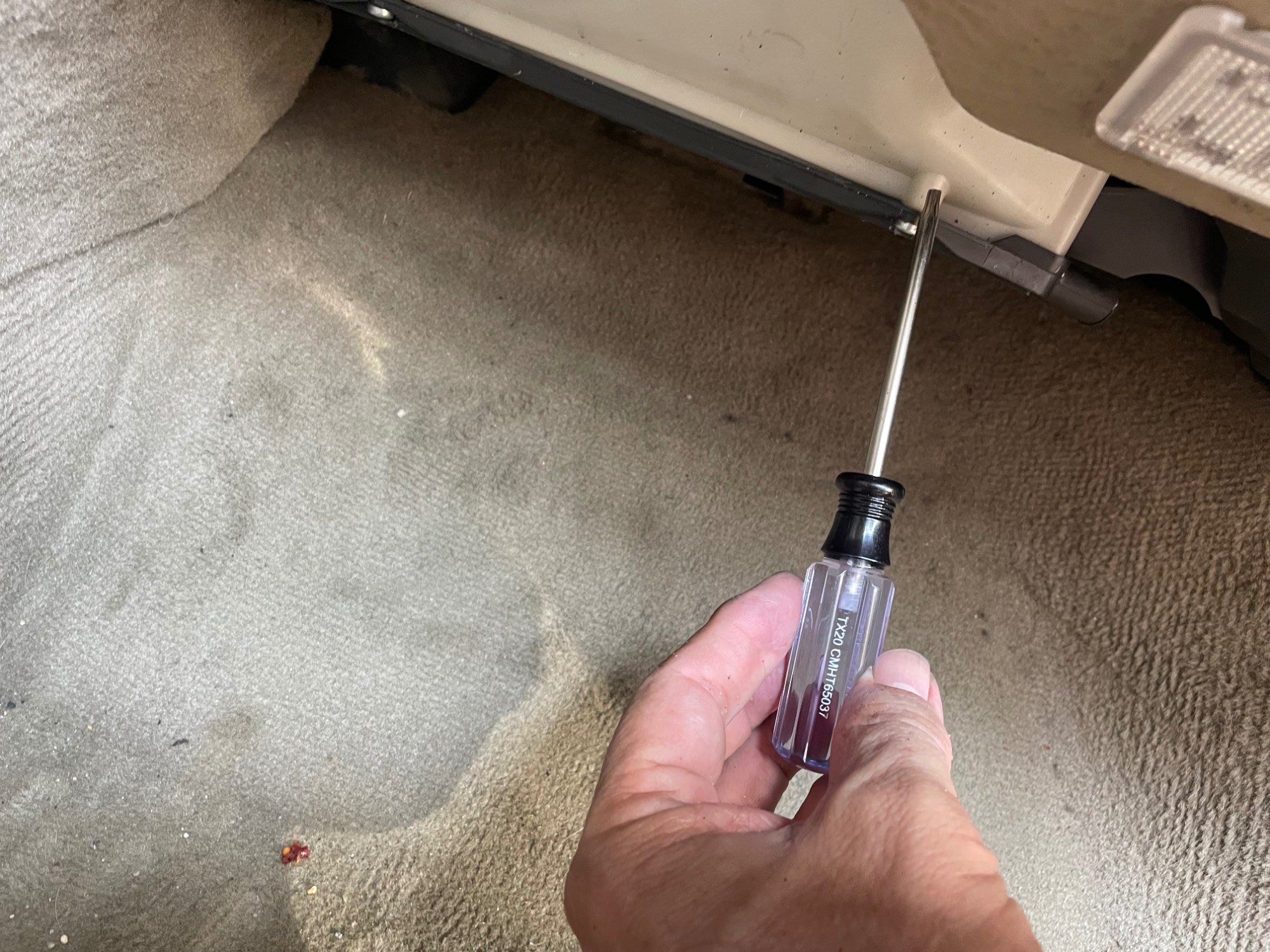

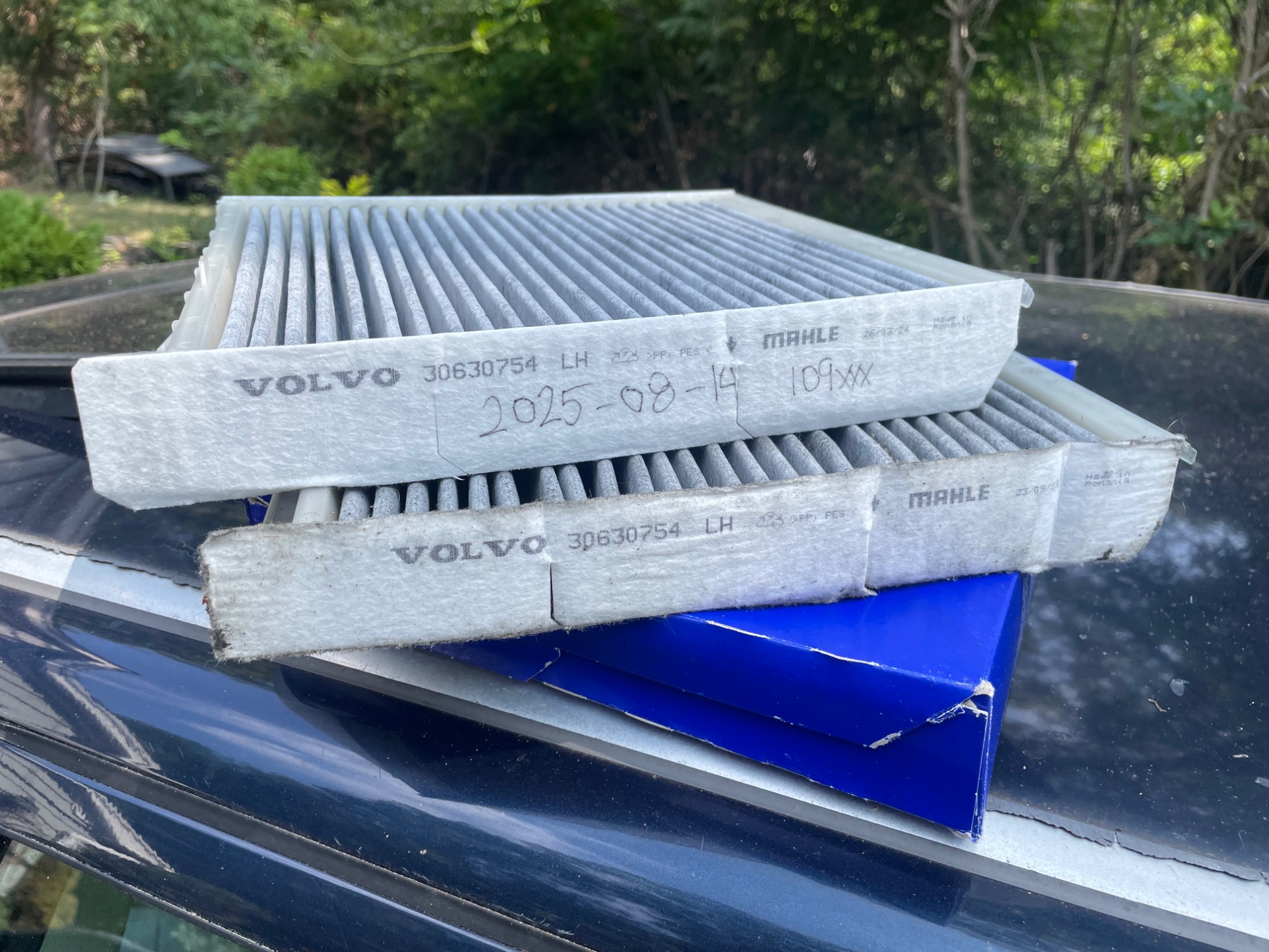

P2 cabin filter change. T25 and T20 needed.
Front T20 is bad access , had to use a cranked T20 key half turn at a time.
