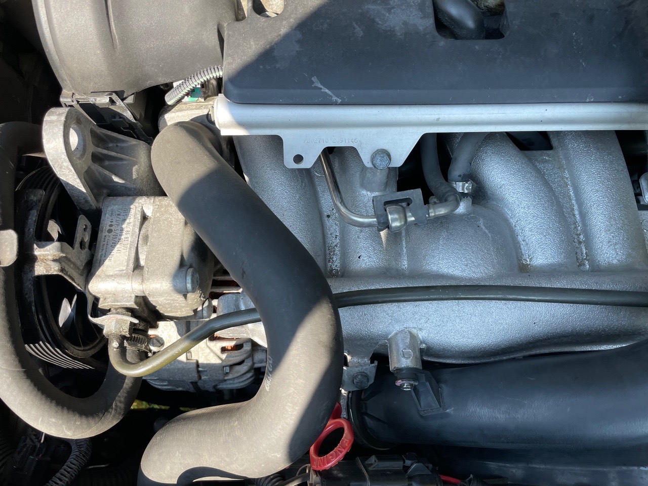

My wife has a 2002 s60 with a bad alternator (getting a message claiming 'electrical system needs service'). I put a new regulator from IPD on the existing alternator and the same message appears. I have a 98 T5 950 with a blown engine. Will that alternator work as a replacement?

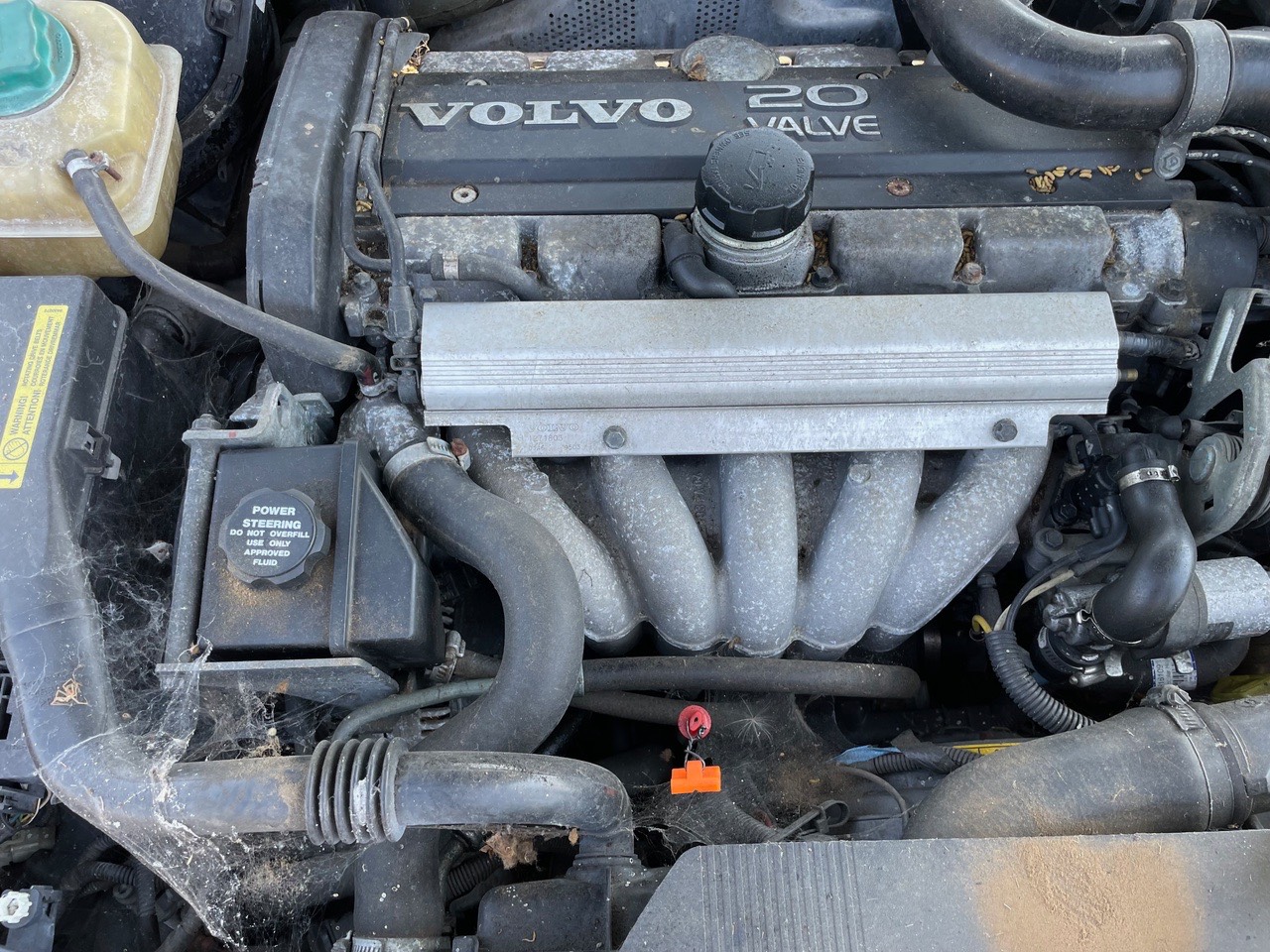

photo of the 850 alternator:

The P80 -98 alternator as cn90 says rotates the wrong way unfortunately. Belt routing is also different.
- Posts: 35267
- Has thanked: 1497 times
- Been thanked: 3809 times
Mounting bolts amd hardware on the RN block, from 1999- , are completely different too.
Other than spatial, mechanical, and electrical differences, they are identical. The colour is a bit different too.
