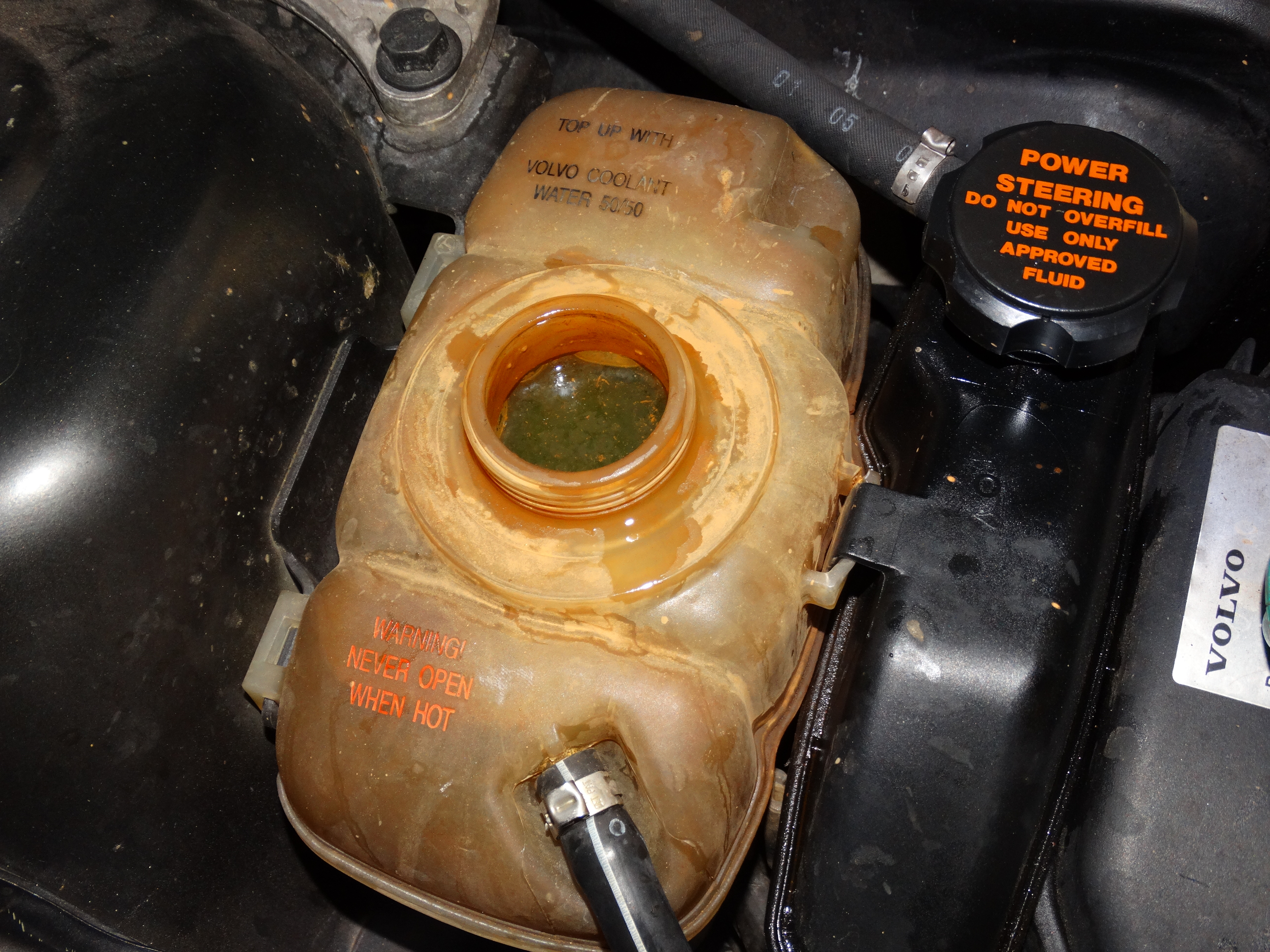

On the times i've had to refill the coolant while hot it bubbles over and it has allowed me to see this residue (also you can see junk in the liquid itself)
This isn't oil that has made it's way into the coolant system is it?

215tkm on a well maintained Volvo engine is barely broken in, is there coolant in the engine oil pointing towards a possibly bad head gasket? If not, check your transmission oil, you could have a bad radiator allowing bleed over between coolant & ATF, also if you can't find any leak in the engine bay, check for moisture in the footwells, your heater core o-rings should be coming due if you haven't done them yet, not sure which side the leak would be on a right hand drive.

Two common issues are the coolant reservoir gets cracked and leaks/bubbles, and the transmission coolant line brakes inside the radiator allowing transmission fluid to mix with engine coolant.
Of course, the head gasket could also blow if the car overheated - such as due to a stuck thermostat.

Yes, it would look somewhat milky. I can't really tell much from your picture in terms of oil, but the dried overflow looks actually rusty to me, though it's an aluminum motor, on the right side of the motor, so if you stand in front of the car behind the motor towards the firewall, there is some steel coolant piping with a drain cock for the coolant that's in the engine, it's factory zinc plated, but on the original motor of my '01 with then 270tkm it was pretty rusty on the outside, if for a longer time there has been just water in your motor it could be a reason for the rust in your coolant & the piping could possibly be rusty to the point of leakage.
