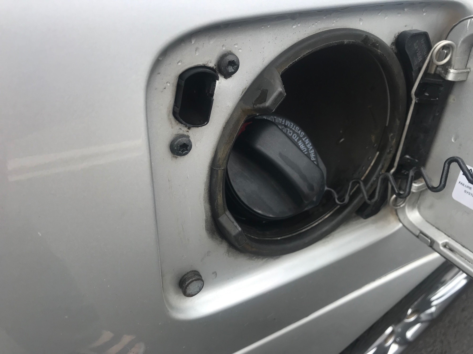

- The black plastic tabs that hold the spring break frequently. The part is not expensive, about $15 at Volvo dealer.
Replacing it is simple (search youtube for tricks). For me, $15 is not an issue...the issue is why replacing it when it can break again?
- Magnet is a great solution.
- In some posts, some people drill through body metal, I don't like it b/c of risk of rusting later (may or may not be important).
- My solution is very simple:
* Go to your local roofing/gutter company and ask for 2 sheet metal screws, these screws are galvanized and should not rust (or you can paint them with black paint when you are done).
* Drill 2 pilot holes toward the front of the car as shown, this way the screws do not pierce the body work.
* These screws work perfectly b/c once they are about 3-4mm into the plastic, they hold the spring against the plastic frame.
* Note the orientation of the spring: the "short ends" go inward.
* I added a bit of grease where there is movement.
- That is it folks, it is a FREE fix! It works perfectly...and I think it looks fine from a cosmetic standpoint...

Post by cn90 »
Long-term report four (4) years later, the 2 screws still work fine. Zero issues.
FREE mod...

Post by cn90 »
So...the 2007 S60 had a brand-new Genuine Volvo Door Mount installed in 2023...
Exactly 1 yr later, the 2 tabs broke!
Bad engineering...
So the 2 new screws fix it.

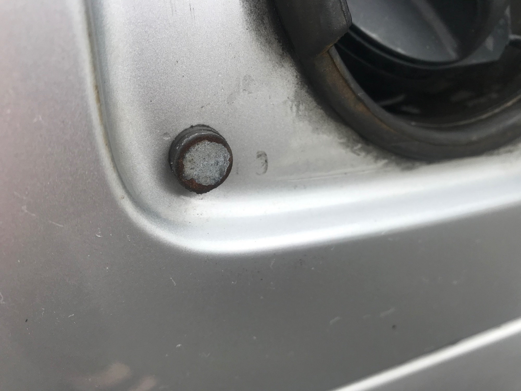

Also the original fix in this post from 2018...
Six (6) years later still fine...

Post by 6ark695 »
After the second bracket broke again this is what I did to solve the problem.
Got the strong pull magnet from HFT and installed it. Since 2018 still worked til now.
Hope this helps…
