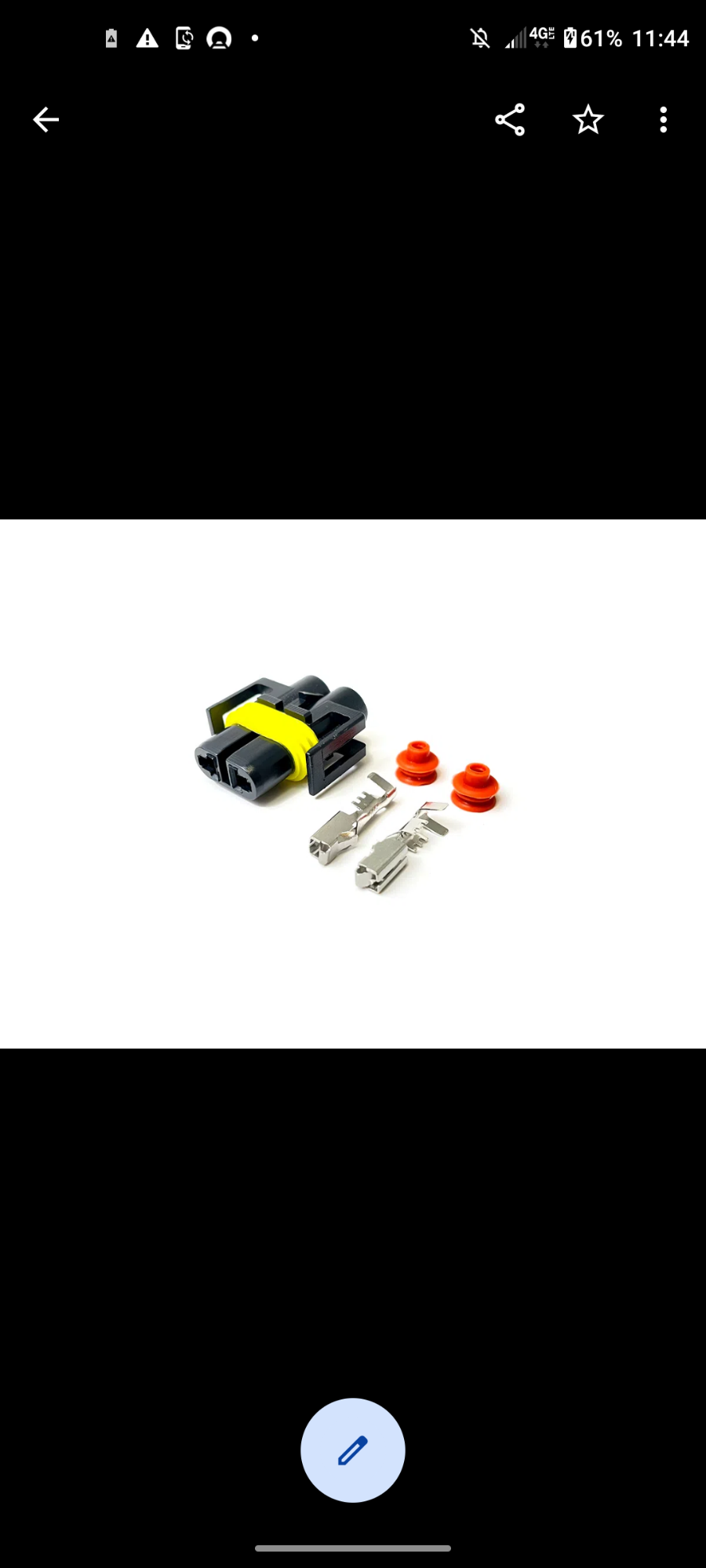

The inner workings of H11 connector...

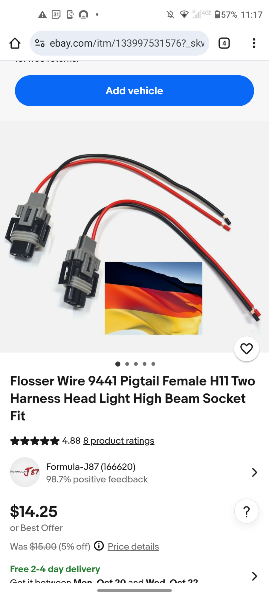

Update on the 2006 S60 with H11 bulbs...
- As jimmy57 said above, you can simply use the standard female connector individually. Just find a connector that
fits inside the H11 bulb itself.
- I decided to go with Flosser 9441 (you can use Flosser 9448 too)...About $14.25 on eBay shipping included.

- On the H11 bulb trick: if you look from the Passenger Seat, looking directly into the light assembly, then line
the H11 bulb at about 4:30 position and twist it to about 6:00 or 6:30 position to lock it in place. Attached is a
generic H11 setup used in many many cars so you can see...

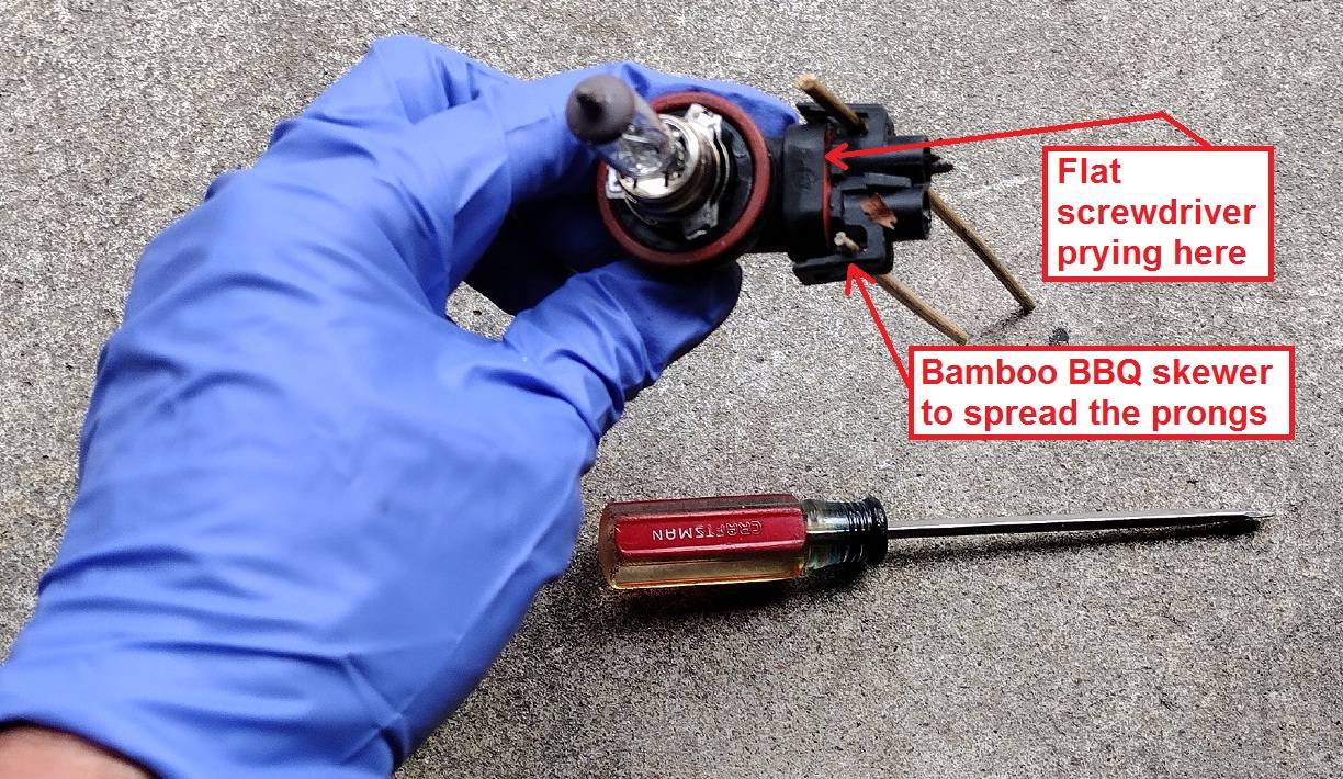

PS: The Volvo H11 bulb is notoriously difficult to remove from the connector in situ. Trick: keep some
BBQ bamboo skewer sticks and a small flat screwdriver in the glove box together with H11 spare bulbs.
This way when you are far away from home, replacing the H11 bulb is easier. Just use the BBQ bamboo
sticks to help spread the prongs while you use the small flat screwdrive to pry the old bulb out.
