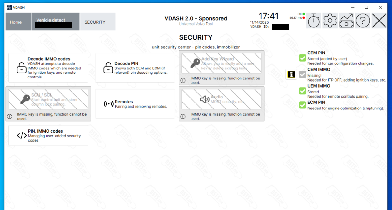

vtl wrote: 14 Nov 2025, 08:59 VDASH and some other software can synchronize CEM and ECM for you. You need just the CEM pin for that, which you already have.
Alright, thank you a lot, you already helped me understand these things a bit better.
However, I worry just a bit, because in VDASH, two days ago, I already tried decoding these IMMO codes:
After doing that, it decoded the UEM IMMO, whatever that is, it didn't decode the CEM IMMO though.
After clicking on the i next to that message, it brought me to this page:
My engine should be supported though, as it is the B5244S:
Am I missing something or is this how it is supposed to be?
Sorry if this doesn't belong to the original question, but then please direct me where I could ask this or who could answer me.
