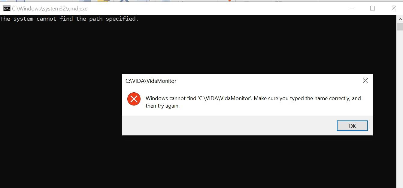

I thought it would be a good idea to remove that button cell battery on my WIN 7 VIDA puter, in hope the date would remain the same. But computer didnt like that idea and took me hours to figure out how to re configure the BIOS. Ive tried loading VIDA on this WIN 10 puter but gave up.too complicated.
When i tried to run this file it came up "virus alert blocked"
04 file error malware warning
04 file not loading.jpg (45.58 KiB) Viewed 164 times
Then it was cannot find monitor
cannot find monitor
cannot find monitor
VIDA on WIN10 not working
VIDA on WIN10.jpg (48.63 KiB) Viewed 161 times
