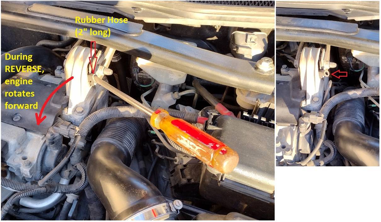

Jimmy57 is correct,
The 2006 S60 2.5T with 102K...
Vibration during REVERSE but not during Drive.
Upper Torque Mount is bad, the fore part of the rubber is cracked.
I don't have time for the proper repair, so this ghetto fix, which turns out very good --- > Vibration is gone.
Just get a piece of rubber hose about 2" long.
Size of rubber hose is similar to the index finger, probably trans cooler hose
left-over that I have lying around.
Wet it with some water or WD-40 and pinch it abit so it is obloid in shape, then push it in, leaving a bit
sticking out as a reminder for later.
Move the mount a bit to make space for the hose to go in.
For now, it is a good fix for me, and it is FREE!
During REVERSE, the front tires rotate backward, but the engine rotates forward (basic law of Physics 101)
into the void, thus the vibration.
The rubber hose occupies this void and it is fine now.

In fact,
If you are short of budget, you can remove the existing mount, cut some rubber hose and fill
in the gaps, then reinstall it. The void in the rubber hose acts like a cushion.

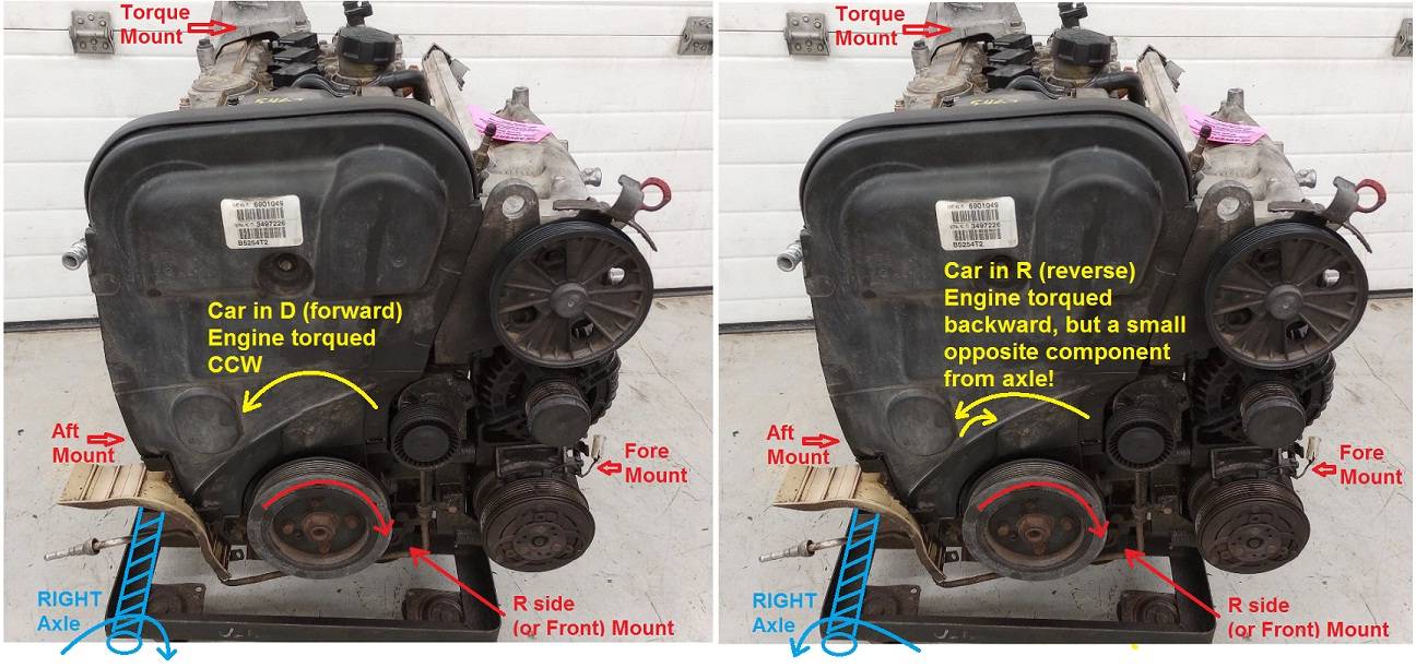

Now,
Let's say you check and/or replace the bad mounts (5 total) and still have vibration in REVERSE...
There is an old Newton Physics law of "opposite force"...or Newton's 3rd law of Physics.
So if you have replaced the mounts and still have vibration only during R (reverse) and the car otherwise
drives smoothly in D, I'd say live with it.
I have sketched a diagram so you can see...
- In DRIVE, the axle spins CW, the engine torques backwards or CCW.
- In REVERSE, the axle spins CCW, the engine still torques backwards or CCW, but there is a component
produced with the axle trying to spin CCW (thus geneating opposite engine torquing in CW manner: the small
yellow arrow). This creates a fight between the crankshaft torque and the axle torque, thus the vibration
during REVERSE.
Don't you love Physics?
