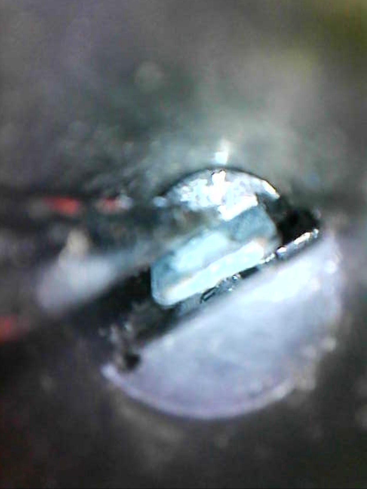

I have been working on this for about 5 hours and I cannot get the airbag clips to release on either side. It looks so easy in the videos.
There is a metal clip. It looks like the screw driver goes on top of the clip and then you pull up on the screw driver which pushes the clip down. I finally pulled out the small Boroscope camera and took some pictures.
The first is the clip by itself.
The second is with the screw driver under the clip which doesn't look right. The screw driver is really fuzzy.
The third is with it on top of the clip but I can't push it down very far or at least not far enough to release.
What am I doing wrong. I need a new steering wheel control module and need to get to the part number.

I have followed that procedure and watched numerous videos on it and have been prying up on it for hours. No exaggeration.
I can't tell where the screw driver is supposed to go. Does anyone have a picture of the tabs on the back of the airbag itself that go into the holes. If I can see the tabs then I think I can figure it out.
What I am struggling with is in my pictures you can see a steel tab. The screwdriver can either go under the tab or on the top of the tab. I have had it in both spots with no success but if I knew whether it is supposed to go under the tab or on top of the tab then I know what to do and be patient with.
There is a foam 1/2 moon in front of and under the tab which blocks the screw driver from going in too low. You can see it in my pics.
If you look at the last pic the screwdriver is on top of the steel tab and there is a gap below the steel tab between the tab and the 1/2 moon. Does the screwdriver go there instead of on top?

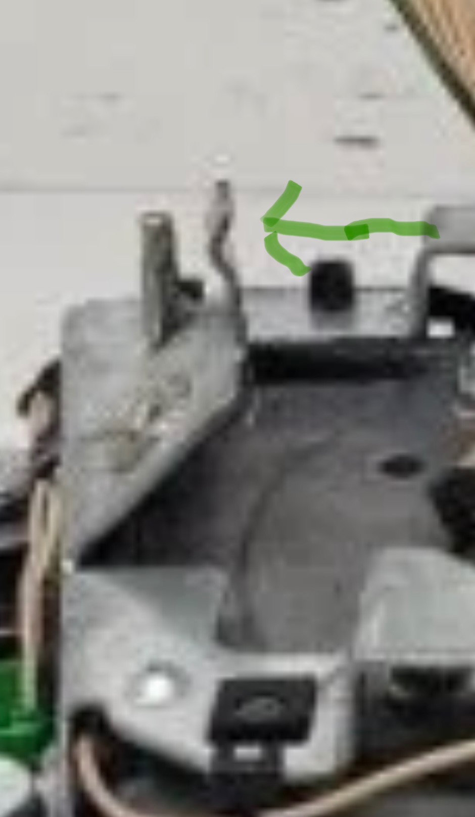

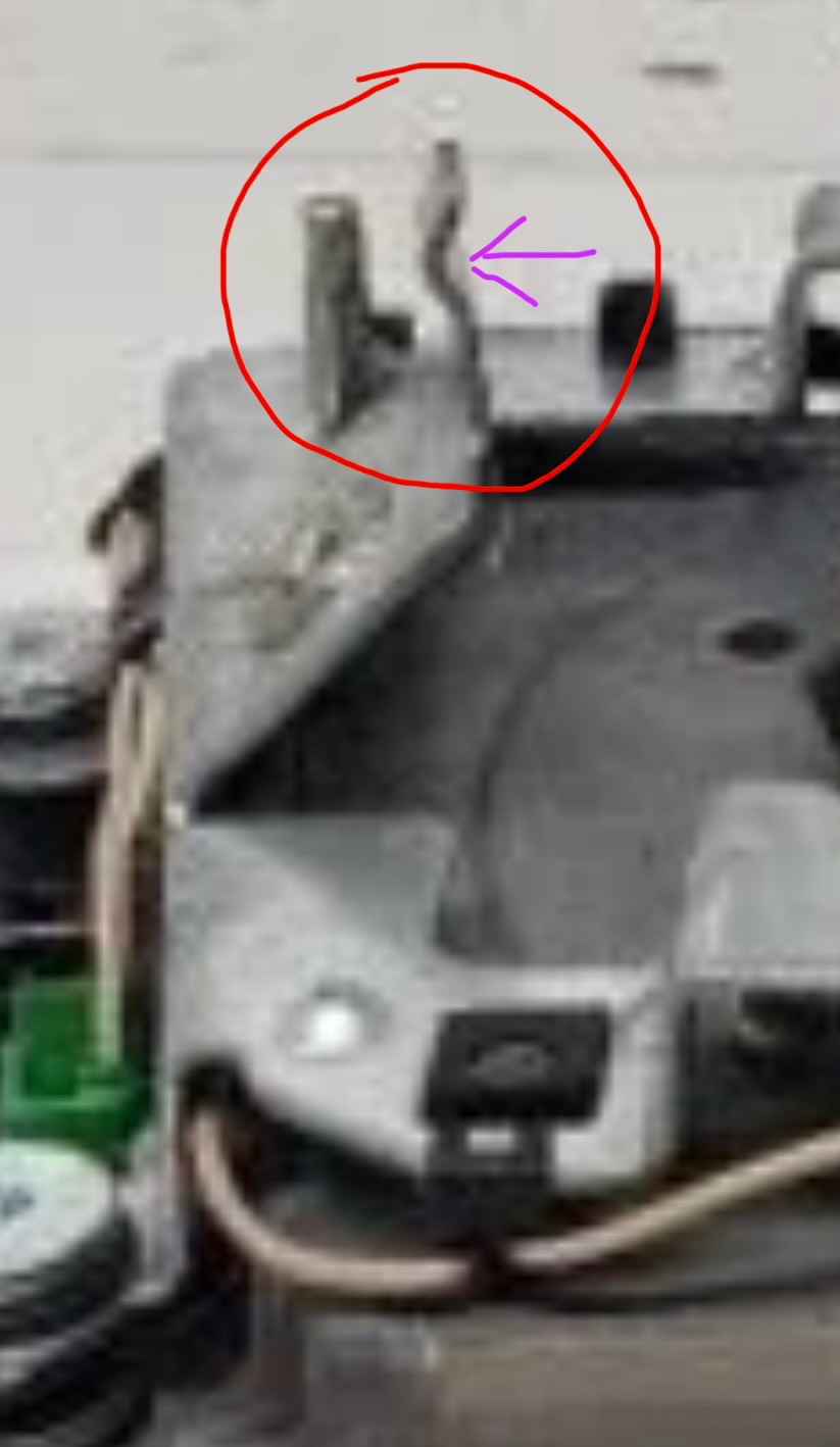

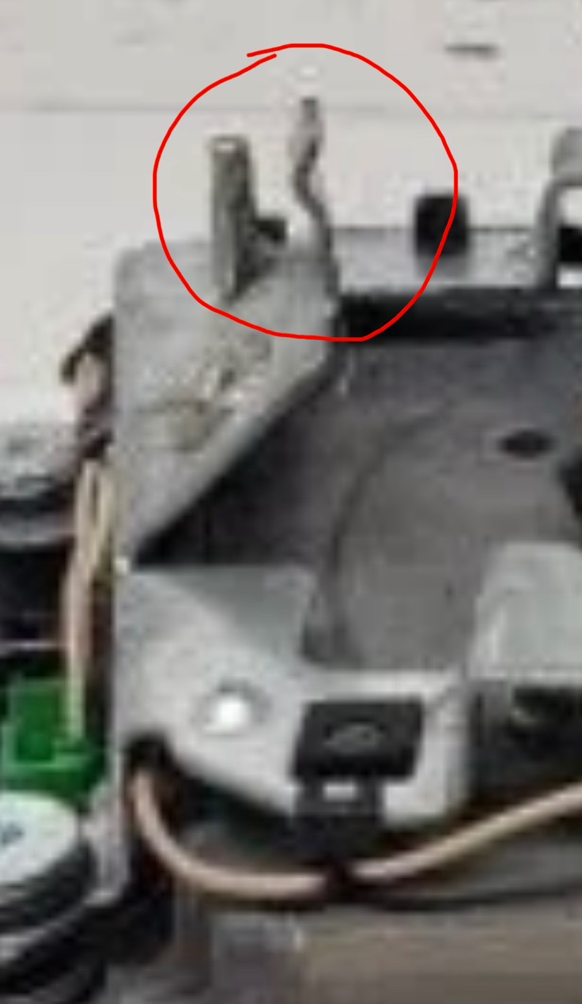

Here are some pictures with the back of the airbag explaining my question better.
Picture 1. Circled in red is the tab that comes through the hole. The question is which direction does the tab move to release the airbag.
Picture 2 with the green arrow Shows putting the screw driver UNDER the tab and prying up.
Picture 3. With the purple arrow shows putting the screwdriver on the top of the tab and prying up.

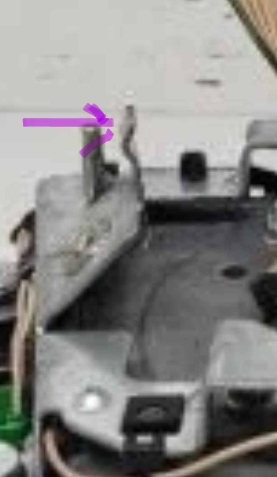

@Blacklab467 That is super helpful. Now I understand what piece needs to move BUT
Can you do me a favor and look closely at these 2 pictures. I have seen the airbag with a post with a notch in it that the spring lever drops into but there is no tab like mine on the back of the airbag...it looks like mine is different?
Does that tab need to move down to get under the lever in your picture?
I also posted a video of an S60 which is a different airbag, but the same principle and there is no steel tab. 3:20 on the video is where it starts. There is a post as opposed to a tab.
Picture 1. The airbag steel tab circled. Does that lever fit into the area on the tab where the purple arrow is pointing or does it go over the top of the tab and click in behind it.
Picture 2. Seeing that tab through a camera poking through the hole.
I can't figure out whether to get under that tab or over that tab to get to the lever in your picture.
