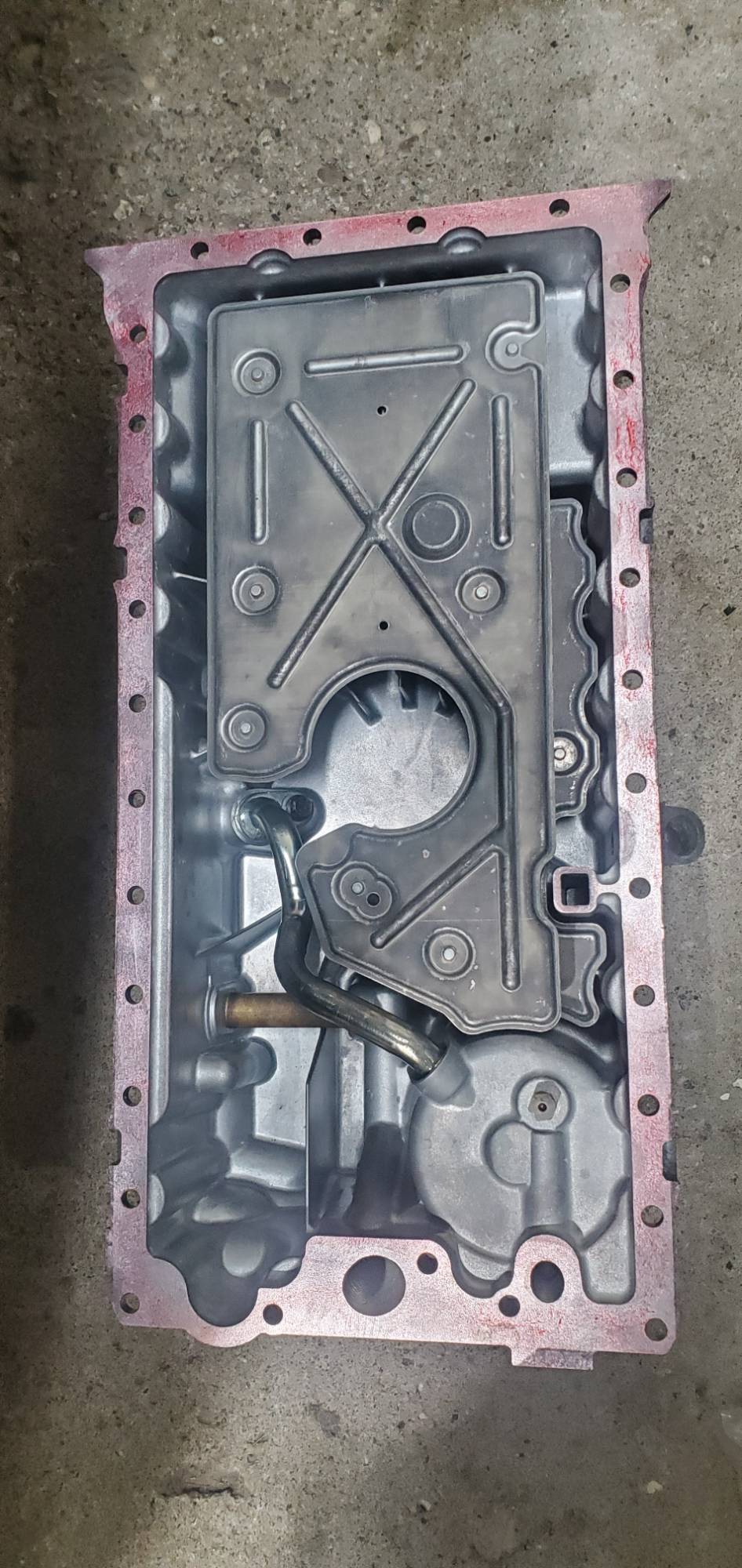

I use a razor blade to scrape all the old anaerobic sealant off the aluminium pan and block before applying the new sealant with a touch-up roller from Home Depot. I squirt the new sealant right onto the aluminium from the anaerobic sealant tube and then use the roller to spread it around for a consistent red surface. Here is a picture from right before I reinstalled the Ti S60's oil pan:
I also use a bit of the anaerobic sealant on the two o-rings to hold them in position while installing the oil pan.
The oil pan was also cleaned in an ultrasonic tank to get all the oil and sludge out. The ultrasonic cleaning doesn't remove the old anaerobic sealer - that was all elbow grease with the razor blade.

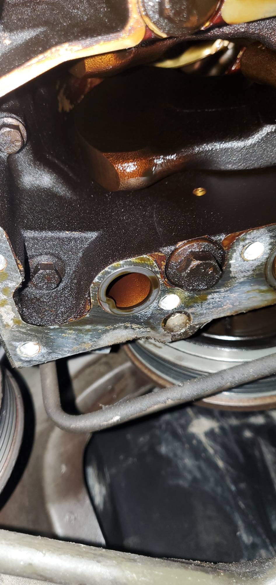

Another potential problem is if the o-rings don't stay in their grooves or if they buckle. I found a buckled o-ring when I pulled the oil pan off the Magic Blue S60:
This is the other o-ring:
If both o-rings don't stay in position while you are installing the pan, there will be a big oil leak. It will leak because the oil pressure is much higher than the strength of the anaerobic sealant. The o-rings are necessary.
