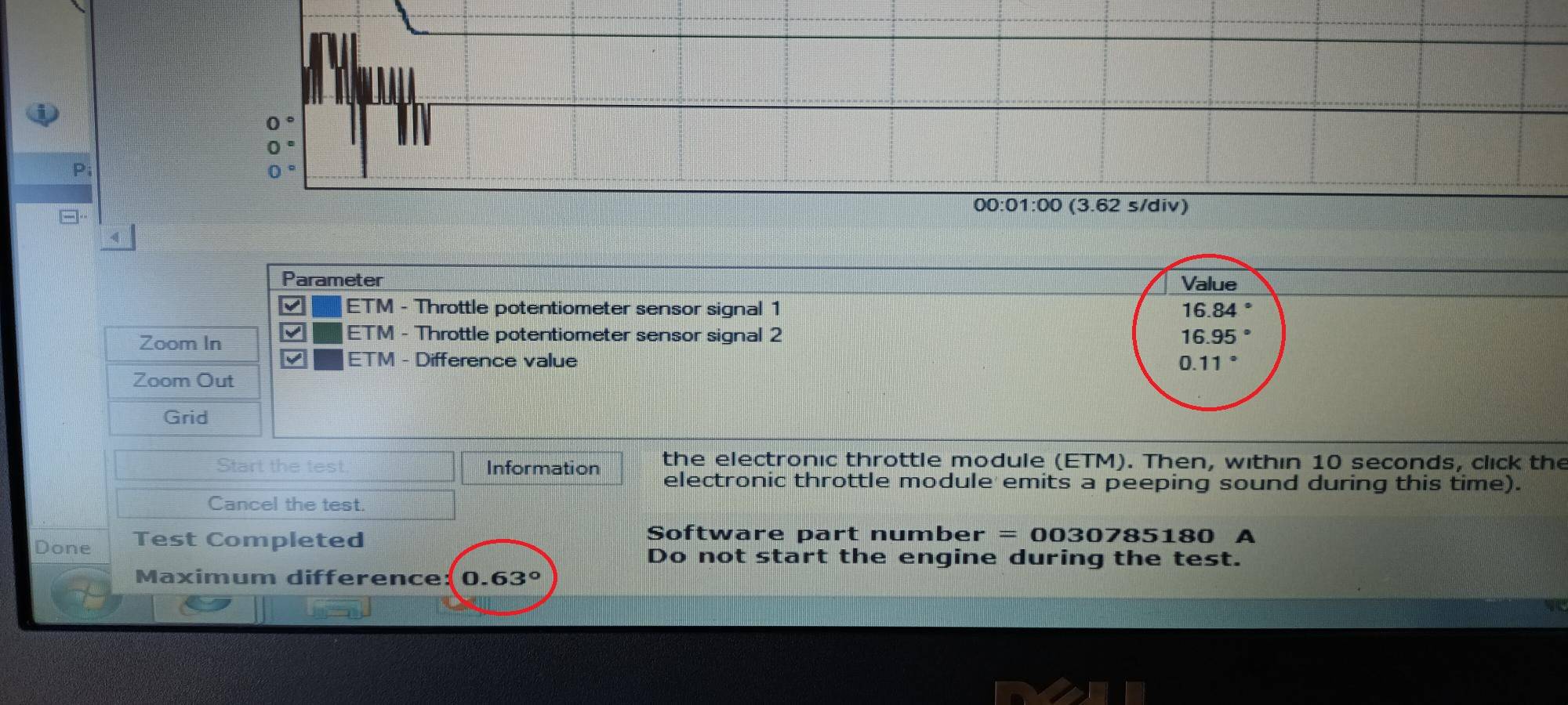

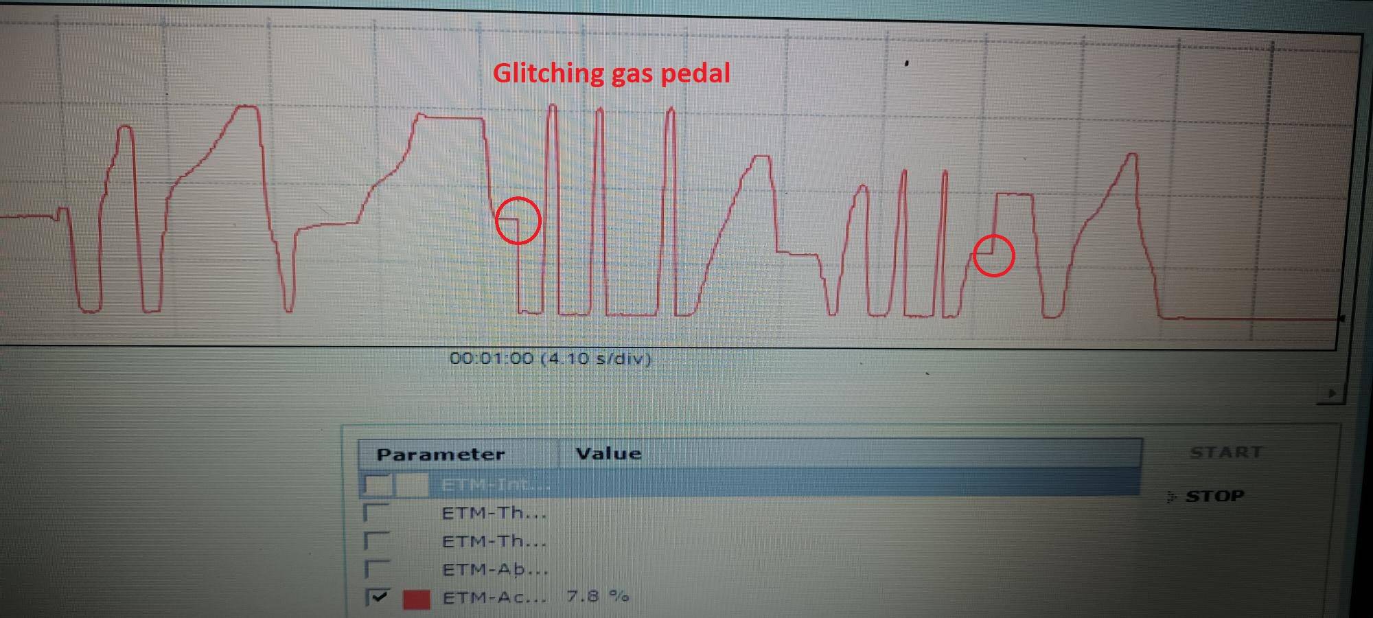

I can feel a very slight hesitation at around 2K RPM most noticeable at lower speeds. Completed the ETM test as well as gas pedal test and noticed gas pedal glitching (freezing) randomly around the 20% throttle area . I previously upgraded from brush to contactless, maybe a cleaning will fix??
ETM test
ETM test
gas pedal glitching
gas pedal glitching
gas pedal glitching

Definitely clean the throttle body. The interesting thing about the second chart is that the throttle plate was hung up both when the throttle was opening and when closing but at two different angle positions. Clean close to the shaft where there is potential for hangups at throttle angles other than fully open or fully closed.
I would try re-running the ETM test with the engine hot if it wasn't already hot for the tests you posted. I would also run the ETM test a bunch of times in a row. The same open/close sweep that you are doing with your foot is happening in the ETM test. One process shouldn't be different from the other unless a different opening/closing speed is causing the fault.

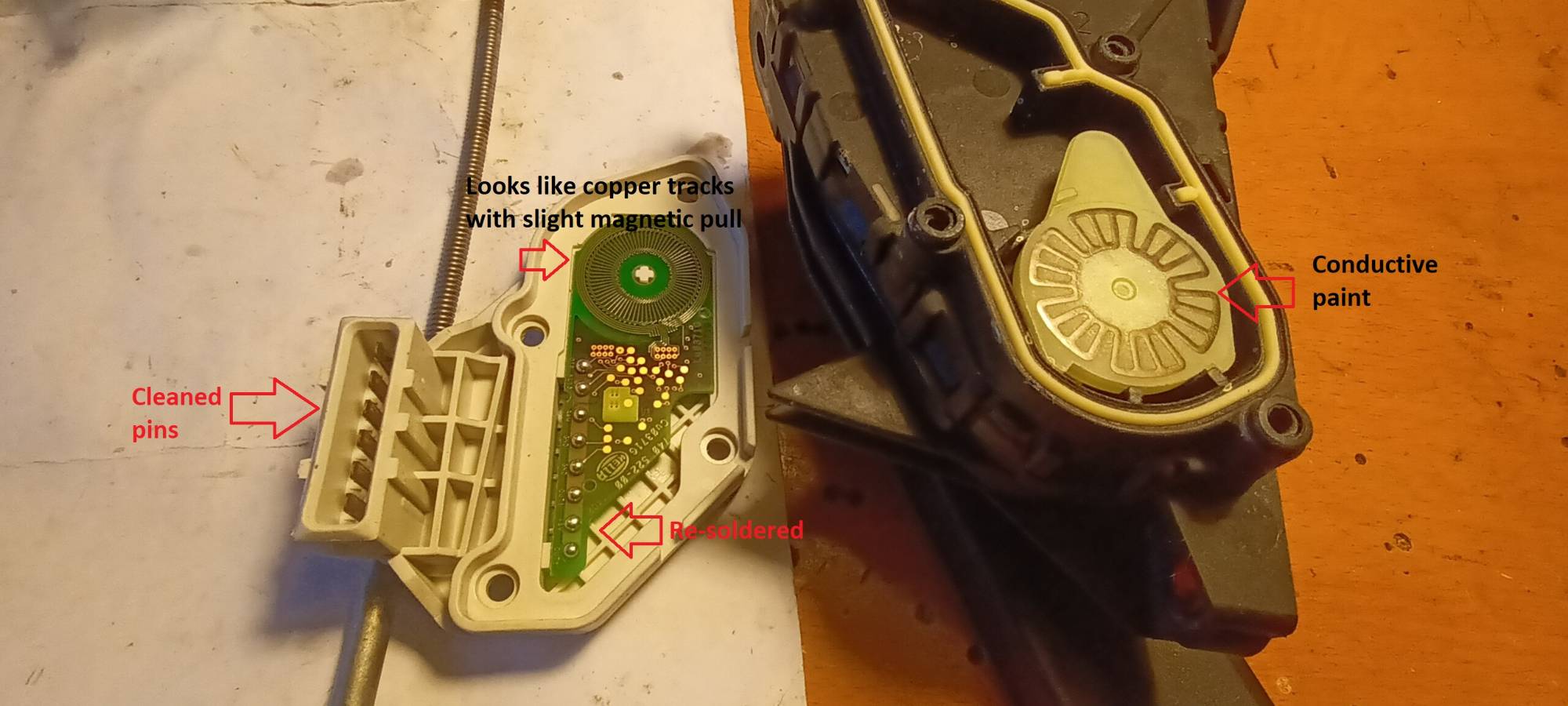

Tool the gas pedal apart but it was pretty clean. Part numbers are interesting on these apparently same part number has different mountings, Looks the the design changed in 2009 does the pedal pivot or is it fixed?? ..
gas pedal service
gas pedal service
pivoting pedal 2009
pivoting pedal 2009
