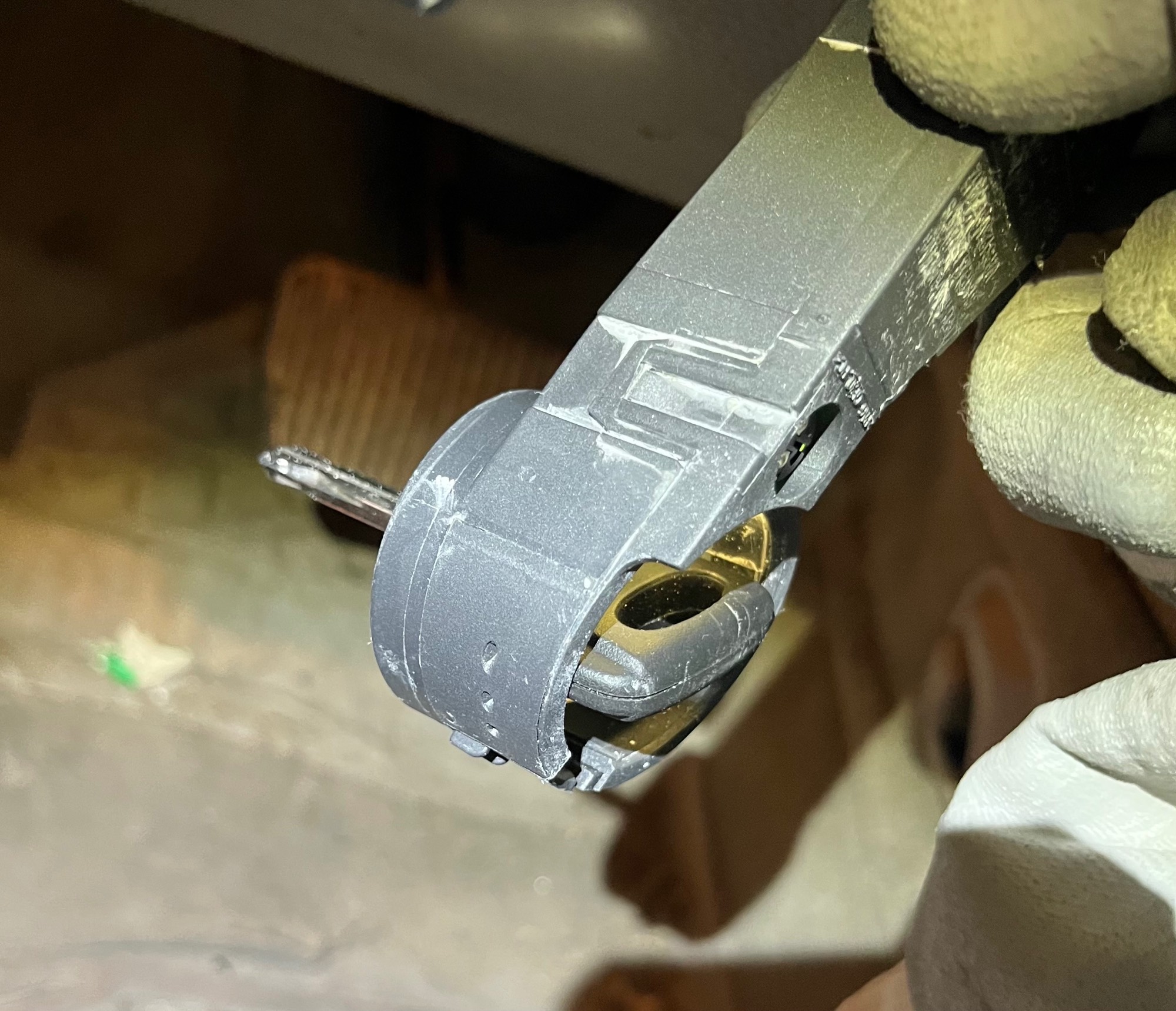

vtl wrote: 20 Jan 2026, 06:56
Krons wrote: 19 Jan 2026, 19:20 A spare key is most painful…covered here on the forum ad nauseam…$440 for a fob or $113 for a valet key PLUS $224 to program either one. With an AirTag on the only functional key I may roll the dice. Just can’t swallow $337 for a spare key on a $1500 vehicle.
Break the ignition lock, so it accepts even a screwdriver. Glue your the only remaining key to immobilizer antenna. This is what I did years ago.
VTL your solution works brilliantly.
Placed my good chip valet key as pictured and duct taped it securely. Shoved the harness and antenna ring back under the column and popped in a eBay replacement ring. $17 for two spare key blanks, $21 at locksmith to cut…problem solved!

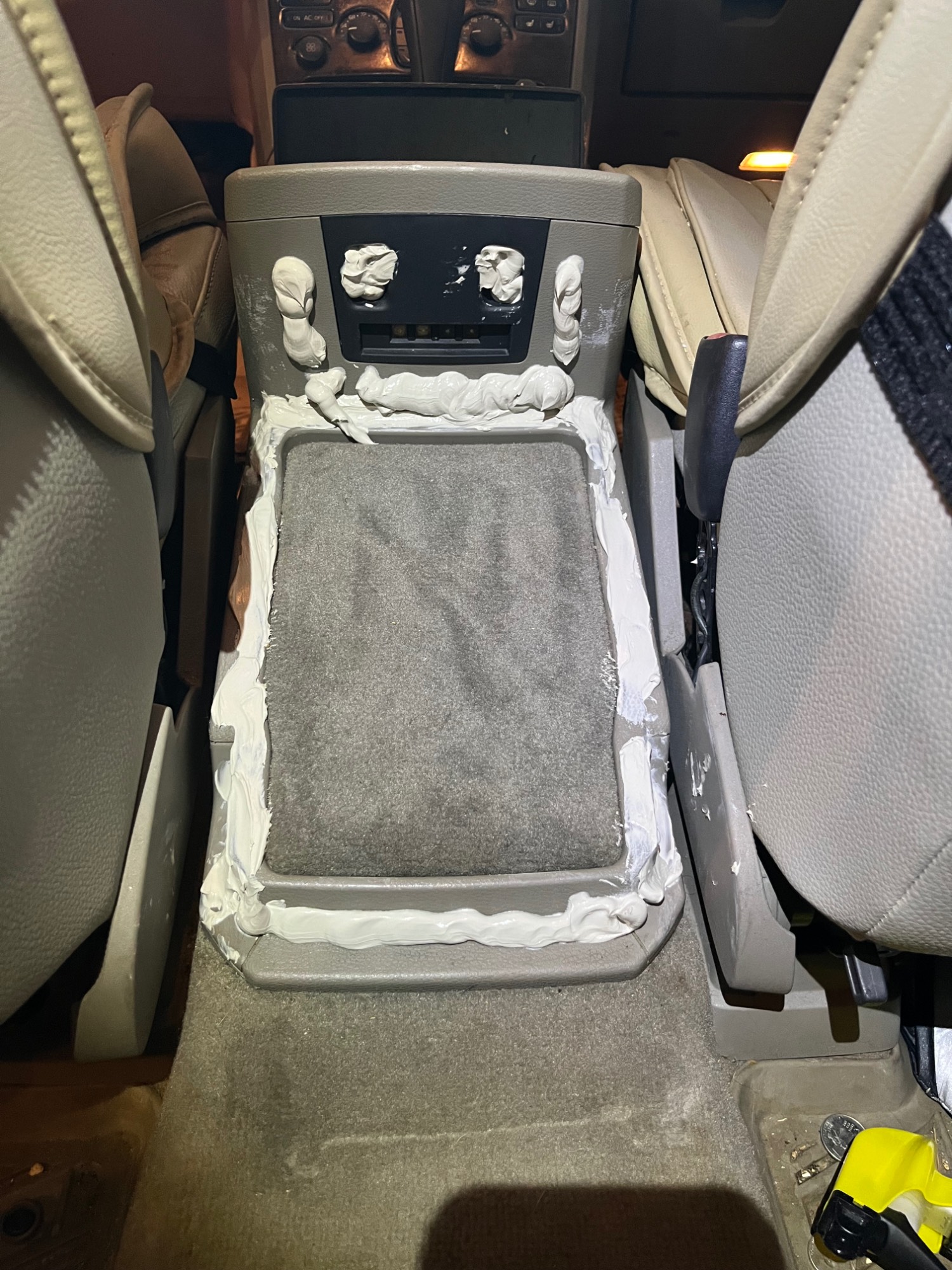

Working through a list of other items on this 05 XC90. Replaced the rear hatch opener mechanism and latch. Opener was rusted like all of them and hatch wouldn’t open due to cable on opener latch being broken. $150 in eBay parts and we are back in business. Opener changed in later models so had to dremel a few areas for clearance but all is good.
Now the real hack job. Center console on these is removable and the latches (like all mid-2000s plastics) known to break. I’ll fix you. Even color matched the caulk—that’s not going anywhere.
Also had to JBWeld the console lid…ugh these plastics.
