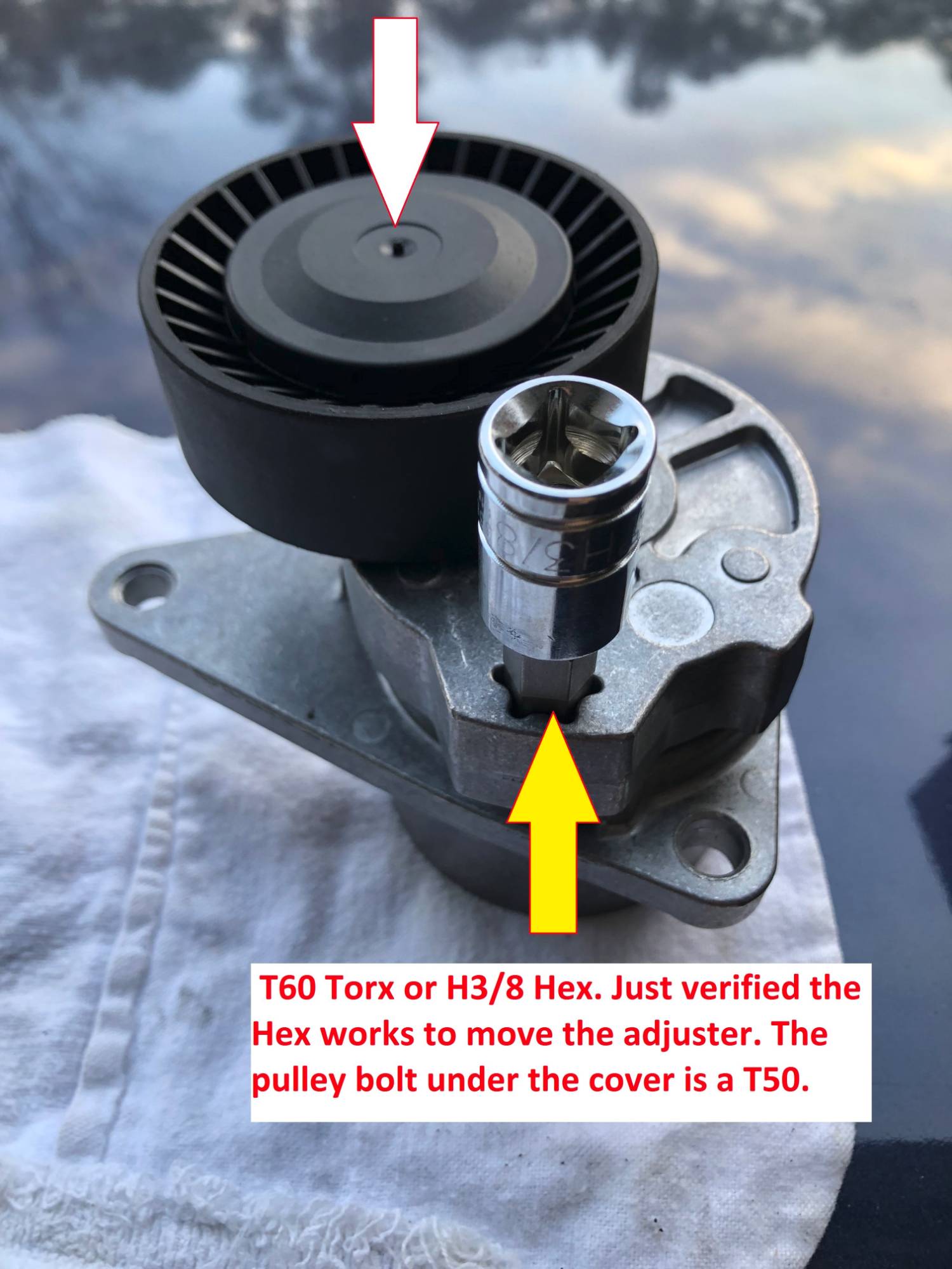

The HB tool looks like it's for other make and model alternators. The serpentine belt tensioner uses a T60 Torx or H3/8 Hex to adjust / release the tensioner / belt with. A T50 is used for the pulley. The alternator has 3 bolts per video but we're suppose to loosen the 2 AC compressor bolt for some reason. Will figure that out when the time comes.

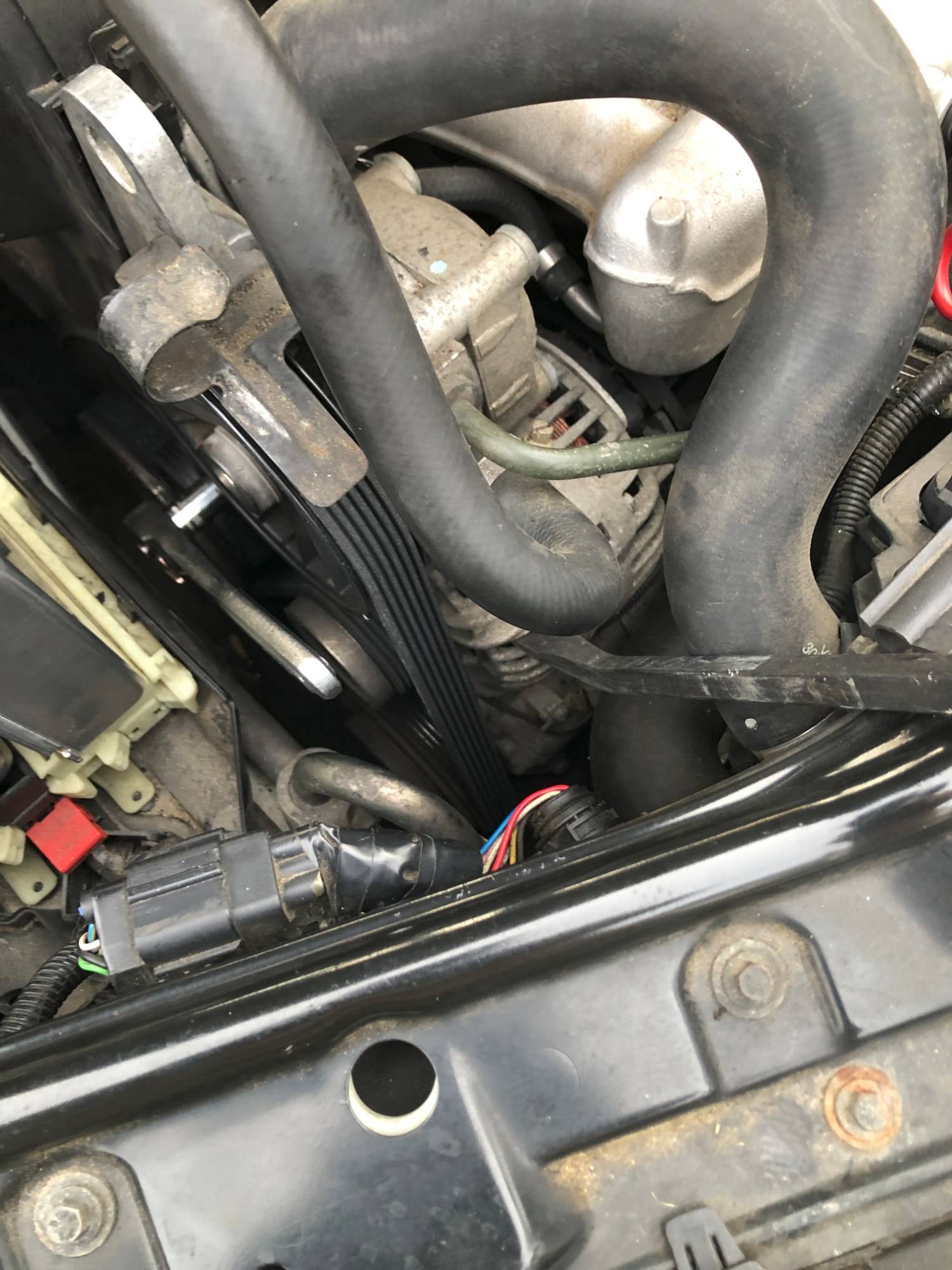

The H3/8 HEX socket worked perfectly but the 3/8 ratchet handle was short so struggled with finding good leverage pushing the tensioner down. The car is quieter though the broken pulley never made any noise to indicate it was failing till the last perhaps 1/2 hour before grenading .
In summary, removing the ECM enclosure and timing cover allowed for replacement from the top. Be sure to move the PWST reservoir together with the hose for more room.

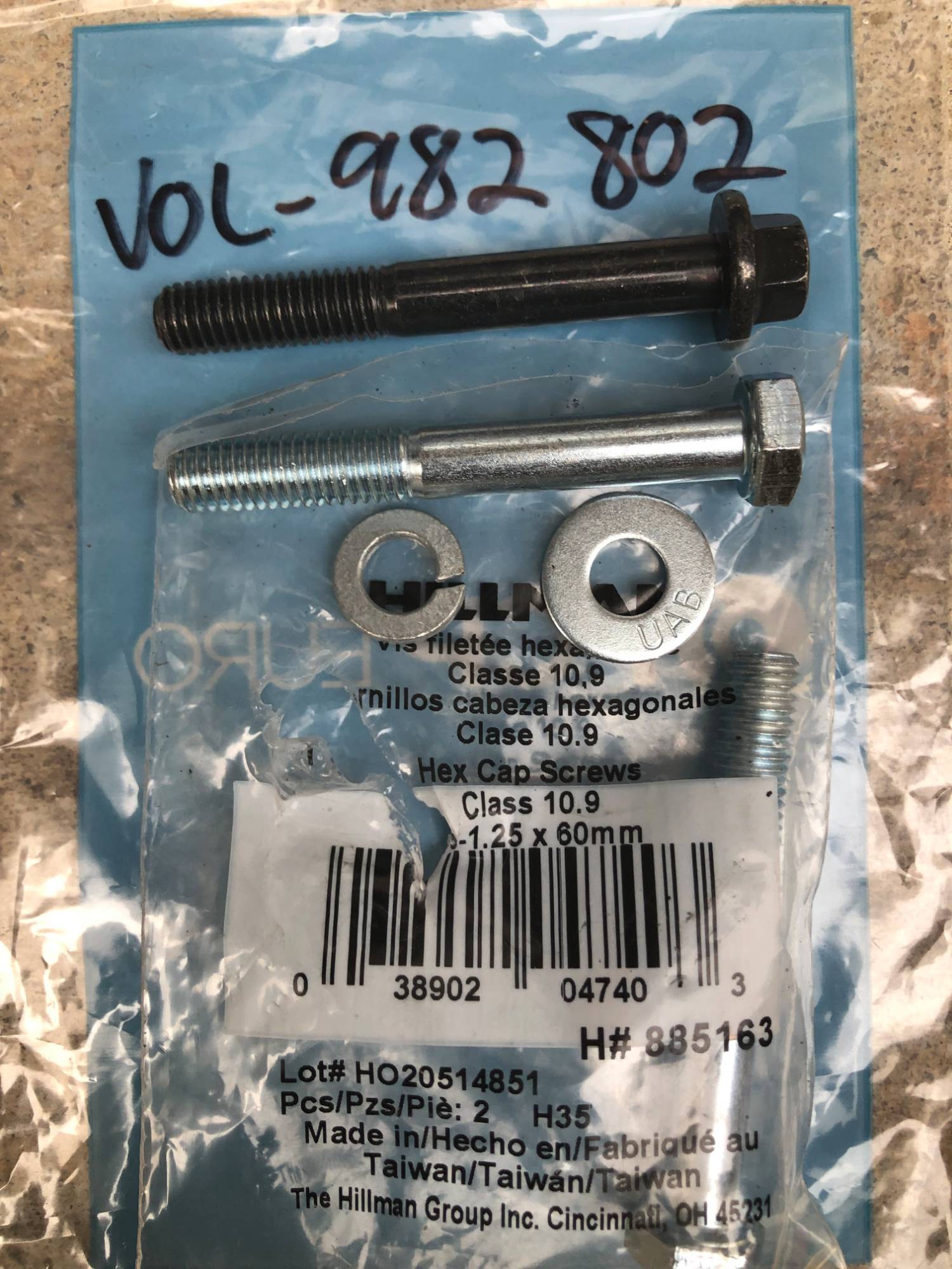

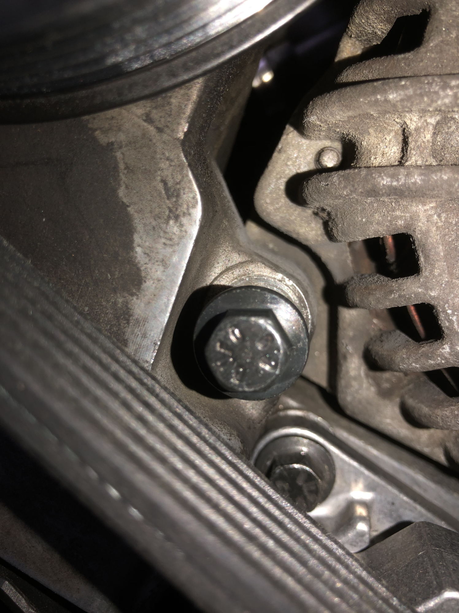

The alternator bolt was missing and driven a year under our ownership. From how dirty the bolt contract surface was it's been missing for sometime. Looking at the description on various parts websites found an equivalent at Lowe's. 2 bolts at half the price of a single on FCP. Was going to install it as a precaution but was too cold last week. Since FCP's order came today decided to install the Volvo OE.
Large pry bar for leverage and went in unhindered.
