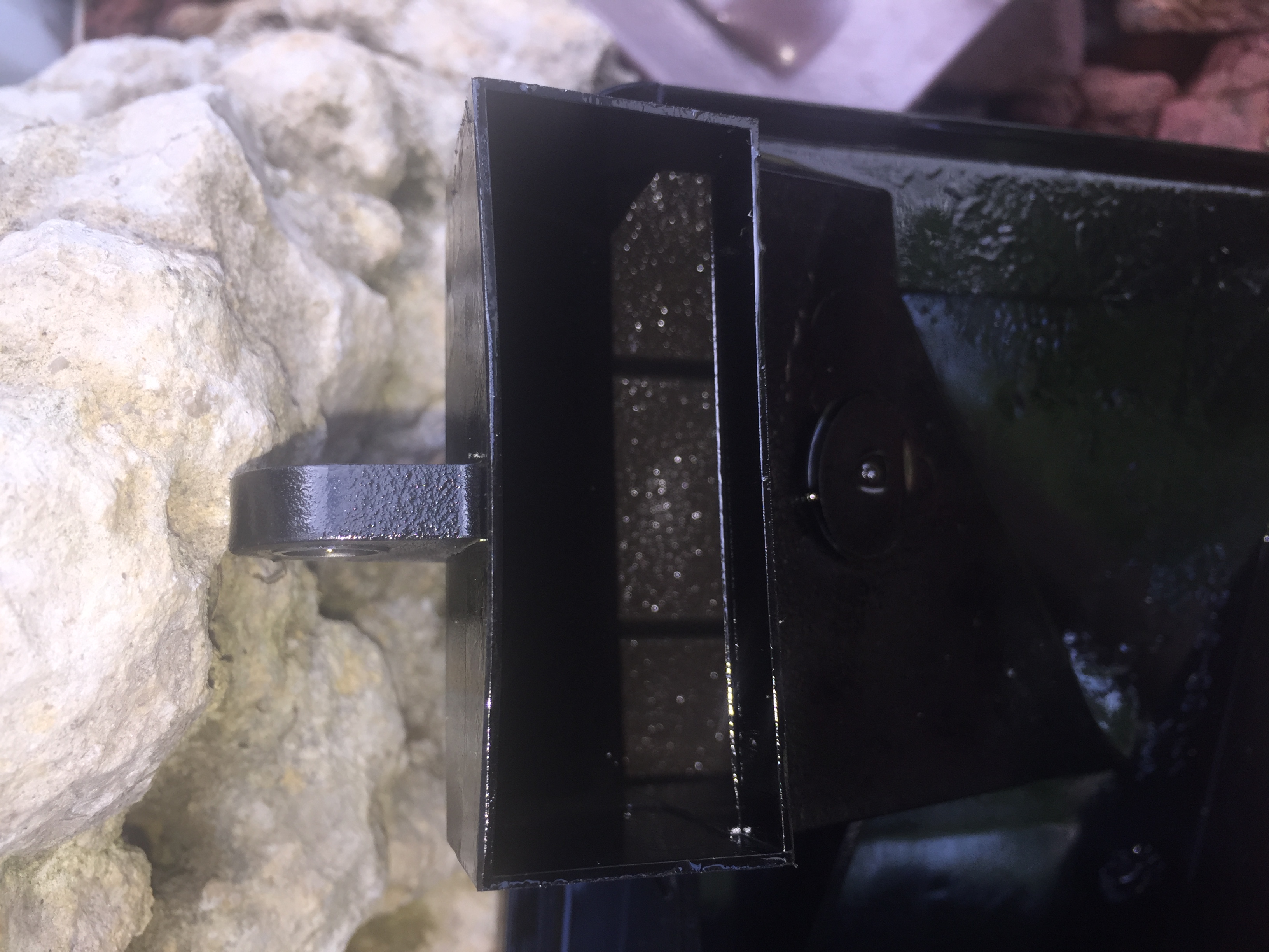

- This is the filter removed from the transmission, completely blocked
- Fouled Filter.JPG (1.58 MiB) Viewed 1372 times

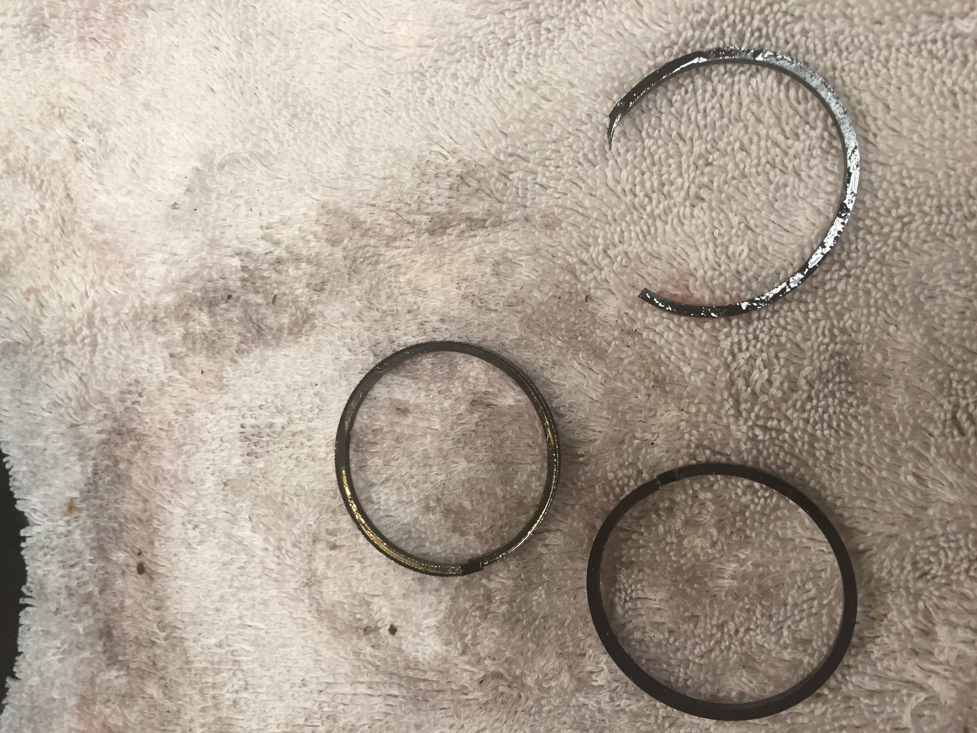

- Teflon seals on back of direct clutch were junked
- Junk Teflon Seals.JPG (2.4 MiB) Viewed 1372 times

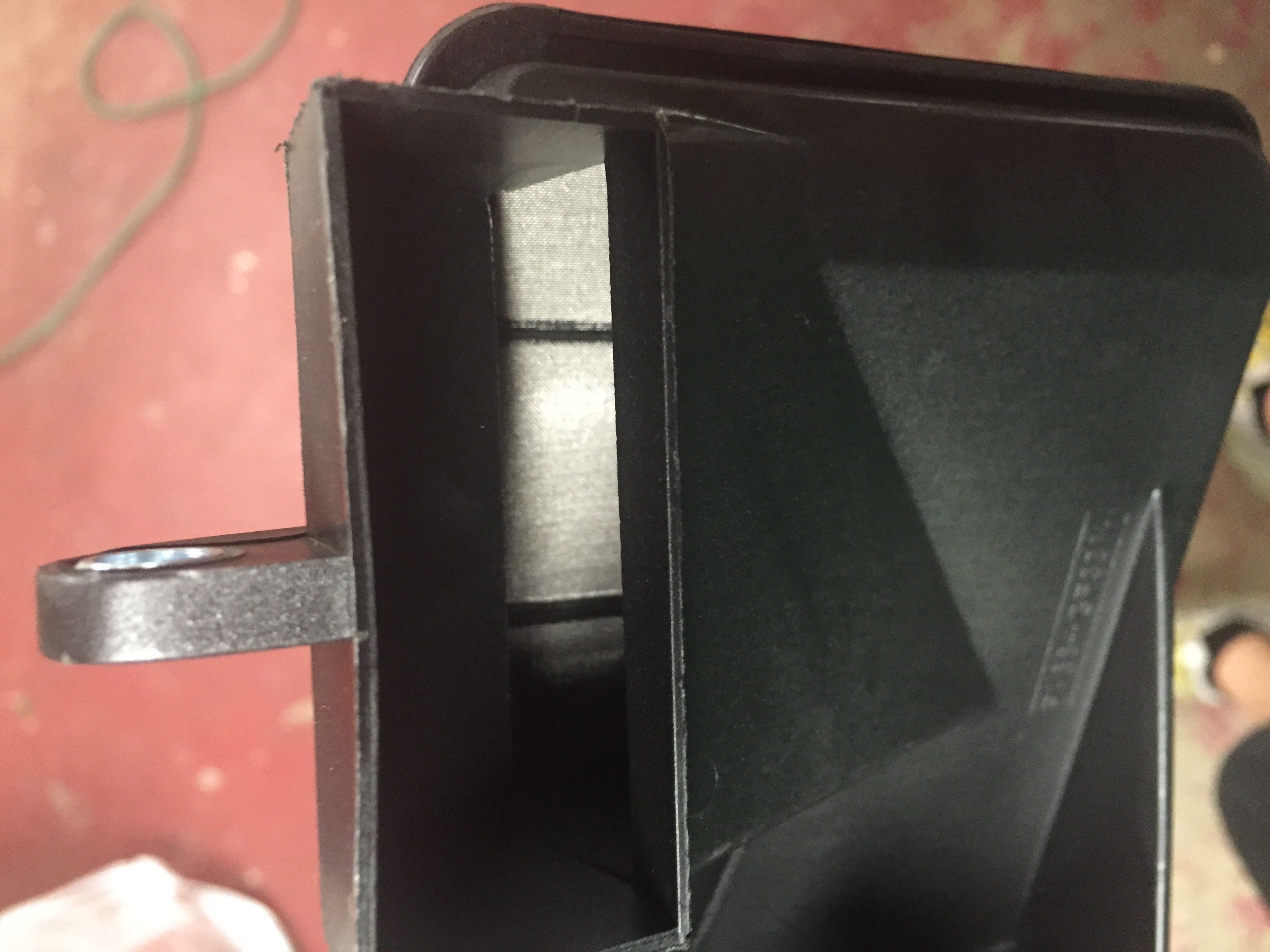

- New, clean filter, as it should look
- New Filter.JPG (1.18 MiB) Viewed 1372 times

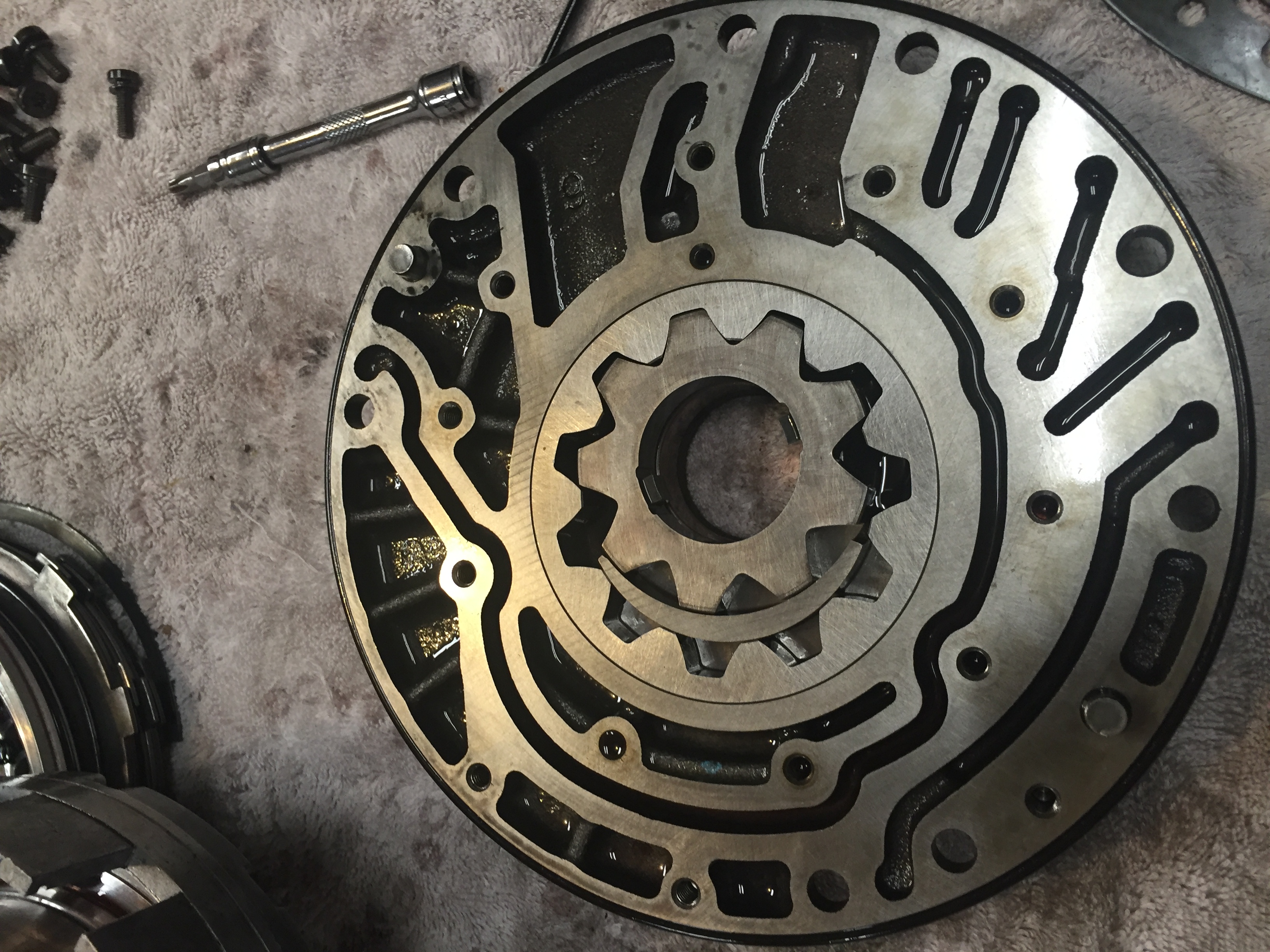

- Internal view of pump showing gear mechanism
- Pump Internals.JPG (2.24 MiB) Viewed 1372 times

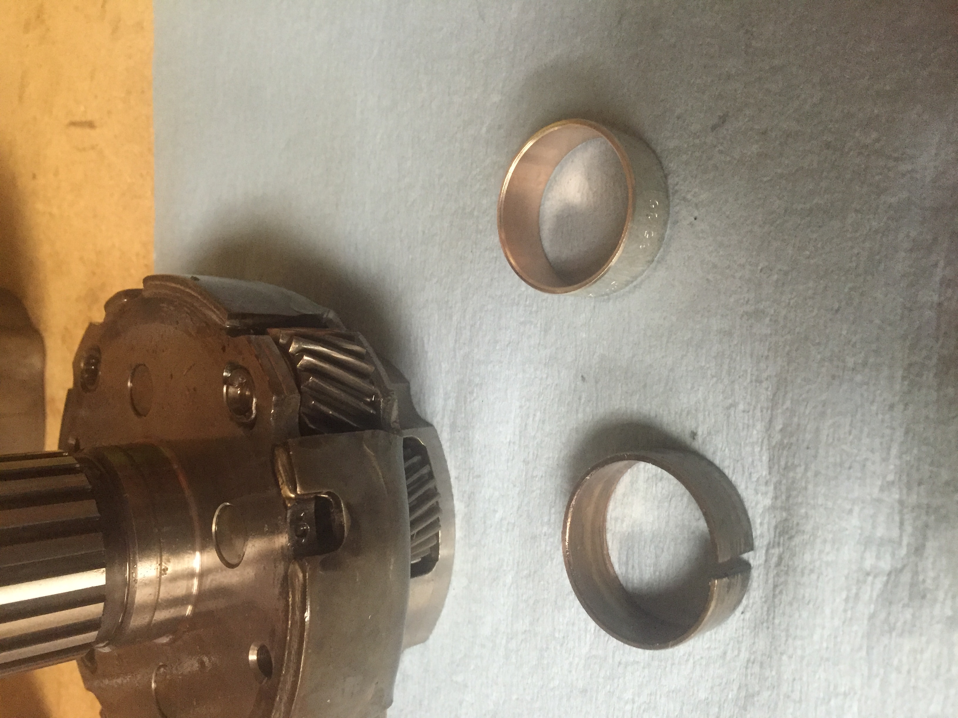

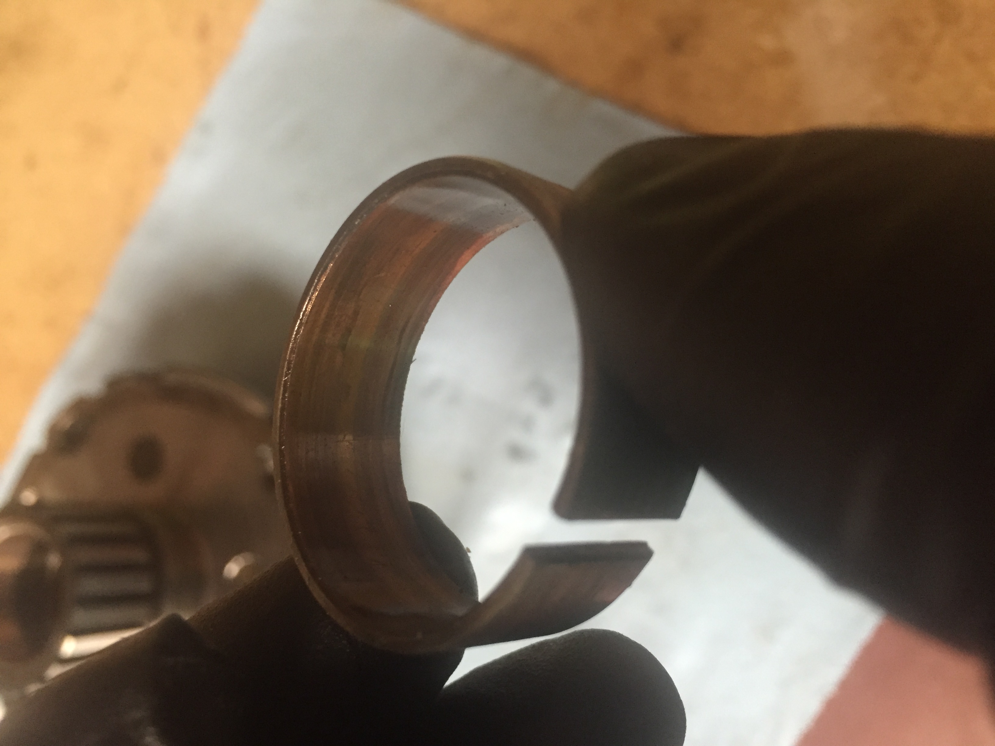

- Bushing on planetary split and loose
- Split Bushing.JPG (926.02 KiB) Viewed 1372 times
- Damaged/split/spun bushings on planetary
- Split Bushings.JPG (1.28 MiB) Viewed 1372 times

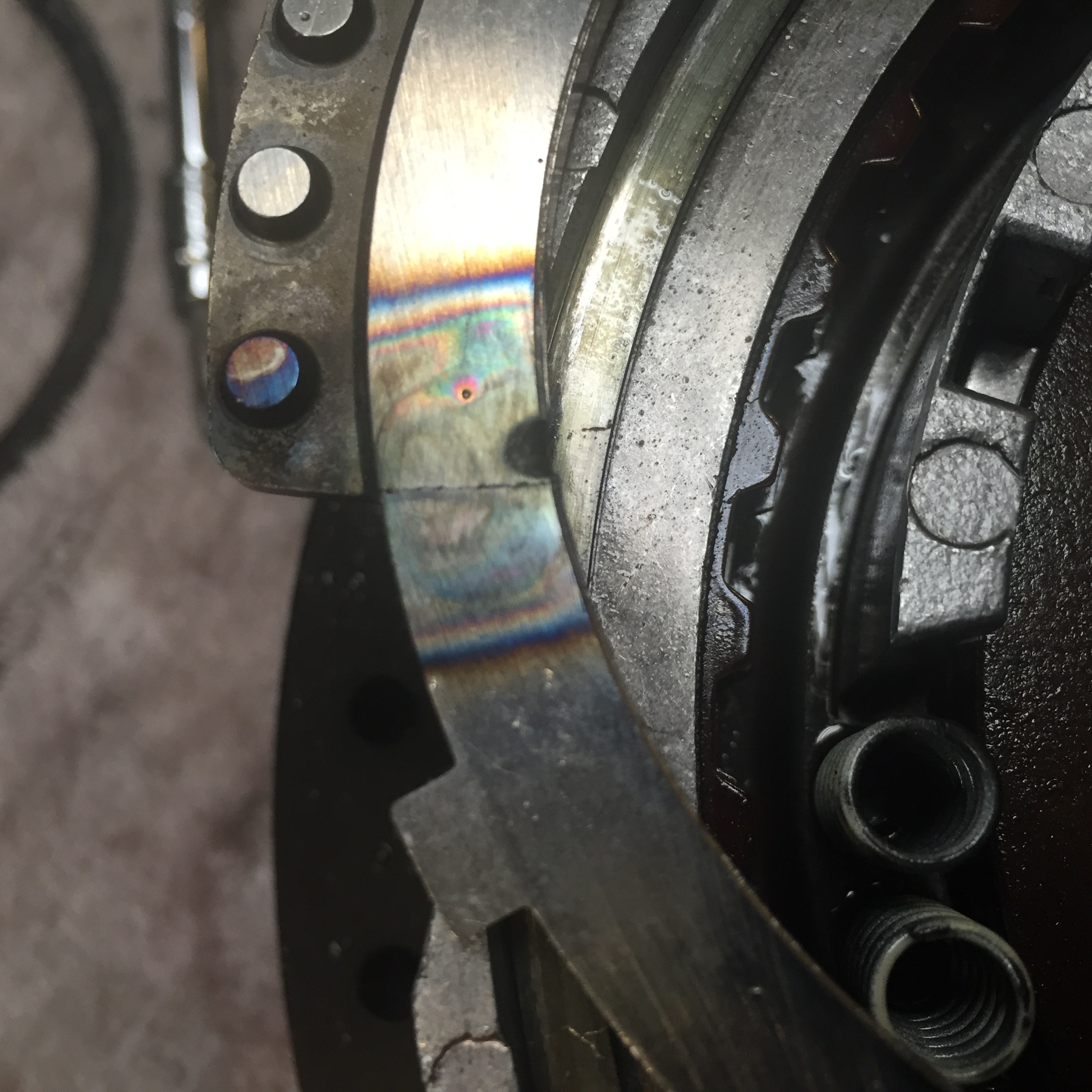

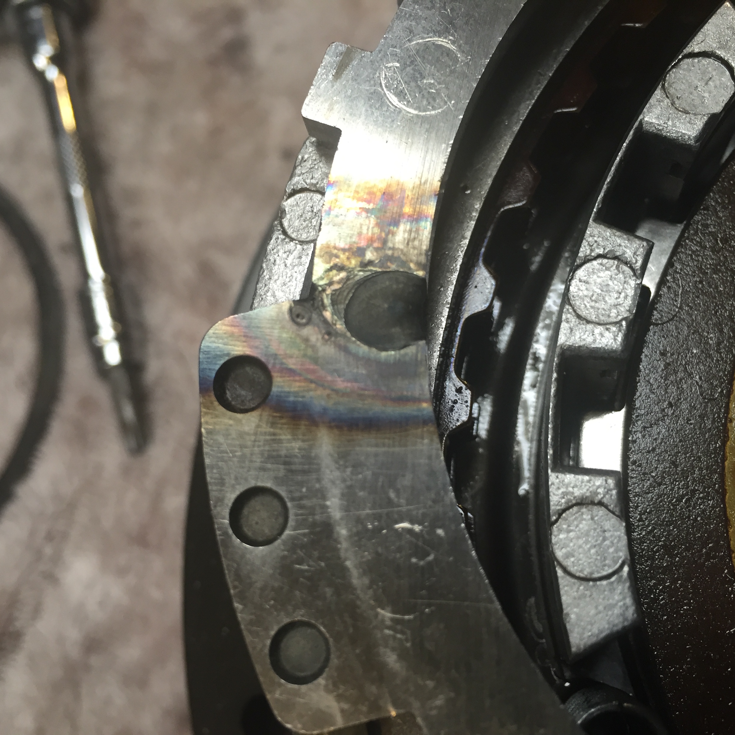

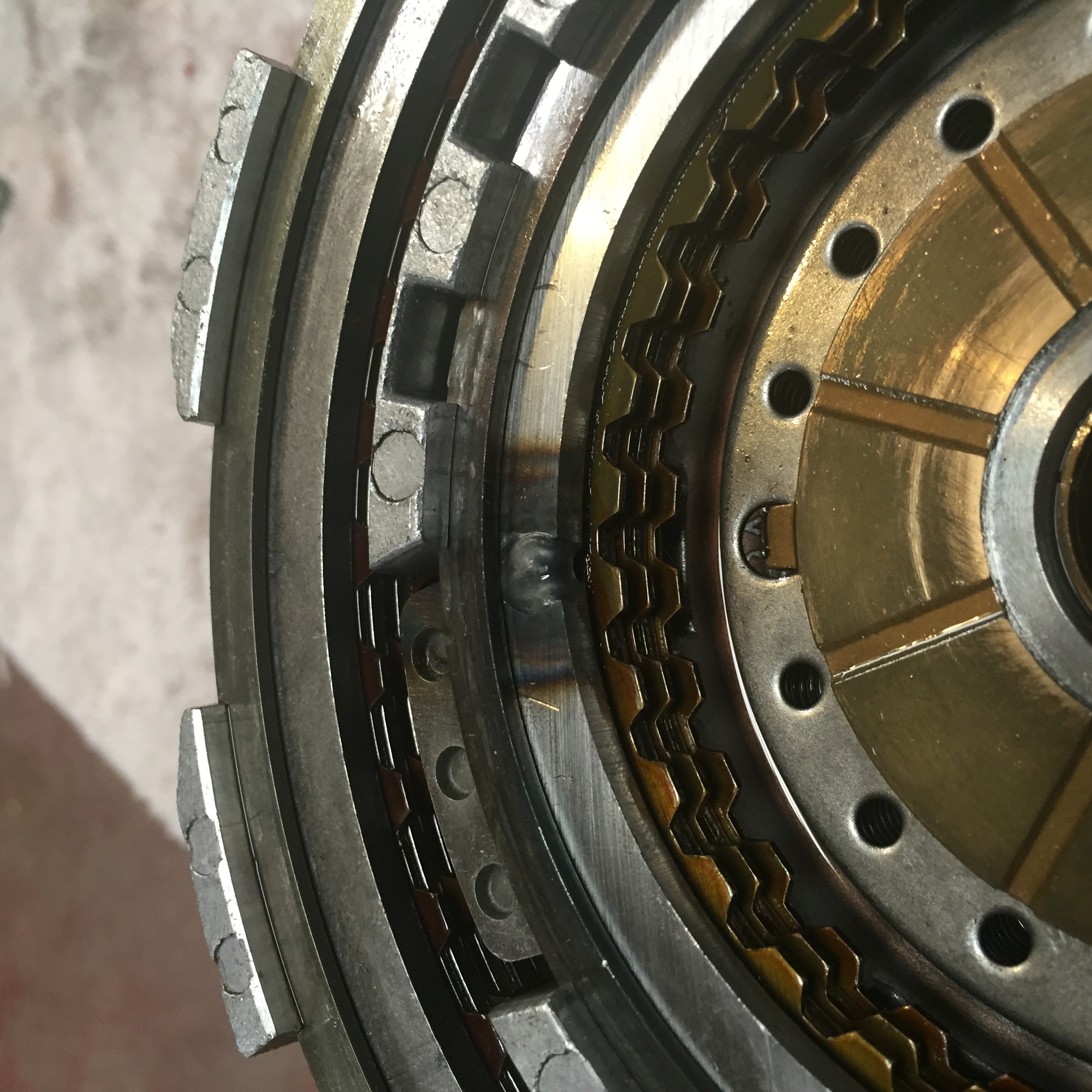

- Picture of weld repair on pressure plate (B2 Clutch)
- Welded Pressure Plate 1.JPG (1.39 MiB) Viewed 1372 times
- Cracked pressure plate was TIG welded on back side (B2 Clutch)
- Welded Pressure Plate 2.JPG (1.43 MiB) Viewed 1372 times
- This is the pressure plate after repair and installation (B2 Clutch)
- Welded Pressure Plate Installed.JPG (1.51 MiB) Viewed 1372 times

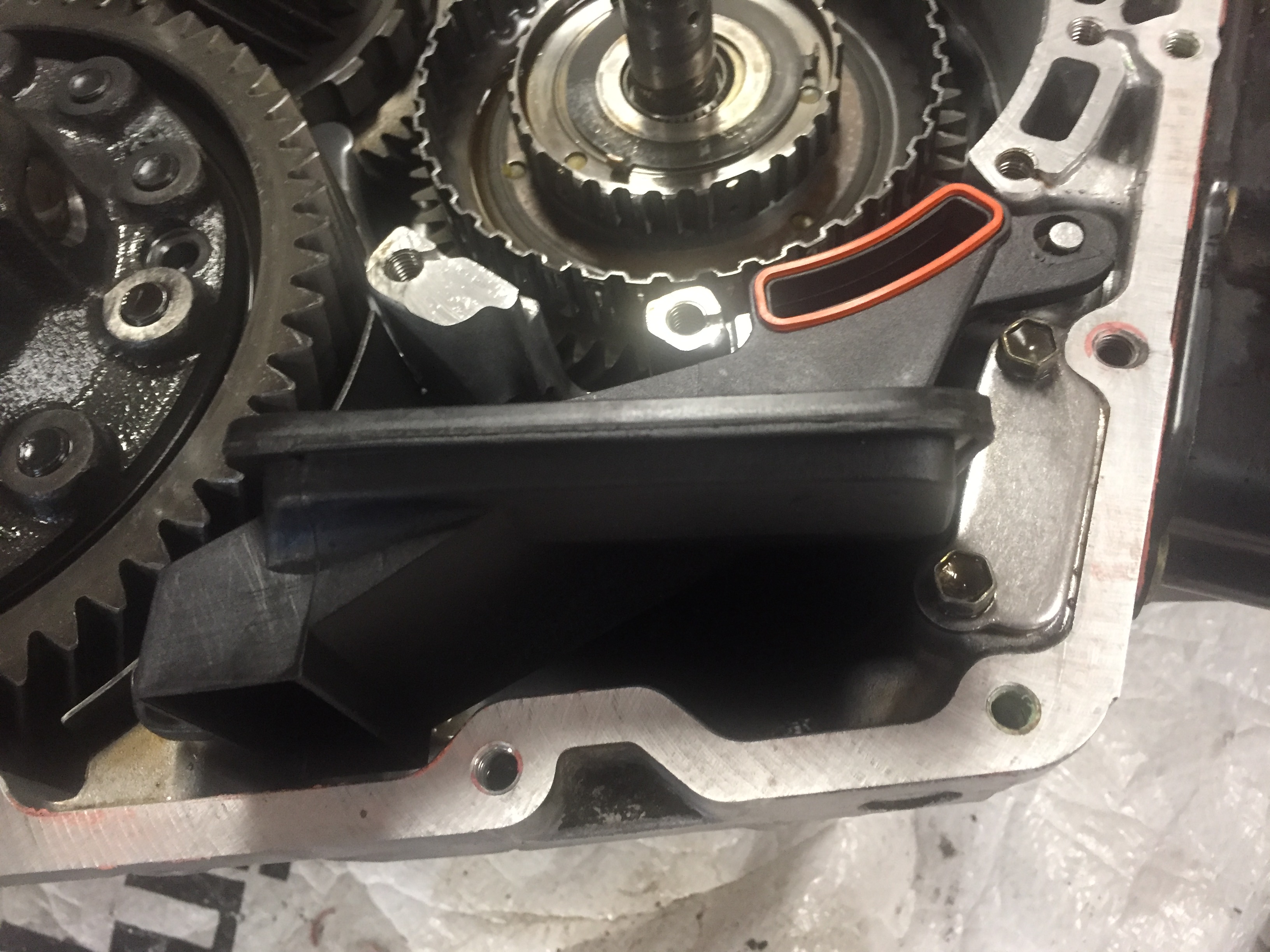

- New filter installed, ready for reassembly
- New Filter installed.JPG (1.26 MiB) Viewed 1323 times

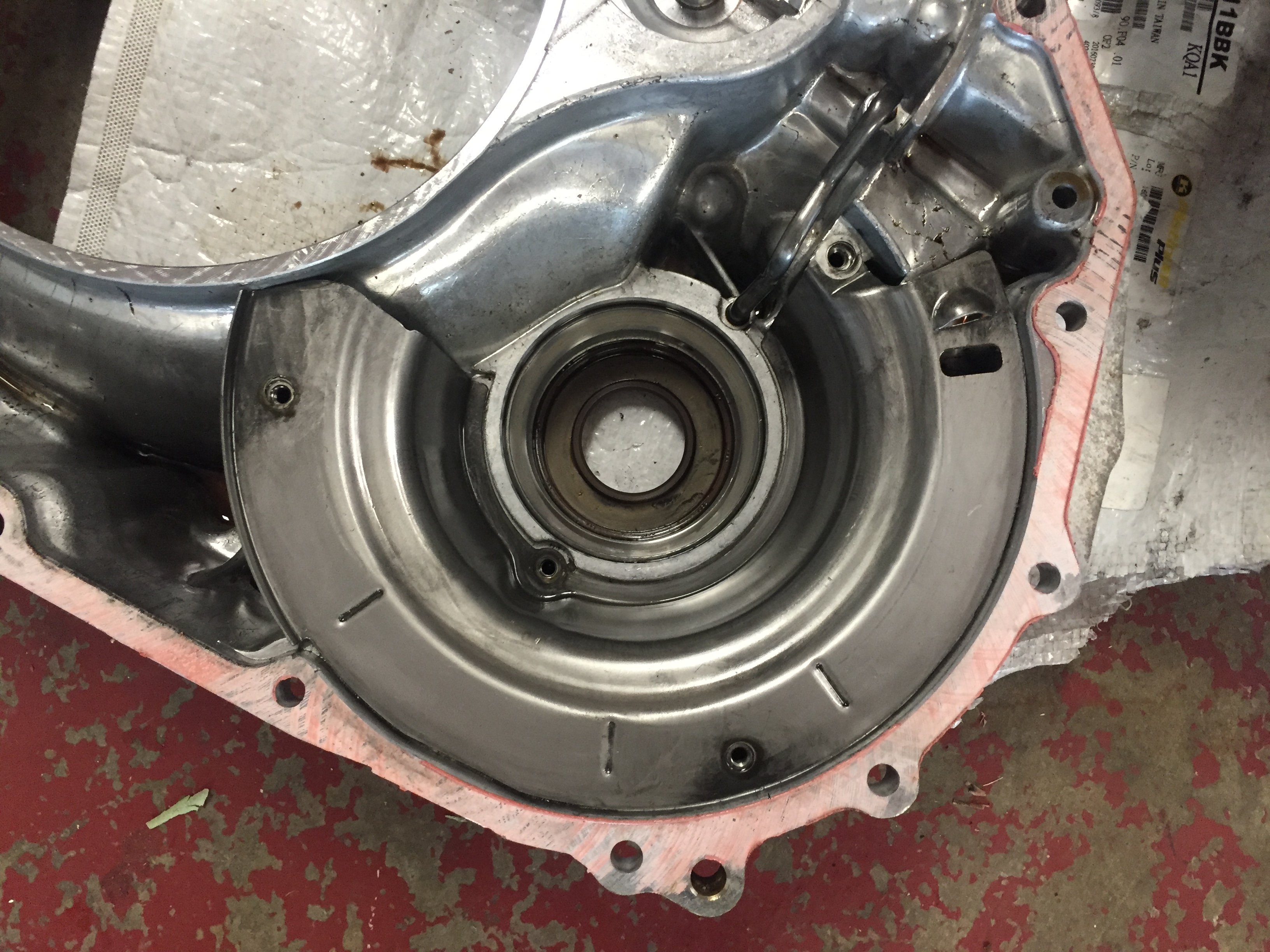

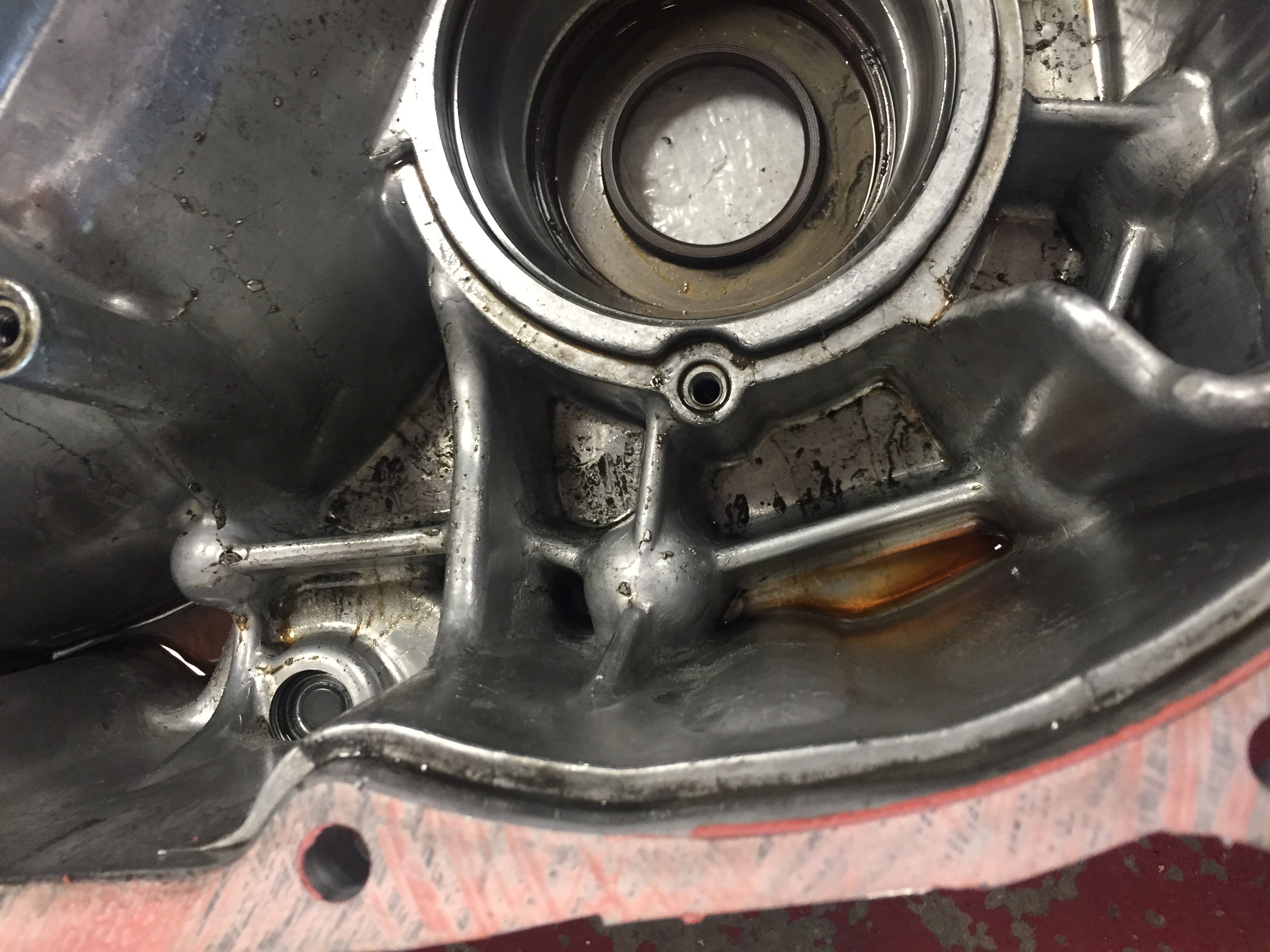

- Bellhousing sump, splash guard and magnets removed
- Bellhousing, splash guard removed.JPG (1.39 MiB) Viewed 1323 times
- Bellhousing side, looks pretty clean
- Splash Guard in Bellhousing.JPG (2.13 MiB) Viewed 1323 times

Also, as for the filter, that lower section is the pickup. The red ring is a silicone gasket that seals the filter intake to the pump housing inlet.
100% of flow into the pump goes through that filter.
