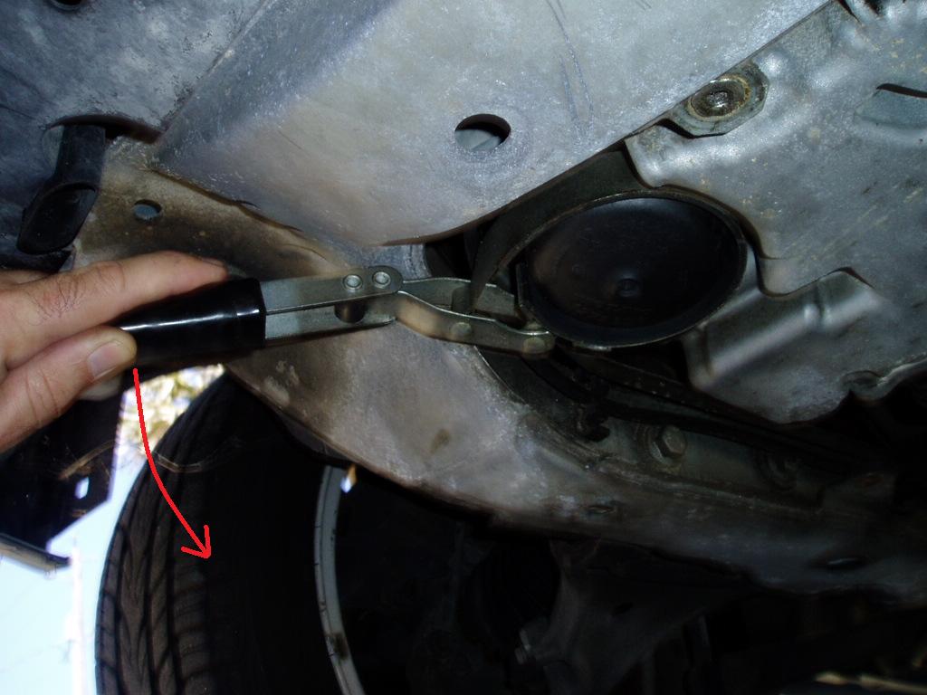

The next pic shows the oil filter cover and the dished-out area in the subframe that allows you to use a conventional spin-on filter wrench:
Drain Plug Showing Crush Washer and Magnetic Tip.jpg (84.37 KiB) Viewed 15959 times
Use the oil filter wrench to loosen the cover by turning counterclockwise:
Oil Filter Cover and Subframe Dish Locations.jpg (103.13 KiB) Viewed 15997 times
NOTE: If you can't loosen the cover with the conventional wrench, buy the special Volvo tool, available here: http://www.fcpgroton.com/product-exec/p ... ory_id/136 or here: http://www.eeuroparts.com/Main/PartDetail.aspx?id=A261
DO NOT drive a screwdriver through the cover to remove it - you will be buying a new cover for $15 and your car will be down until it arrives: http://www.eeuroparts.com/Main/PartDeta ... id=1275808
Move the drain pan under the filter cover and unscrew the cover the rest of the way by hand. Hold onto it and turn it upside down over the drain pan to drain the remaining oil out of it. Pull the filter out of the cover.

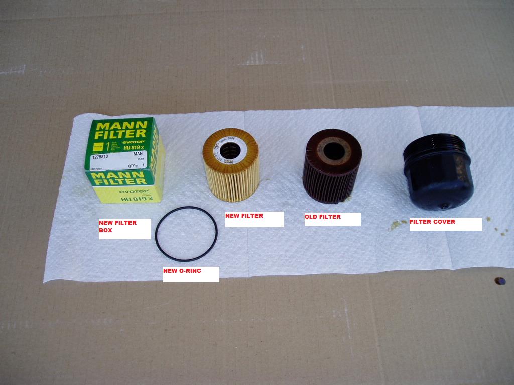

Here is a pic showing the new filter and o-ring, old filter and filter cover:
Use the Filter Wrench to Loosen the Cover by Turning it Counterclockwise.jpg
Use the Filter Wrench to Loosen the Cover by Turning it Counterclockwise.jpg (93.67 KiB) Viewed 16133 times

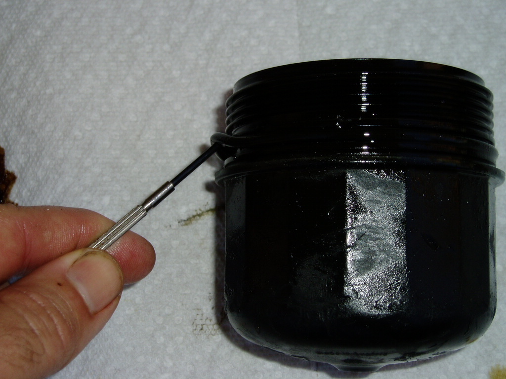

Now use the small screwdriver to pry the old o-ring up and out of its groove:
Old vs. New Filter Comparison.jpg (93.63 KiB) Viewed 15957 times

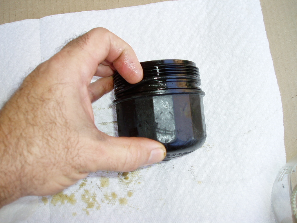

Roll the o-ring up and off of the cover and remove it:
Roll the new o-ring onto the cover and down into its groove:

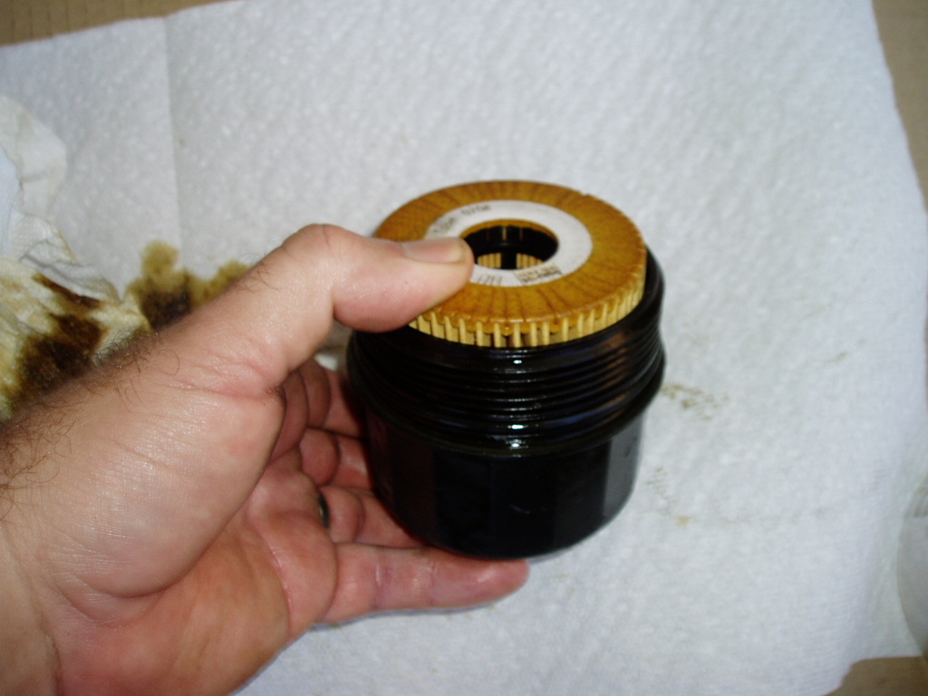

Use the paper towels or rags to wipe out the inside of the cover. Make sure you remove any gunk that may have accumulated at the bottom. Now take the new filter and place it into the cover. Push it down until it slides over the center post in the bottom of the cover:
If you worry about having oil pressure the maximum amount of the time, pour some oil into the cover while holding it upright. Now slide back under the car and screw the cover back into place. The cover says to torque it to 25 N-m (19 ft-lb), which is fine if you have a torque wrench, but if not just tighten it with the wrench until it is screwed in as far as it will go. The o-ring makes the seal, so you only need enough torque to keep the cover from unscrewing. Also, it takes some torque to force the filter over the center post up in the engine. Make sure you get it in far enough that the o-ring is engaged in the housing or you will have a major league leak.

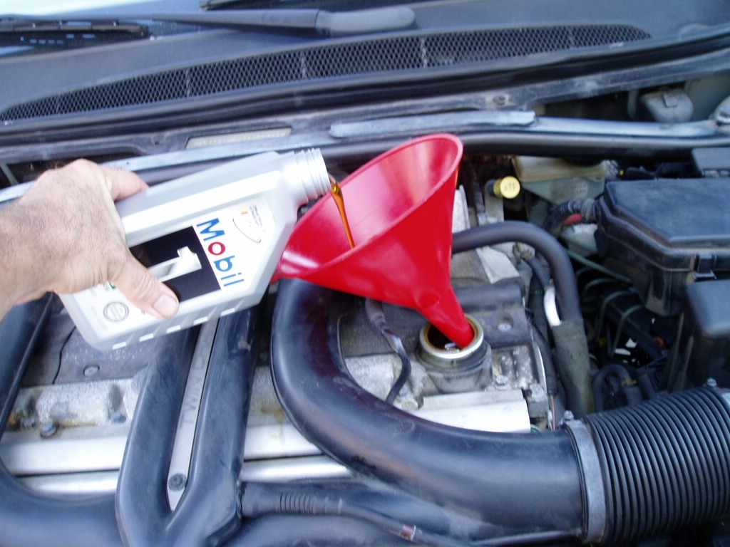

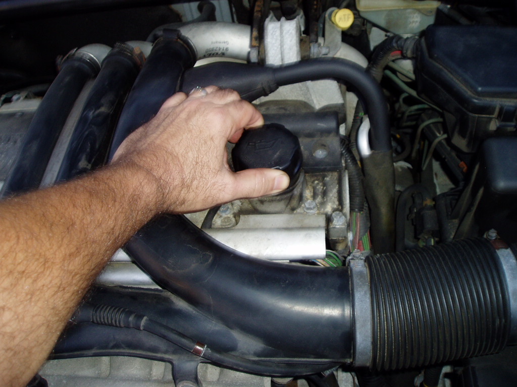

Open the hood and remove the oil filler cap:
Insert the funnel and add the appropriate amount of high-quality oil (I like the full-synthetics like Mobil 1 and Castrol Edge) per your owner's manual (for my T6, 7 quarts). If you added oil to the filter cover before you put it on, make sure you account for that. I usually add about 1/2 quart less than specified, then check the level after I run the engine and top-up as needed.

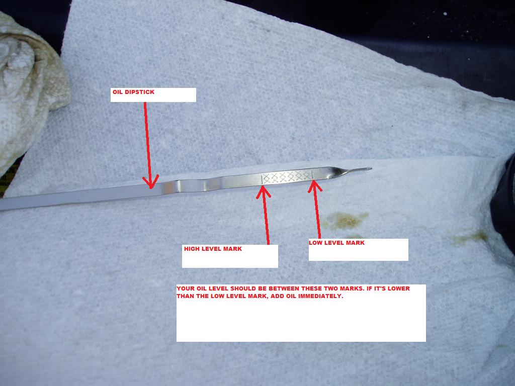

Pull the oil dipstick out to check the level. Wipe the end of the dipstick off, then reinsert it into the tube and pull it back out to get an accurate reading.
The oil level should be between the two lines on the end of the dipstick:
Oil Dipstick Level Marks.jpg (98.23 KiB) Viewed 15964 times
