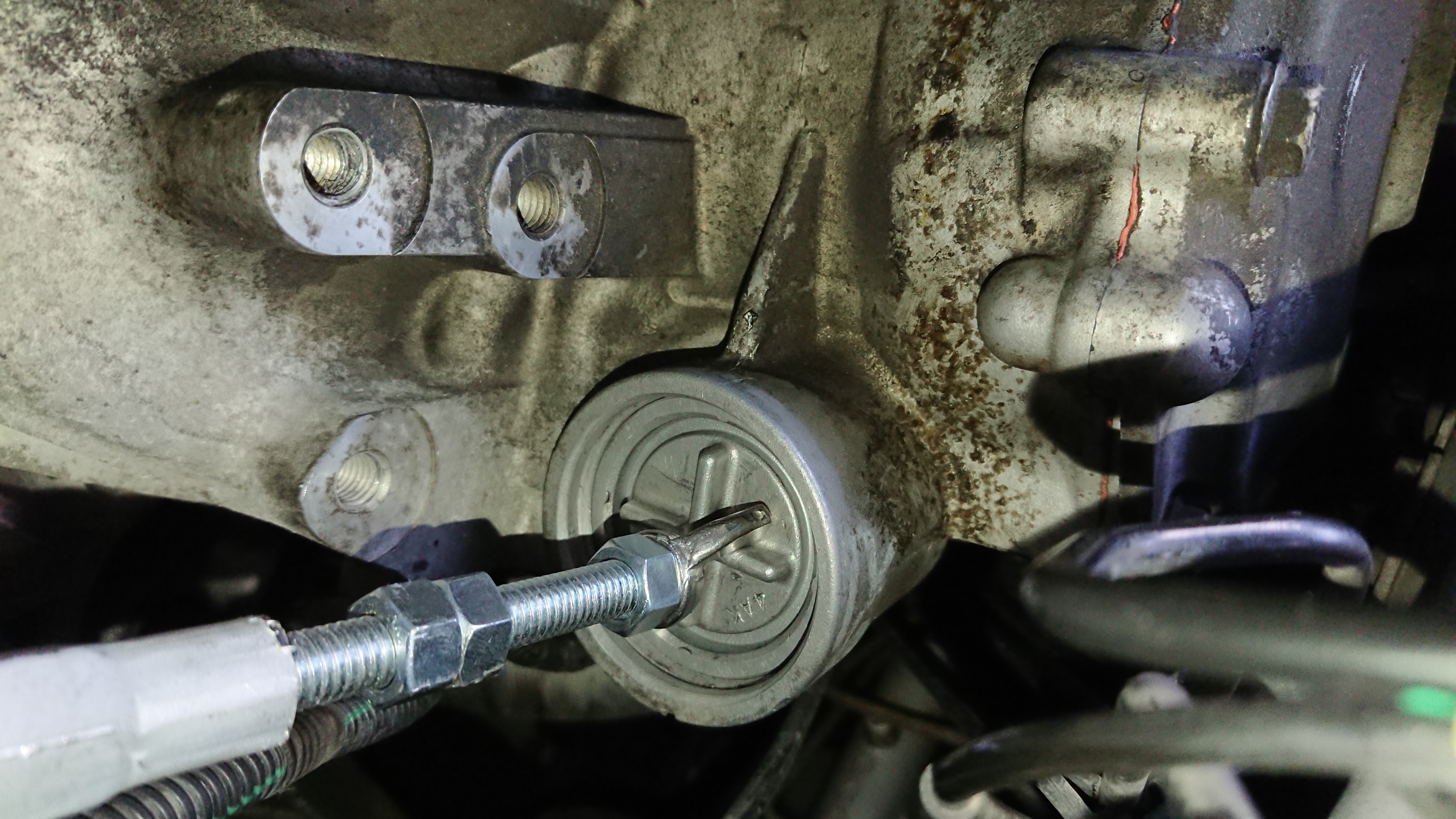

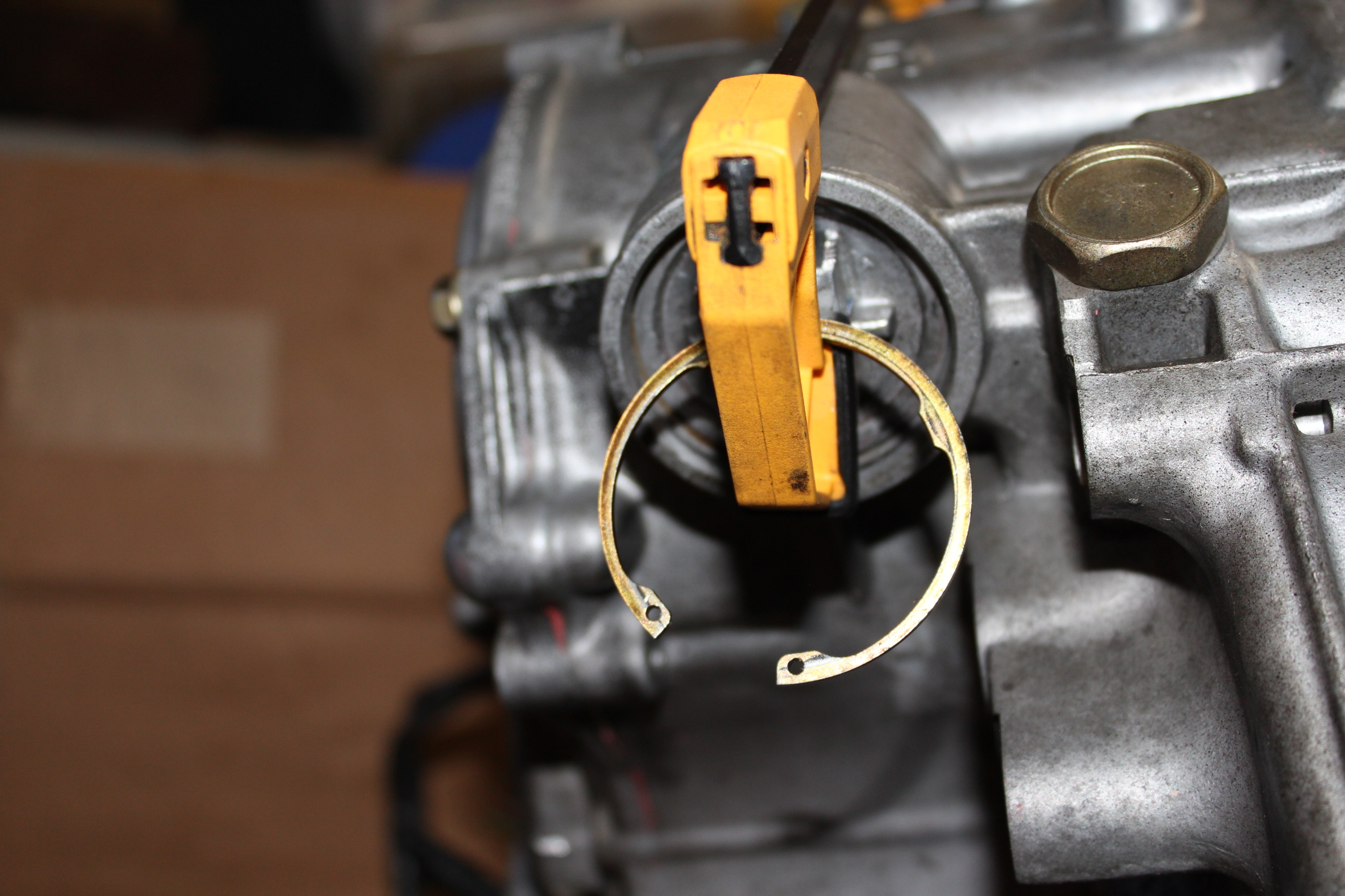

1) Get a GOOD set of snap ring pliers, I used Lisle 49200, get from Amazon for $22 (USA) or Princess Auto (Canada). Removing old ring required a creative use of tool - had to attack at an odd angle due to all stuff in way, so using that tool for example let me put the two sides at different lengths so I could attack at an angle:
2) Put some bubble wrap or cloth down, as the plunger might pop right out as mine did. If you plan on taking skid pad off (recommended, makes it easier as can slip a big screwdriver in to compress plunger) do this AFTER taking plunger out, since there is less space to fall this way. Remember when re-installing plunger that it might fall out again so keep lots of bubble wrap and cardboard around at all times:
3) As described in linked guide, remove old cover and possibly plunger. Install new O-Rings on new cover, and replace O-Ring on plunger if required. To remove O-Ring use something sharp (dental pick) to carefully 'skewer' it - don't damange O-Ring seat!
4) I tried using top hole for bolt originally, but couldn't get snap ring in easily by myself. If you built little jig with perpendicular bolt which would compress plunger this would have worked great. Ended up stripping top bolt hole, stuff in the way made very difficult to correctly tighten this bolt I found anyway. An idea I had: you could use a small (1" or 2") C-Clamp pushed against that bolt to tighten the B4 Cover. I didn't have a small C-Clamp so use a larger one pushing against lower down in the frame:
5) I Ended up using bottom-rear bolt hole to do this, as shown in the linked guide. It is out of way and easier to tighten bolt into (can fit socket onto bolt). Remember you are only tightening into transmission (aluminum) so don't overdo it, use torque wrench if you are a newbie like me. I used big screwdriver to compress spring, and then a 4" C-Clamp which I cut the little handle off, which could be adjusted to hold the plunger in a compressed state. Now at your leisure put the snap ring in. Don't worry if you haven't compressed plunger enough - you just want the snap ring to at least be sitting above the groove:
6) Once snap ring was mostly in, I used screwdriver to further compress plunger so snap ring would go into groove.
My cover was of old design but not defective, transmission serial was 01J, Car is 2002 S60 112K miles. So ended up replacing for 'preventative' reasons I guess. Shifting was same as before, presumably in other cars transmission is trying to adapt to broken cover so needs to learn how to shift again properly with fixed cover. In my case nothing to re-learn I assume...
Hope my method is useful to someone! I found it a lot easier to have a way fo first compressing the cover and holding it shut, then working the snap ring it.

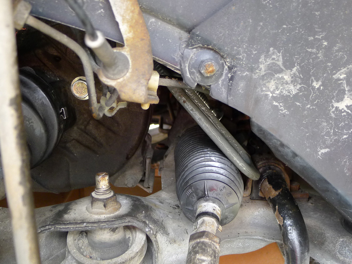

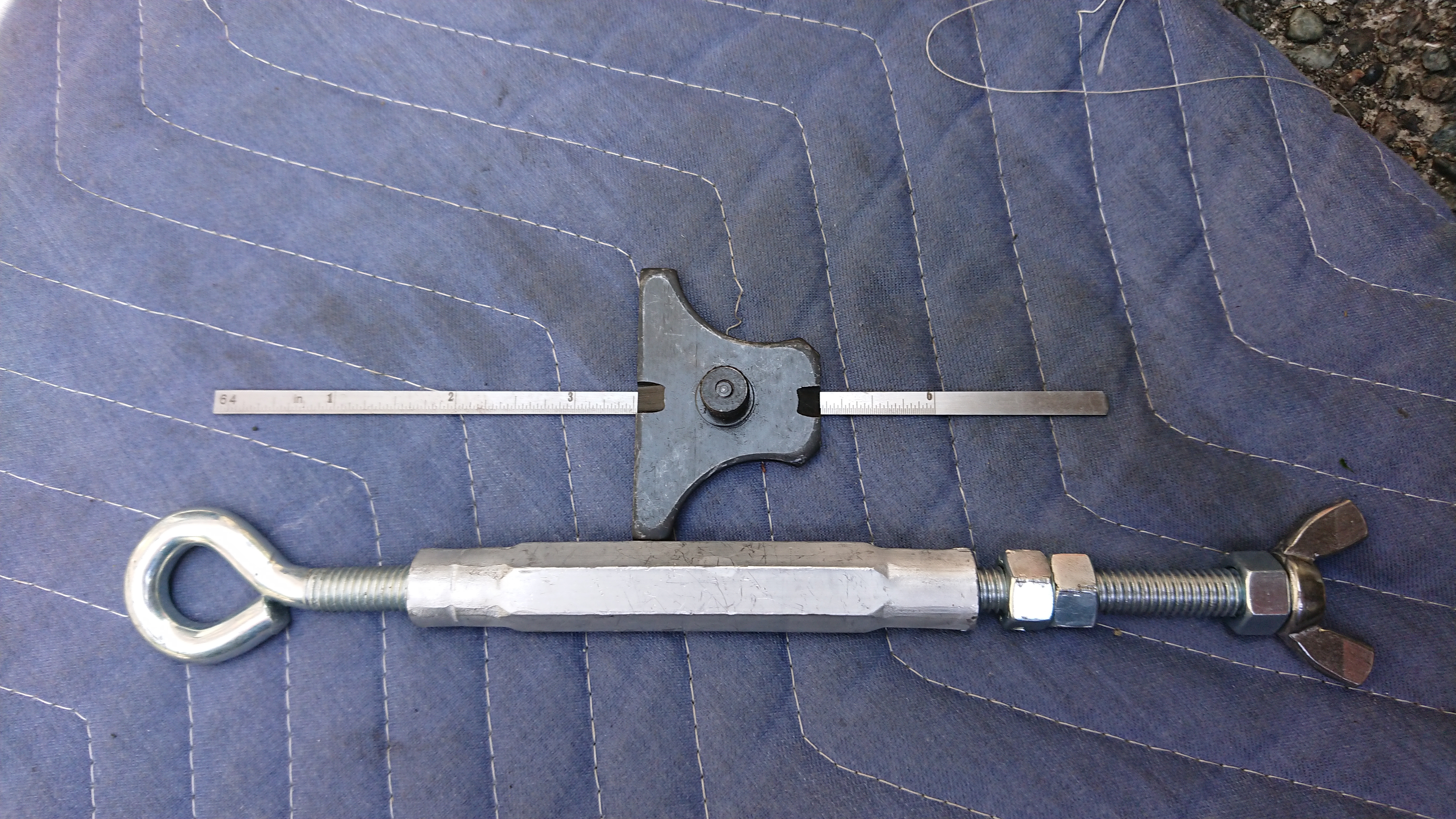

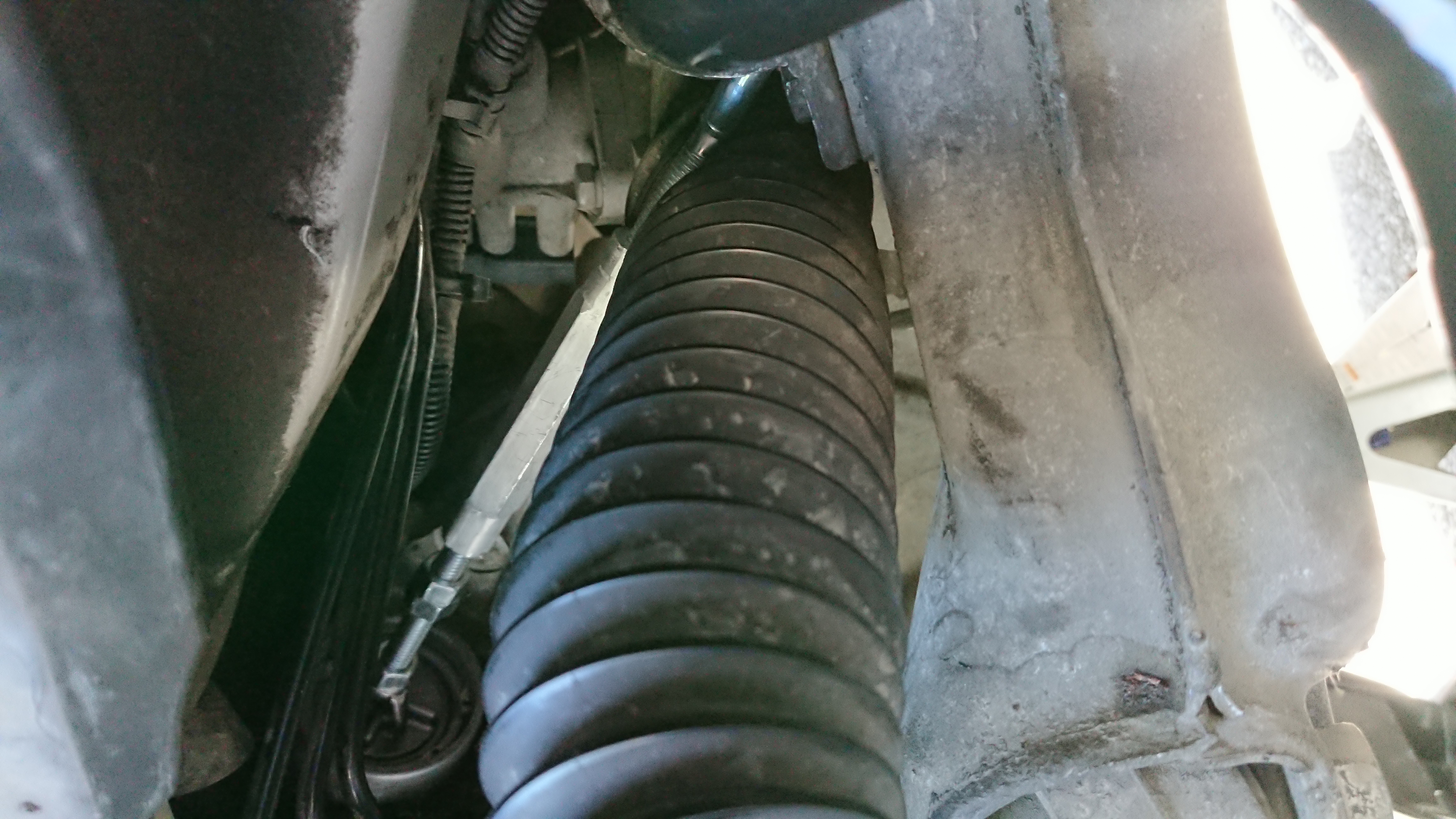

This post was helpful to me, so I want to share my own tips.
I could not hold the cover in place with enough force AND get the snap ring back in place. We tried a few other methods online but nothing would work.
So I first tested with a depth gage to make sure the pin could go in far enough. I made contact with the band at about 80mm. With a long Philips I pushed it (similar to how the pin would) and got about 13mm of easy play before the bands stopped it, so far so good.
Then I went to the hardware store and got the following:
1. A 6 inch tubular turnbuckle with eye bolts
2. A 5 inch threaded rod to replace the right hand thread eyebolt, in my case 3/8x16.
3. Three nuts for same
4. A hardened wing nut for the rod.
About USD$11 total.
I replaced the eyebolt with the rod, then locked the wing nut on the end of the rod, to go around the big + on the cap and keep the rod centered.
I spun the other two nuts on the rod and ran the bolt into the turnbuckle as far as I could and then locked the two nuts together. This was so I could hold the rod with one wrench while using another in the turnbuckle. Wound up not needing this feature.
I put the whole thing in after the cover, putting the far end over the steering bar and jammed it into the sway bar clamp.
Then I just turned the turnbuckle carefully and drove it in until I got serious resistance. I was about 1mm beyond the snap ring groove.
For snap ring pliers, I used a cheap set from Harbor Freight with changeable tips, using the 45° set. I used pliers to bend the tips a bit inward to hold the ring better.
The trick with the pliers was to go in from the midline of the car, not from the wheel area. This way I could use both hands to place the ring, and it went in easily.
Hope this helps

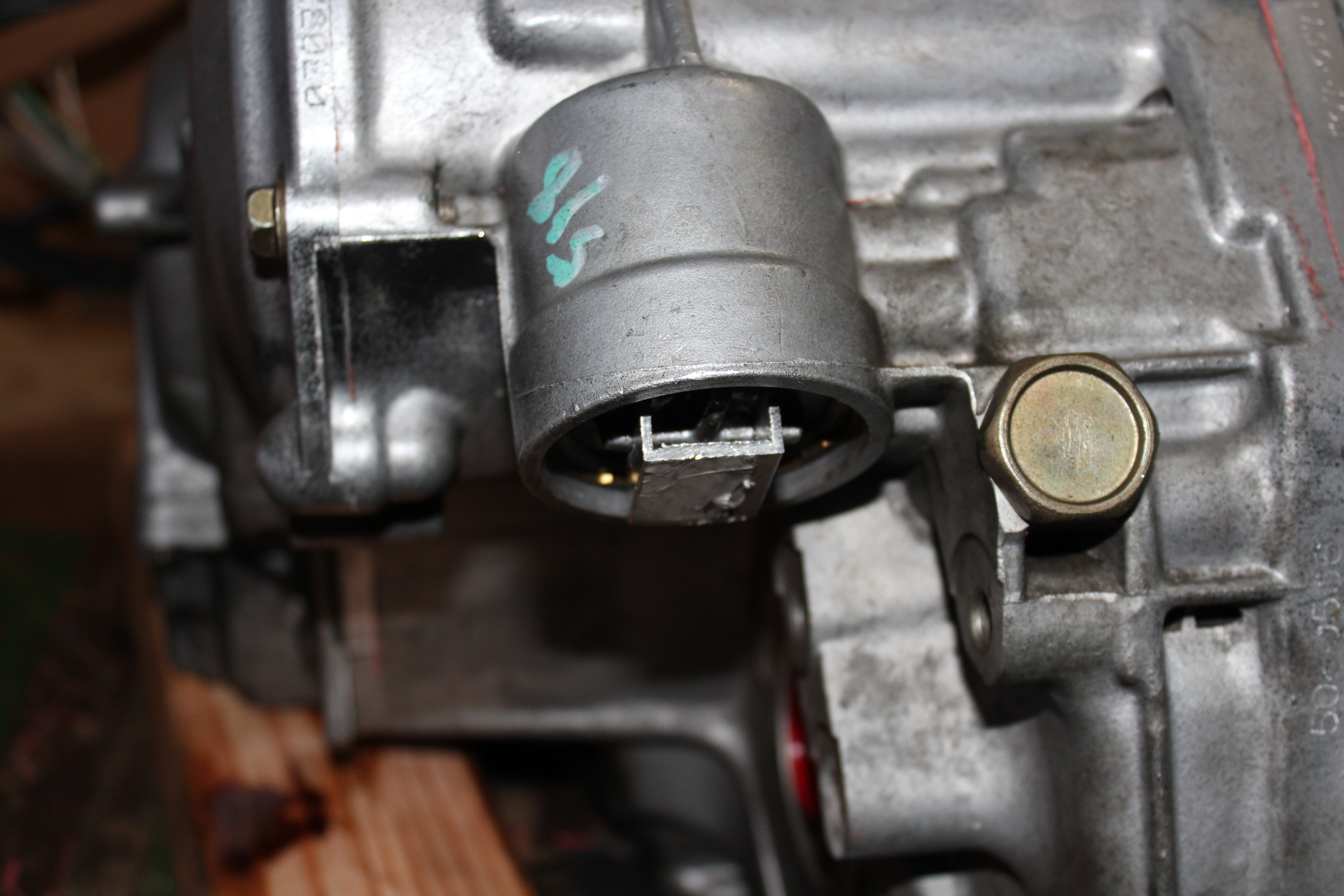

Here's how I did this job recently. Used a 16 inch bar clamp and although the photo shown is with the transmission out of the car the bar clamp can be used in the same position with the transmission in the car you just need to remove the airbox for better access. You'll notice I epoxied a small aluminum channel spacer piece to the servo cover. This made it an easier one person job, the attached spacer meant I just inserted the cover and to hold in place prior to clamping I used a wooden round rod cut to length and wedge in between the car subframe area and the cover to hold it (sorry no photo). With the wood dowel holding the cover in place you can go to the engine bay, install the clamp and compress.chykov wrote: 22 Oct 2020, 11:29 Thanks for all the great information everyone. I am going to attempt this on my daughters 2004 s60. Lets hope all of your great information leads to a successful result.
After clamping the cover with the bar clamp the cover may not be fully seated you may need to tap on the cover to fully seat. Also found it easier to install the snap ring but getting one of the ends inserted in the groove and compressing the ring using just one of tips of the snap ring pliers. The snap ring pliers I had just wouldn't work that well compressing the snap ring using both tips.
