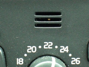

Sometimes fluff accumulates behind the grill where is located the cabin temperature sensor. This is the small grill that you see on the front panel of the climate control. Take your shop-vac and vaccum the fluff behind the opening.
The sensing device may be fouled by the debris (the clear pin head under the grill). Some had reported success with this method.
Other than this, you can have the car scanned by VIDA to see if you have fault codes. Also software updates may be available at the dealer.

Thanks DGM,
There is at least two more persons that knows what that vent is for!
