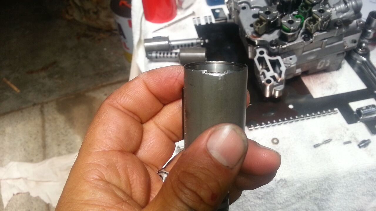

Also removing the endcaps was challenging until I ground off a 6mm section to help lift the old cap off.
A Dremmel tool would be ideal for this.

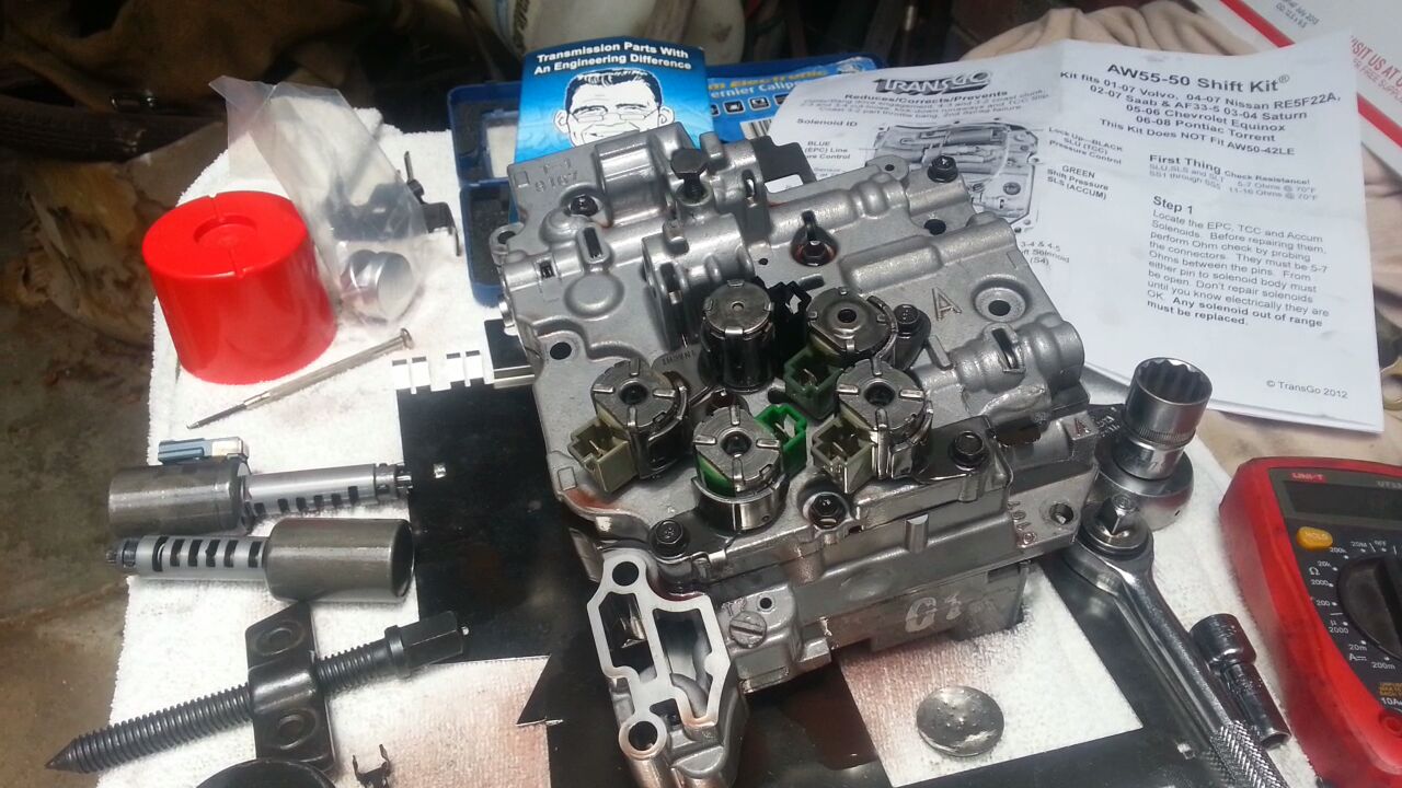

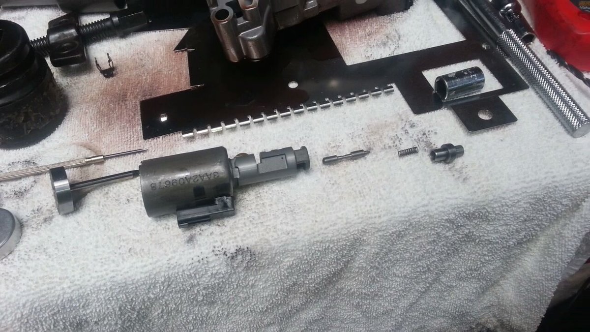

I checked all the solenoid's tolerances as per the included instructions which were very comprehensive and detailed. I went with the reamer kit and gasket set as sold by eBay seller ctppowertrain. Matching valve body gaskets to the body was difficult and requires a lot of concentration as the kit arrives with all possible gaskets included.

To make the procedure a little more understandable I thought I'd throw up the Transgo install guide which without would have been a needle in a haystack.
